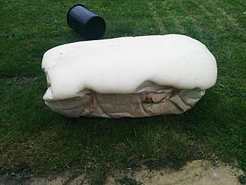

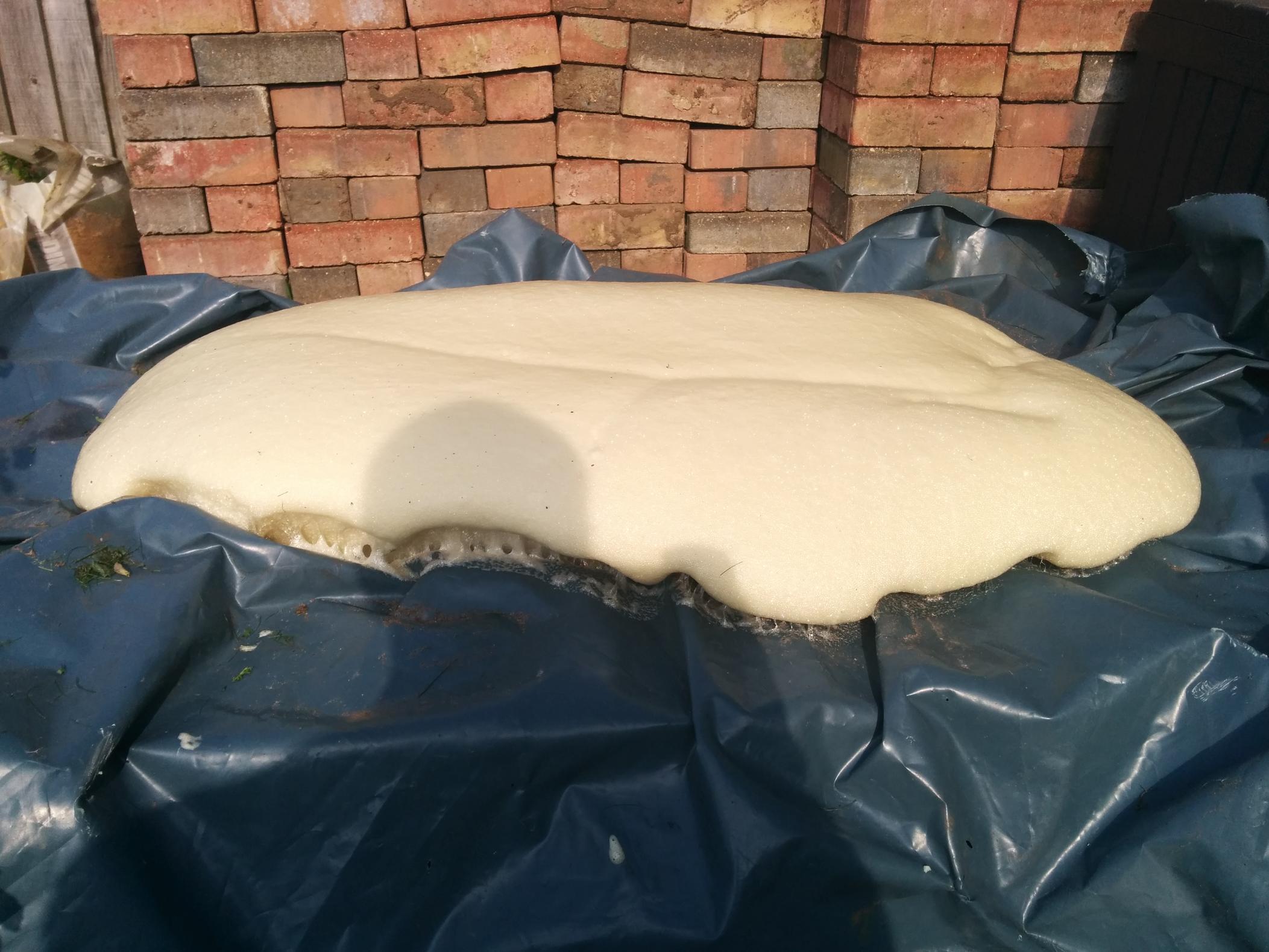

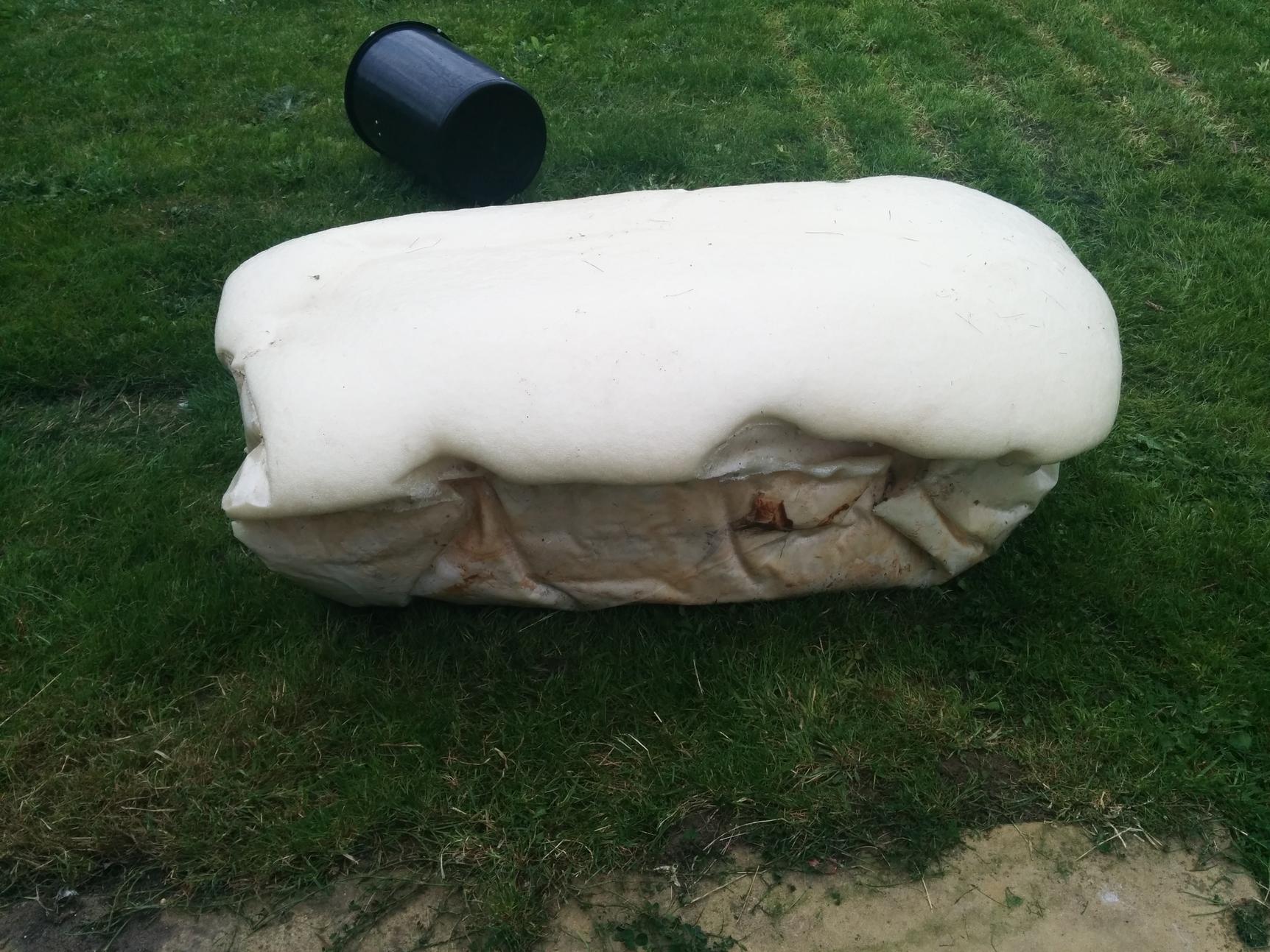

Having mixed foam as per instructions (which I sort of didn't last time) I now have a little to much air in the foam. Instructions are to airate part A before mixing part B - and part B needs to be poured into a jug before being added as the tin can can't pour fast enough, it starts to foam before it's all in the mix, so I discovered.

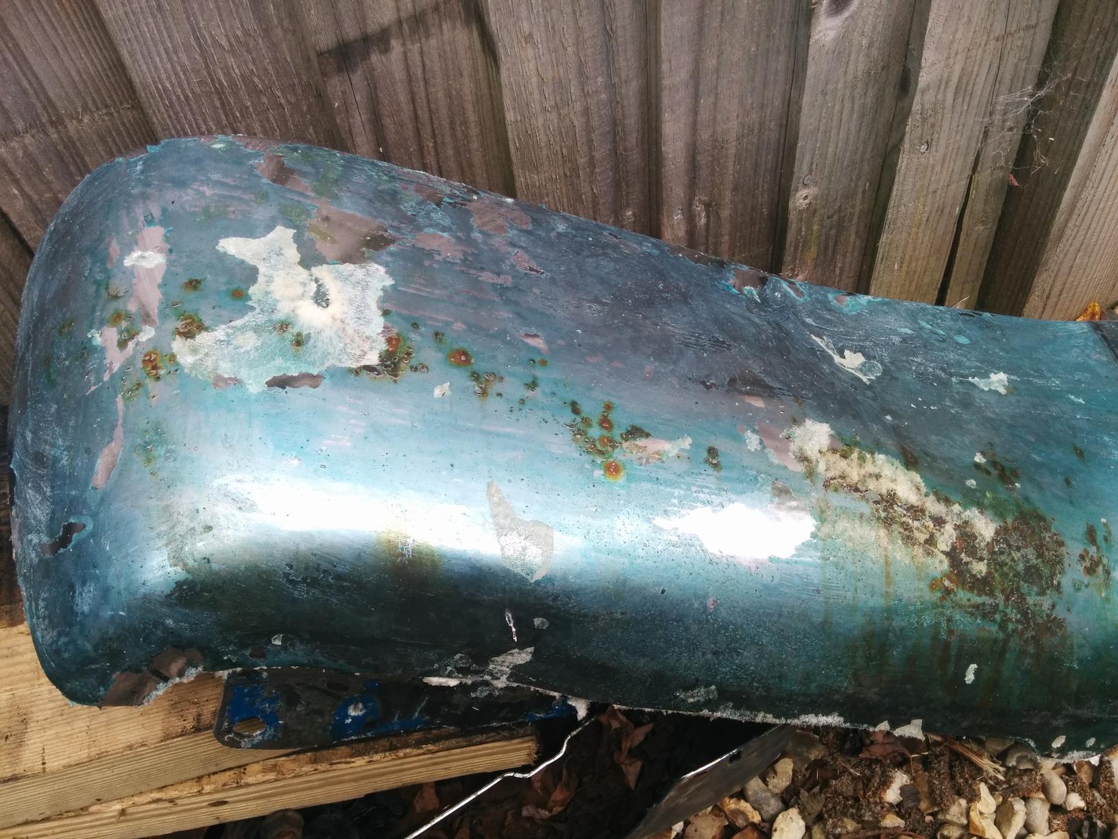

couldn't stop it sticking to the rust either, despite lots of PVA and release wax..

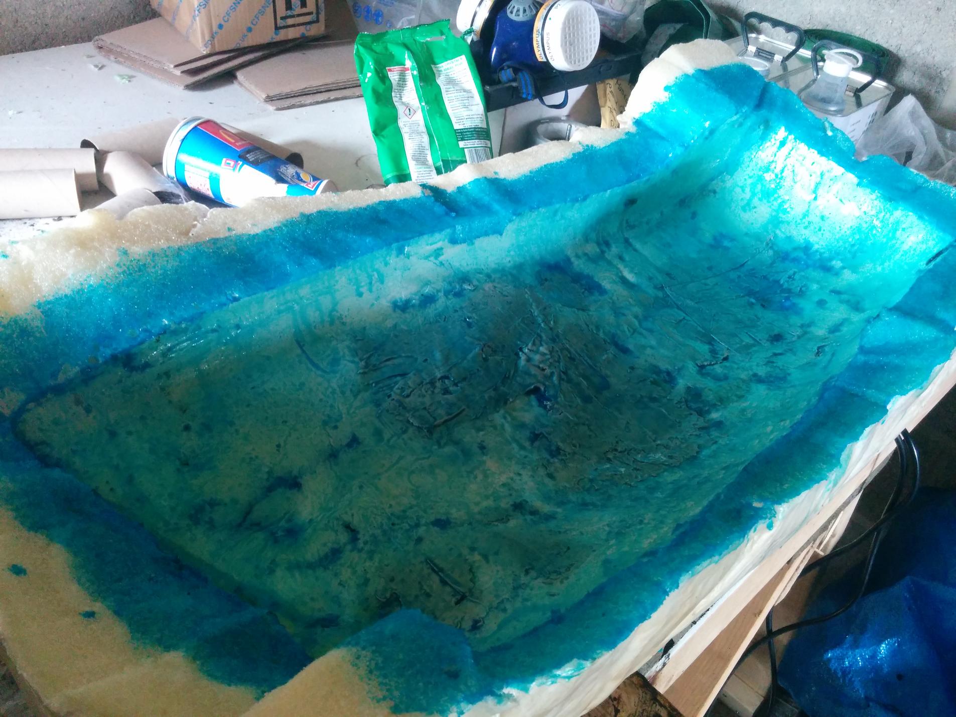

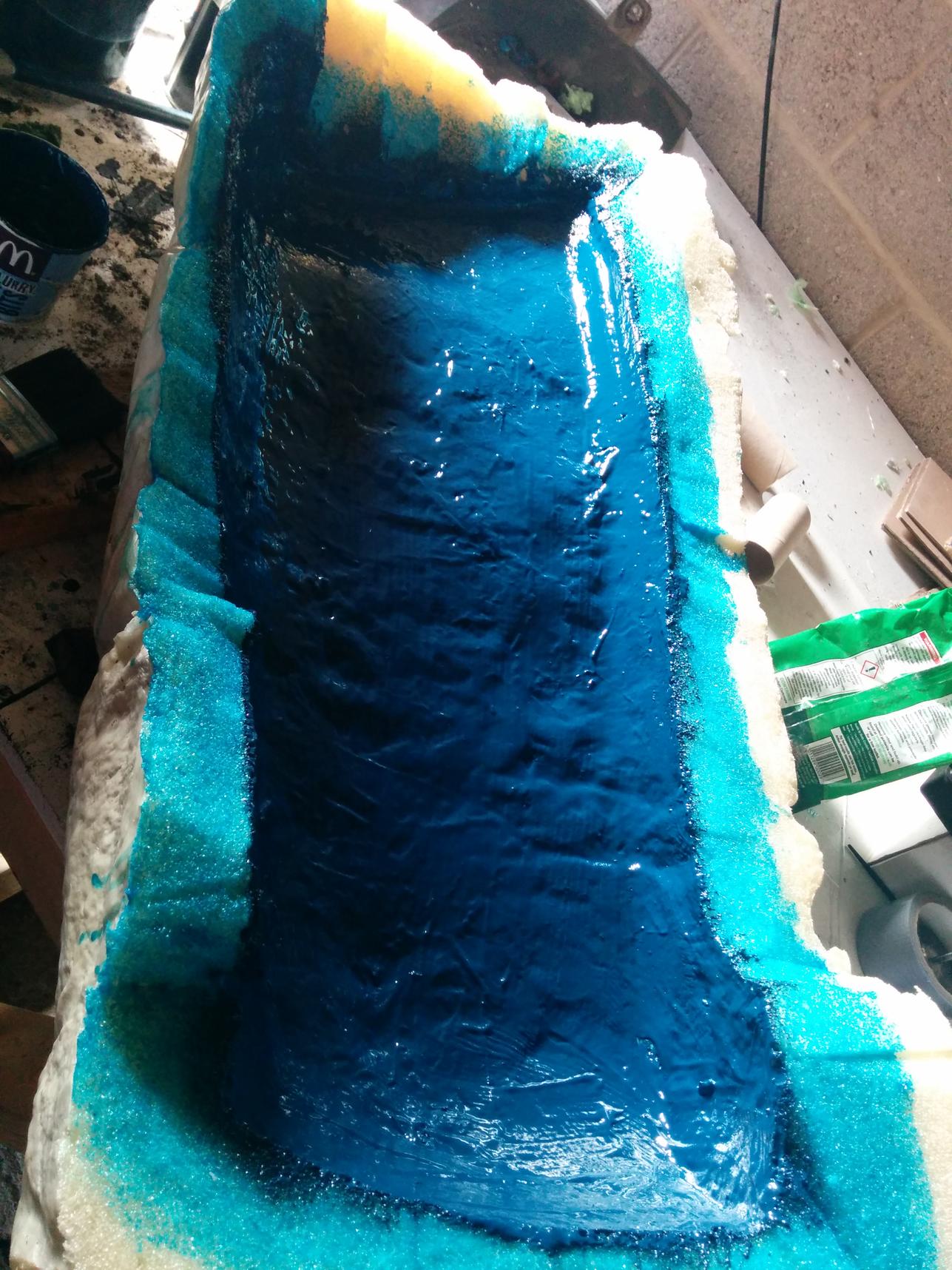

So filled some of the holes with P38, however it will look a bit rough:
As I ran out of gel coat, it should be overlapping the edge, and forgot the mould release wax...oh well...how ever rough it turns out its going on as the the bumper is past it now.
I see much rubbing down in my future.
Might try latex for the main section mould...then I will have used a different mould for every bit.Last edited by andyverran; 16 September 2014, 16:35.
Hi Andy, glad to see you are keeping at it, my glassing took a break too, I was using the exceptionally hot summer as my excuse.
The foam you used, did you have a link to the one that you used?
And
how strong was the foam ?
Do you think that it could be used as a form for the bumper and you glass over the top?
ie so the bumper corner becomes solid and not a shell so to speak?
CheersEat.Sleep.Surf.Repeat.
Hi Ady,
http://www.cfsnet.co.uk/acatalog/CFS...iquid_415.html
It was very robust, used as a laminate like you suggest, I think would work. It took a hack saw blade to get the bumper out of that mess I made, so not to wimpy.
...the hard bit would be getting the shape. I did wonder about filling the long section with it so it was stiffer than just glass.Last edited by andyverran; 16 September 2014, 17:18.

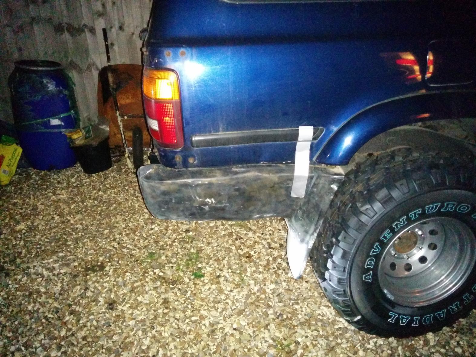

Thanks for your interest, as you say it wouldn't protect anything, though I'm not trying to protect my car.
Many of us just take the bumper of as you know and any protection a steel bumper (or any bumper) gives is at low speed anyway. The main reason I started was to lighten the back of mine as the springs were saggy and I didn't want to replace them, but I did want to keep the mud flaps and the general appearance of the rear profile. The bumper, tow bar and spare wheel/carrier are in the region of 100Kg (about 5% of the vehicle weight that must be) and mine was pretty rusty as most are now I imagine.
Your quite correct in saying it's more work than it's worth, however, having started I will finish! And I do get to learn something new...would I do it again? not a chance.
