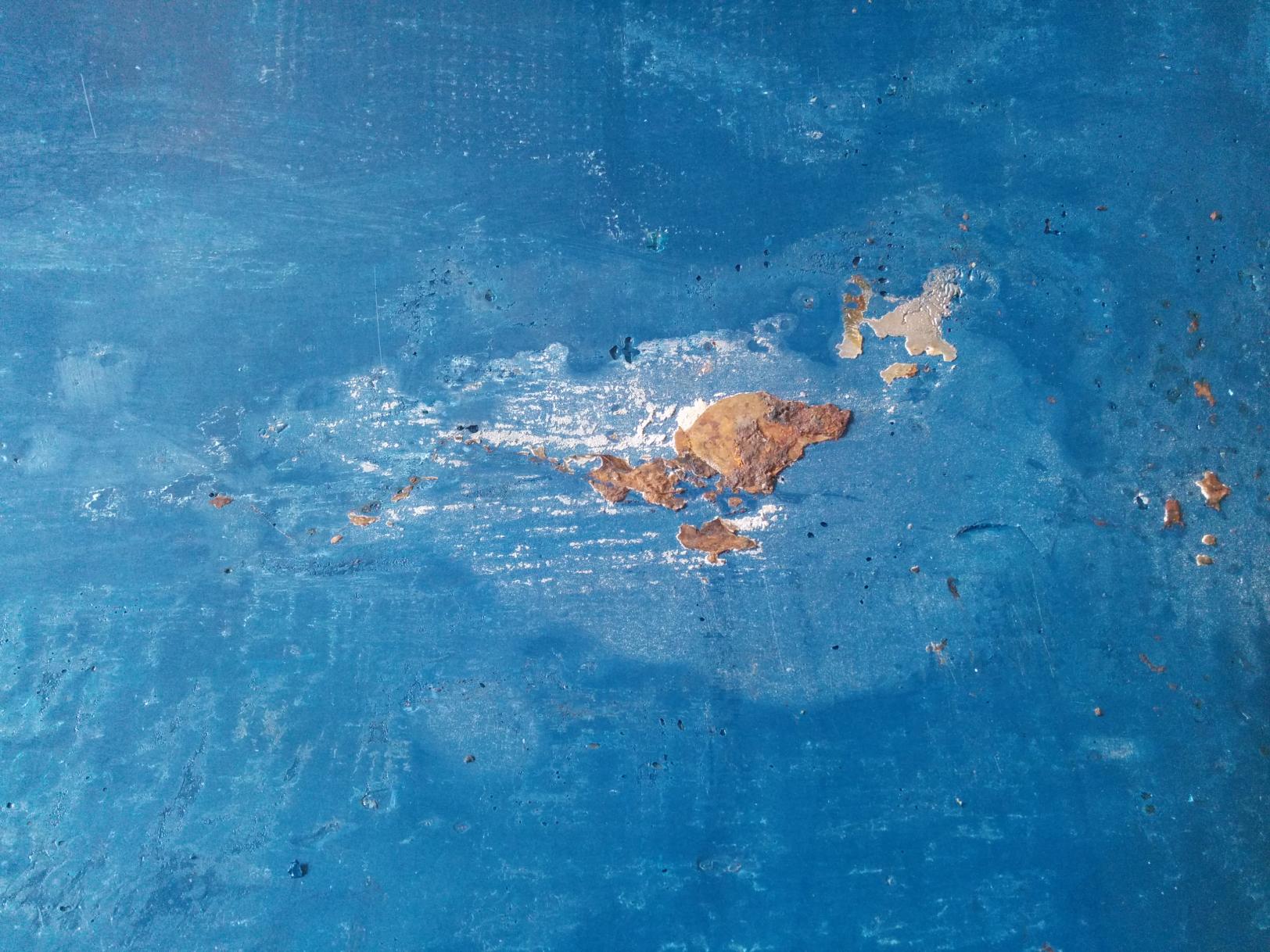

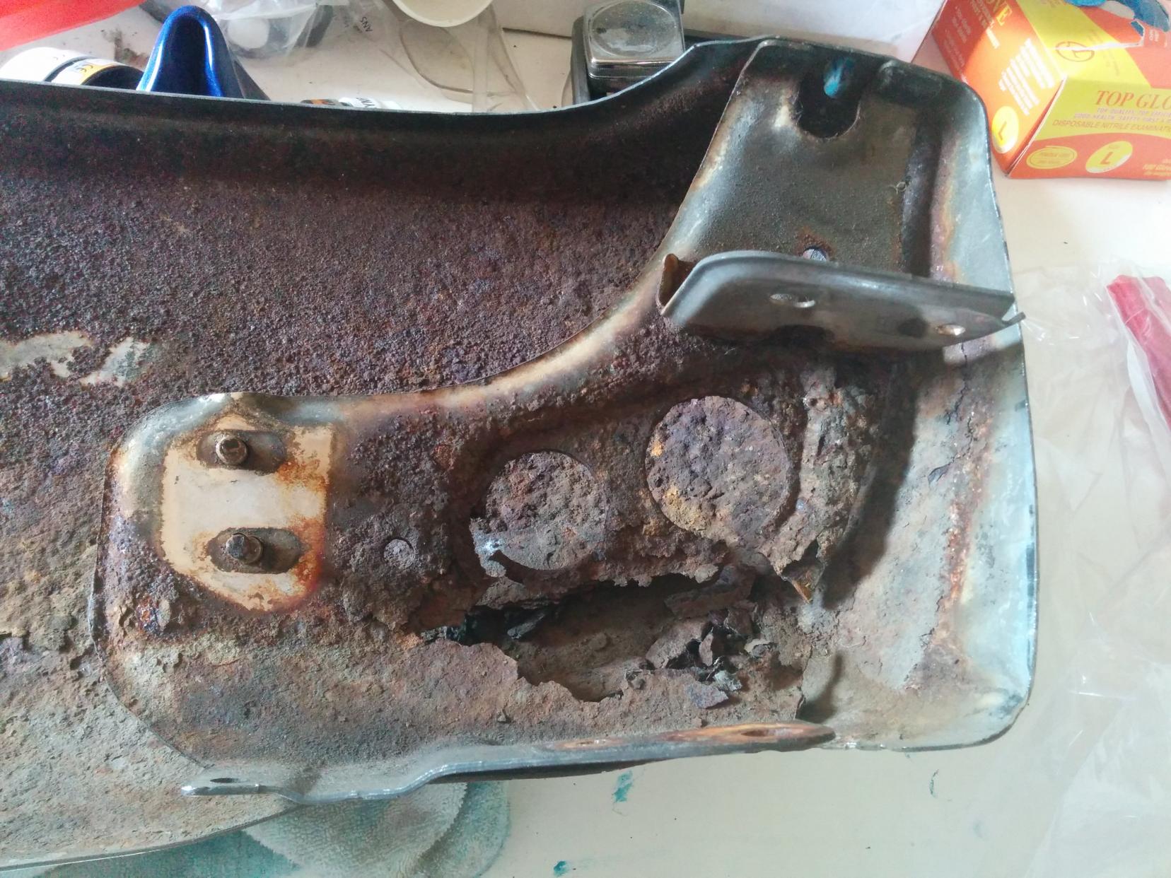

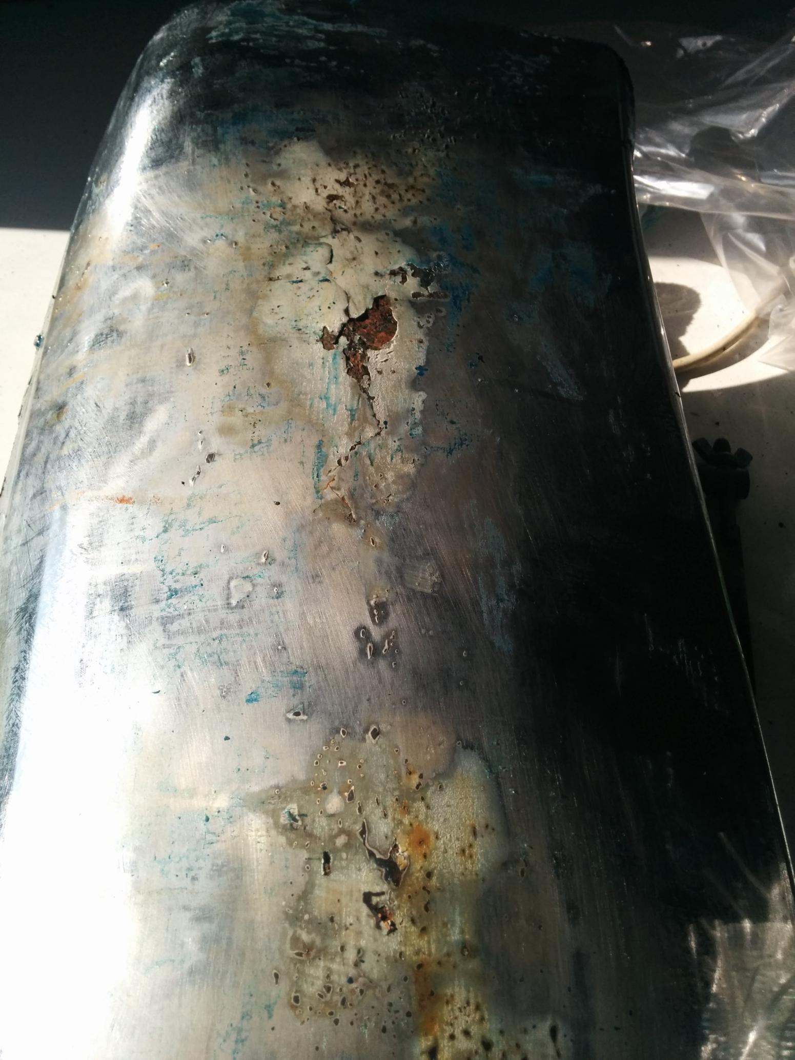

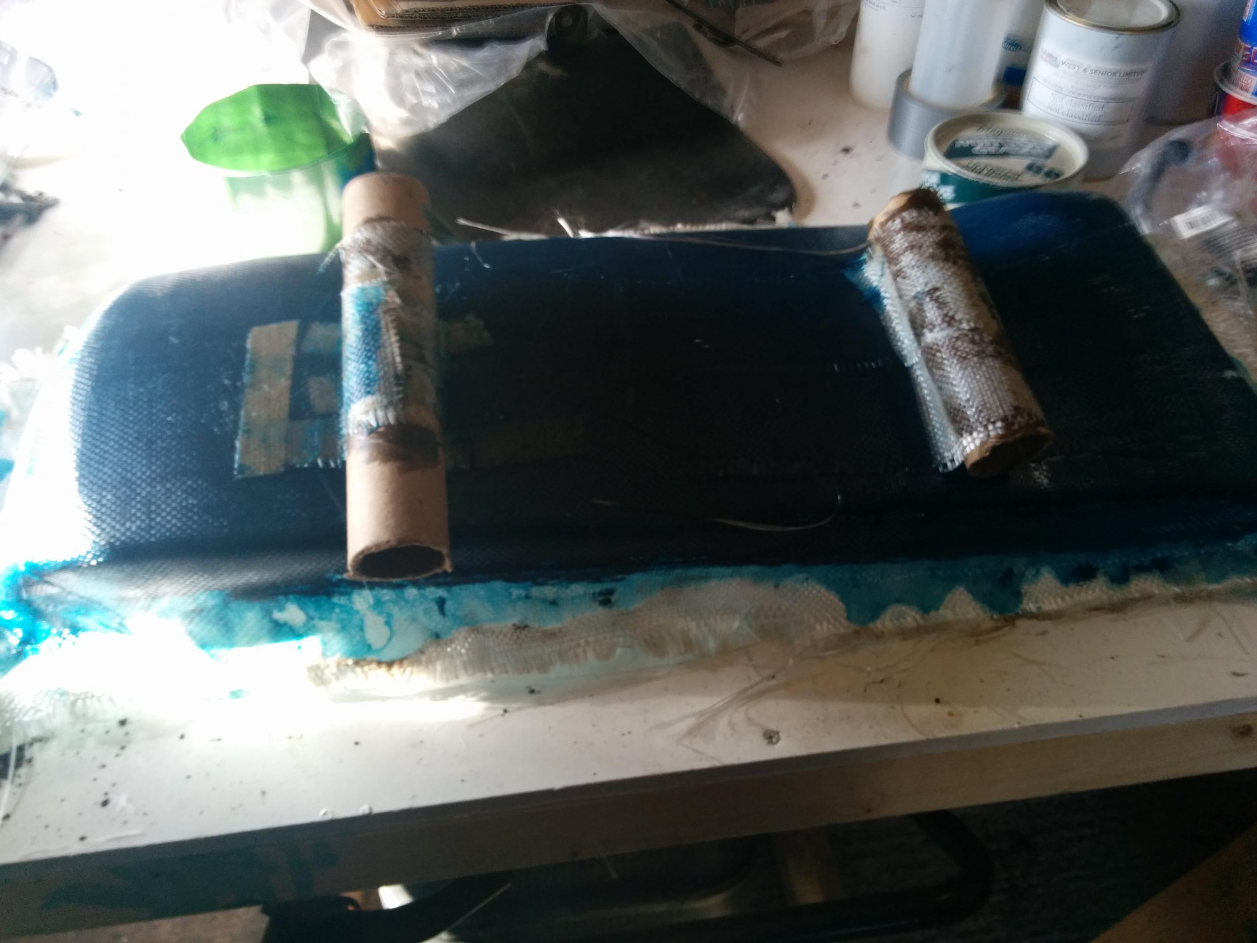

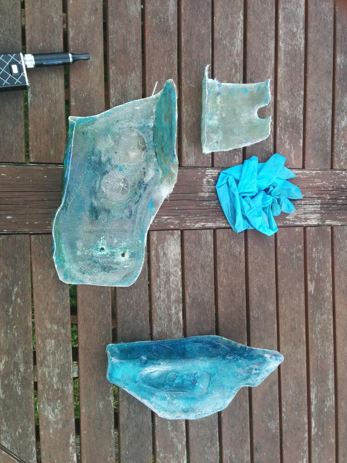

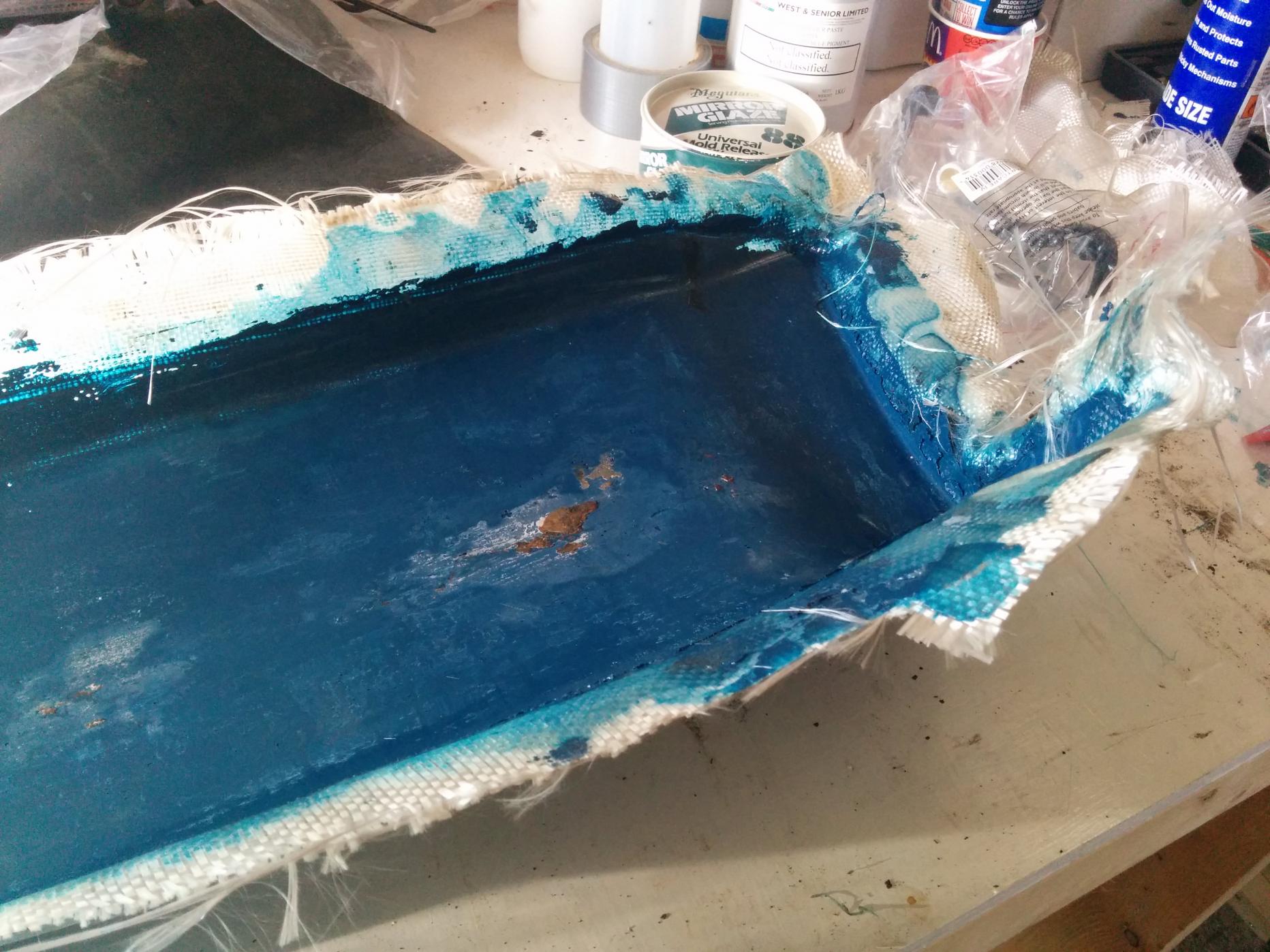

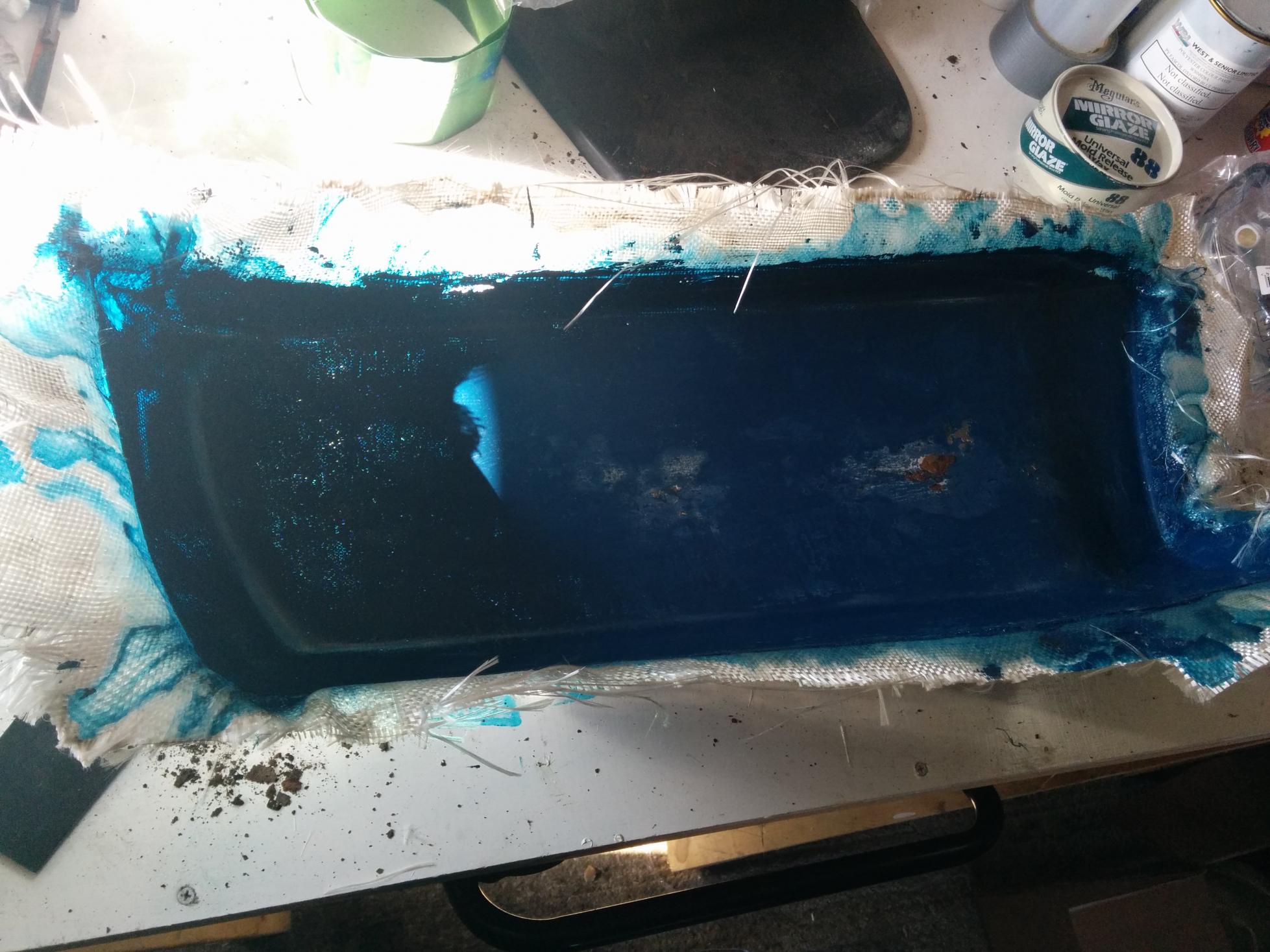

Decided, since I was off to Devon on Thursday, I'd have a bash at moulding the bumper quarter before I went.
Many, many errors here...I really didn't expect it to work first time (and I wasn't disappointed), though you always hope a bit don't you!
Think I need to use something "clay like" to get a better edge on the mould, and more layers of glass, leave the PVA for longer to dry and have more layers of that.
Really struggled to get anything to act as an edge to the bumper...
Gel coat was to thin as well...
Some bumper got stuck to it to boot...fingers crossed it lasts through another go...
Attempt no 2 when I get back I guess, after another pay day
If anyone has any suggestions on how to do better or pointers for cheap materials please chip in.
Oh, I weighed the original part (3.5Kg) and the mould attempt...497g so if I can get it to work the final bit may come in at 1Kg if I'm lucky.
