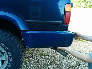

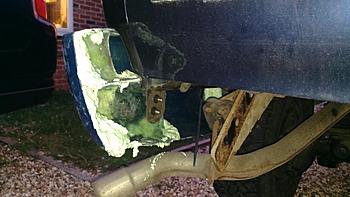

Fiberglass Bumper Moulds attempt

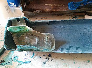

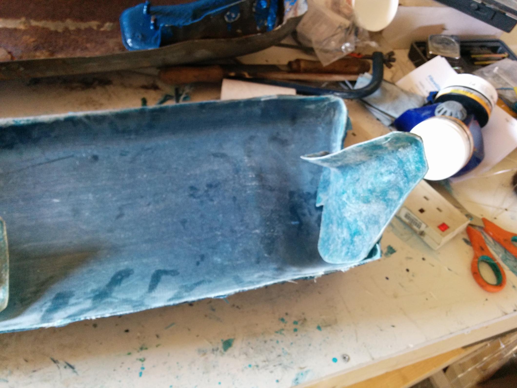

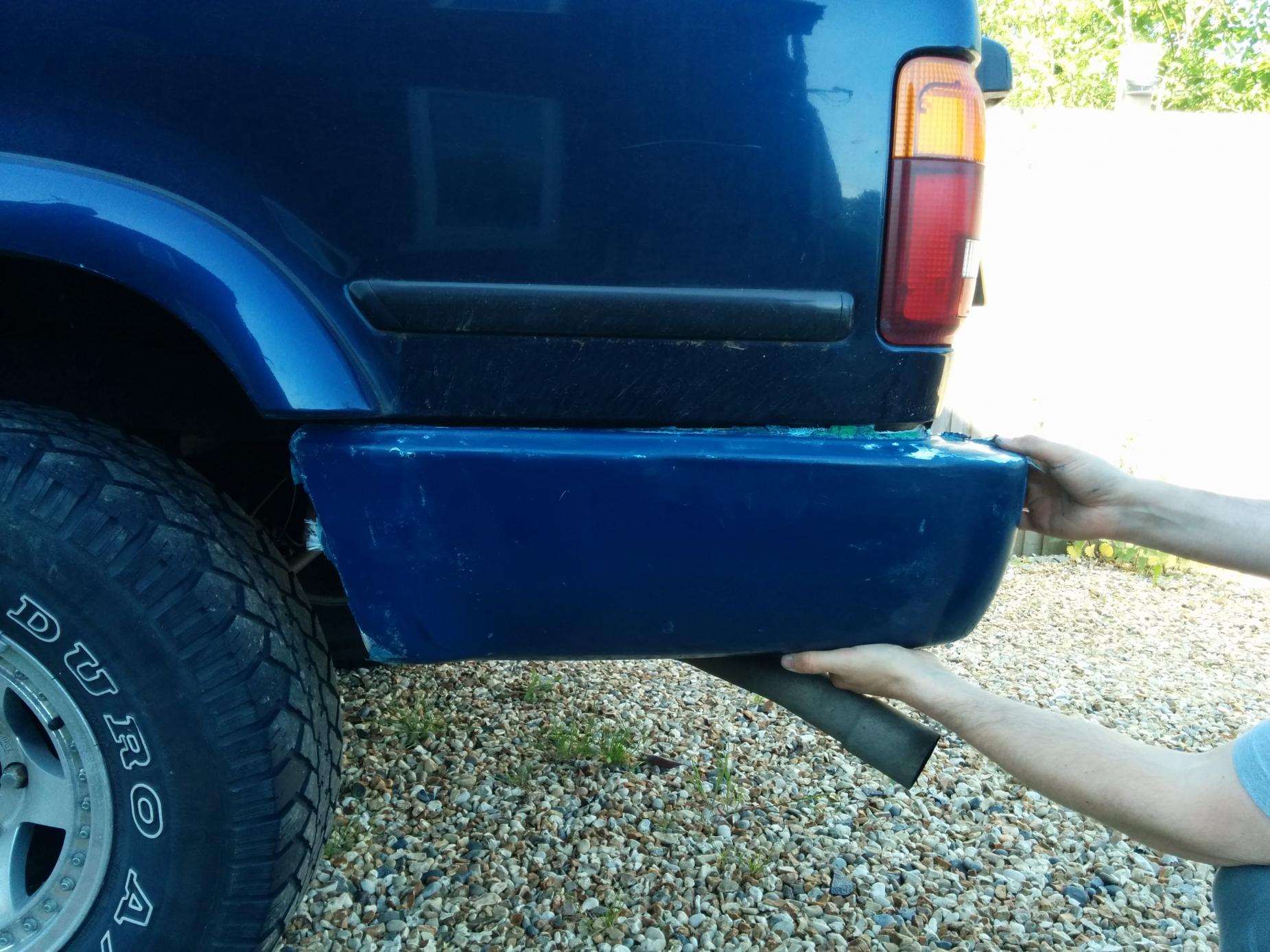

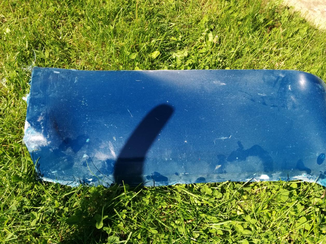

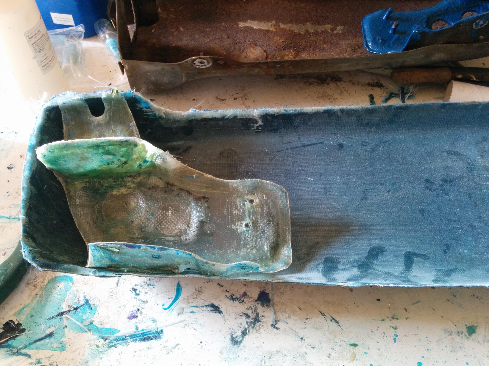

Well....got it out of the mould in the end, a bit of damage around the edges and something of an issue with the part getting stuck. I'll have to be more carefull on the next side.
You'll need some imagination with the part, I need a cutting tool to trim it neatly (ordered) and some of the mould gel coat has stuck to the part, so I have to flat it all down and paint it along with repairing the damage from releasing.
Oh and got to bond the brackets in also...
Unluckily for you lot my beautiful assistant was on the other side of the camera, so you just have to make do with me.Last edited by andyverran; 18 May 2014, 20:12.

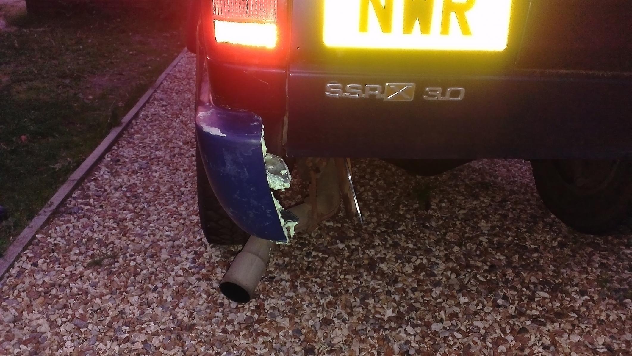

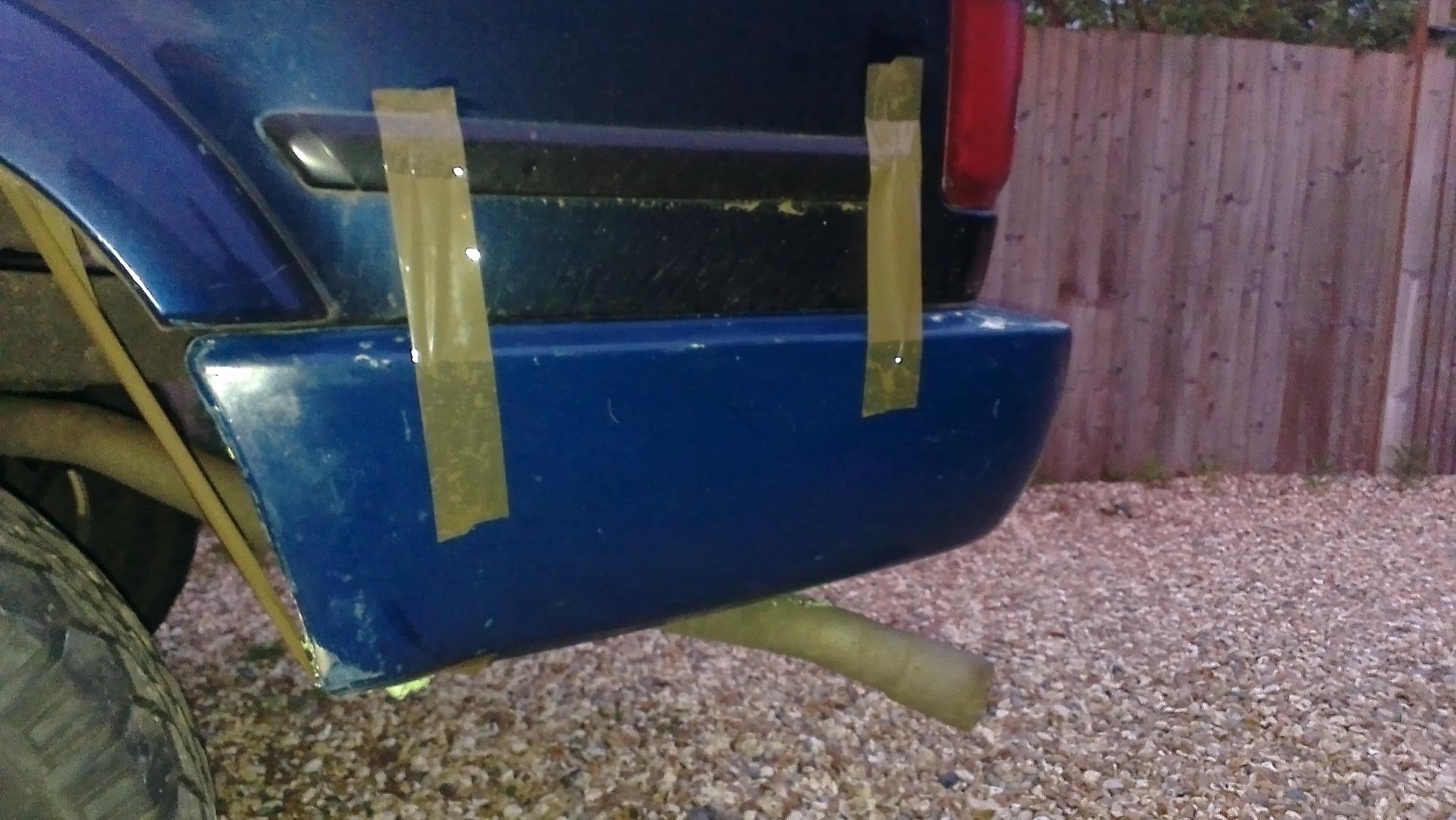

It has become something of a mission to get to the end, learning every time I do a mould it seems I make new mistakes!Originally posted by shokenore View PostThat is without a doubt very impressive.
Kudos to you for keeping at it, and posting it up here.
Definitely puts my effort to shame.
Getting better though.
I wouldn't say it puts yours to shame, you made something new from scratch where as I copied a part that already existed...very different things to try doing.

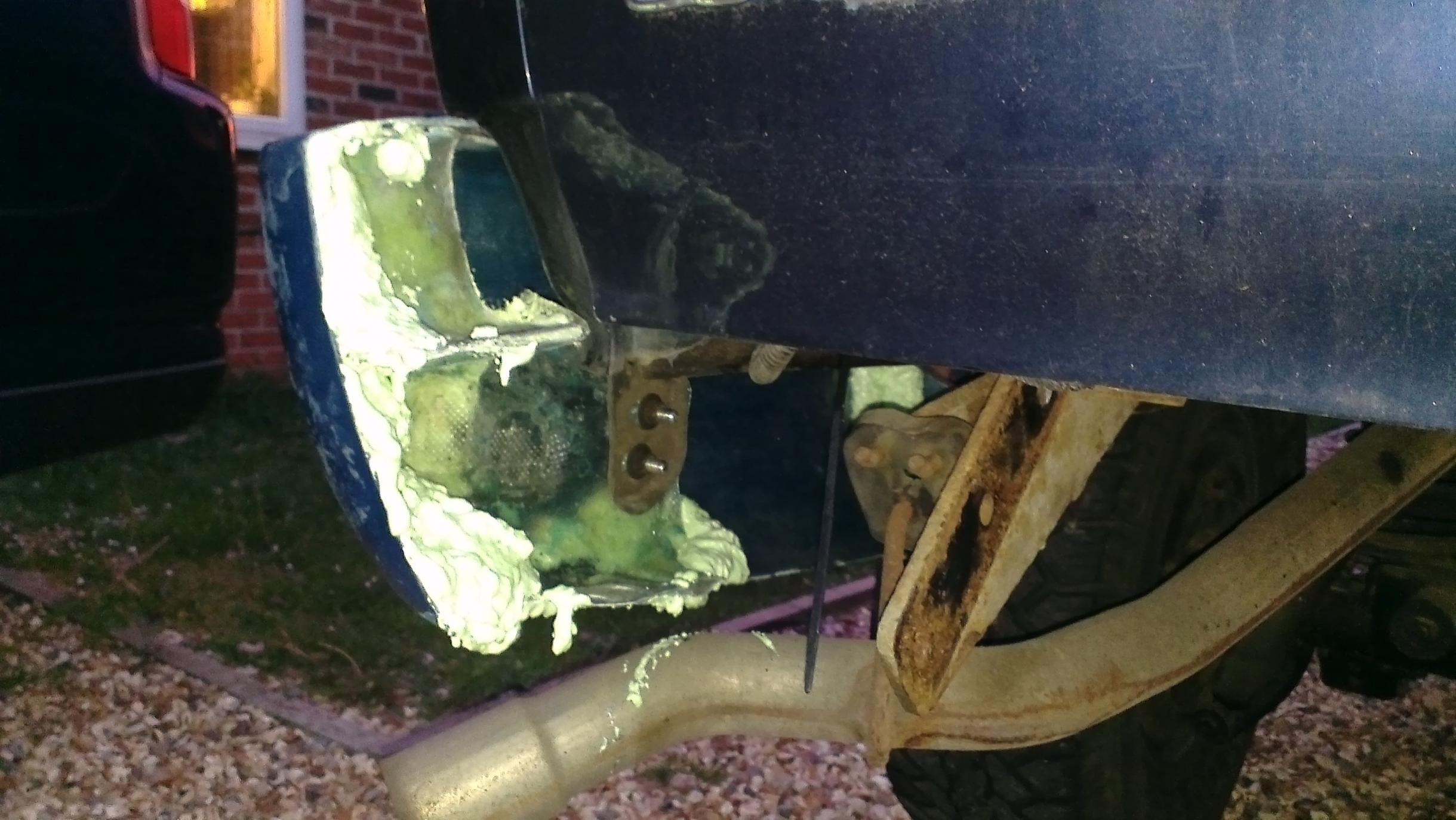

No, you wouldn't, could be bolted on then....but I'm on a tight old budget and I kinda wondered if it would work!Originally posted by KERRSURF View PostIf you bonded some plate into the glass would you still need the expanding foam?Last edited by andyverran; 22 May 2014, 22:01.
lol, the mould wasn't good enough for that, nor was it durable enough....I knew it would be trashed making a part and it was...well releasing it anyway. My bumper was well bent too...and the next corner is even worse!!!Originally posted by shokenore View PostI wonder if you could recoup your costs by hiring out your mold.

With the mould, getting the part perfect to be moulded is where the work lies...took me 3 goes before I was even half good enough...and the next one will be better again...
