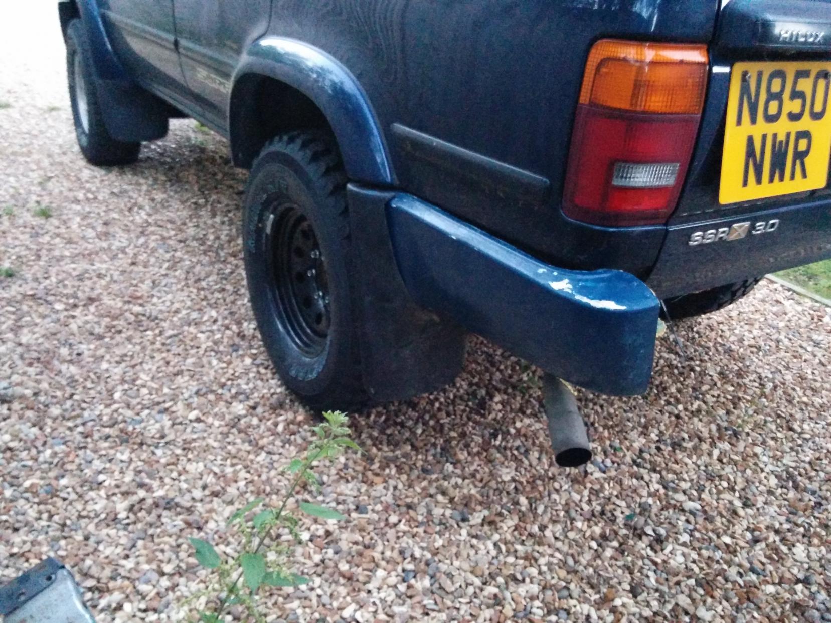

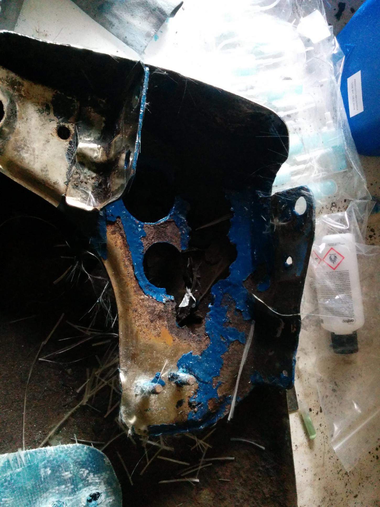

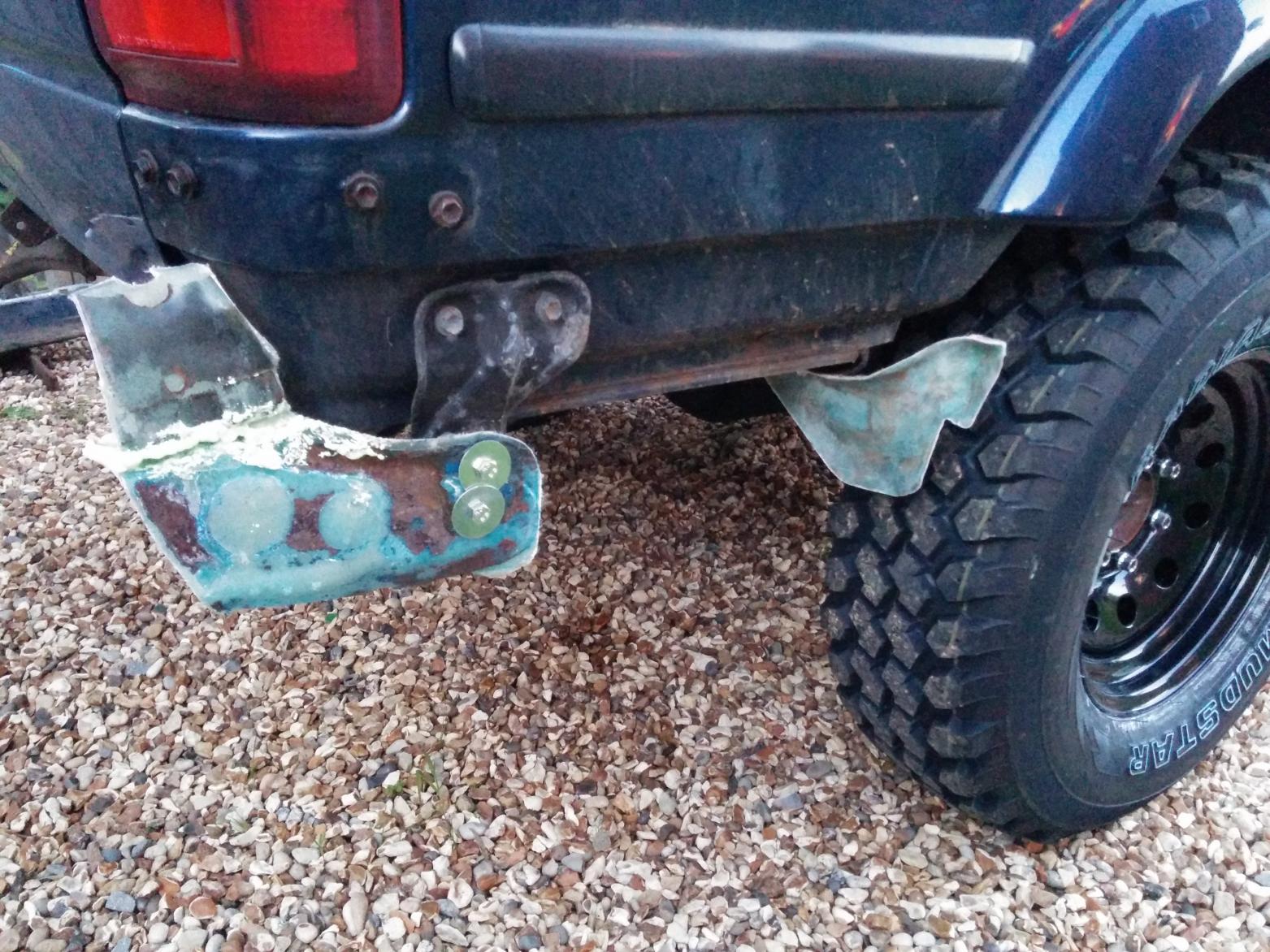

I used a mixture of different cloth...the brackets were just made from off cuts mind, the bumper outers were different however:
I did the sharp edges and corners (first layer onto the gel coat) in the the really fine tissue like stuff, easy to get in the corners. Once that had gone a little tacky I put CSM over the lot (didn't want the tissue to move as I really struggled with getting the edges right), then the weave over that...partly because I thought it looked better and it wasn't really any more money...might be slightly stronger though that wasn't important since I was making it all as thin as I could.
I did think about making a few if I could do a good enough job of it...currently I'm not good enough...you never know, I may get there one day.
Are you going to bite the bullet on your bumpers?

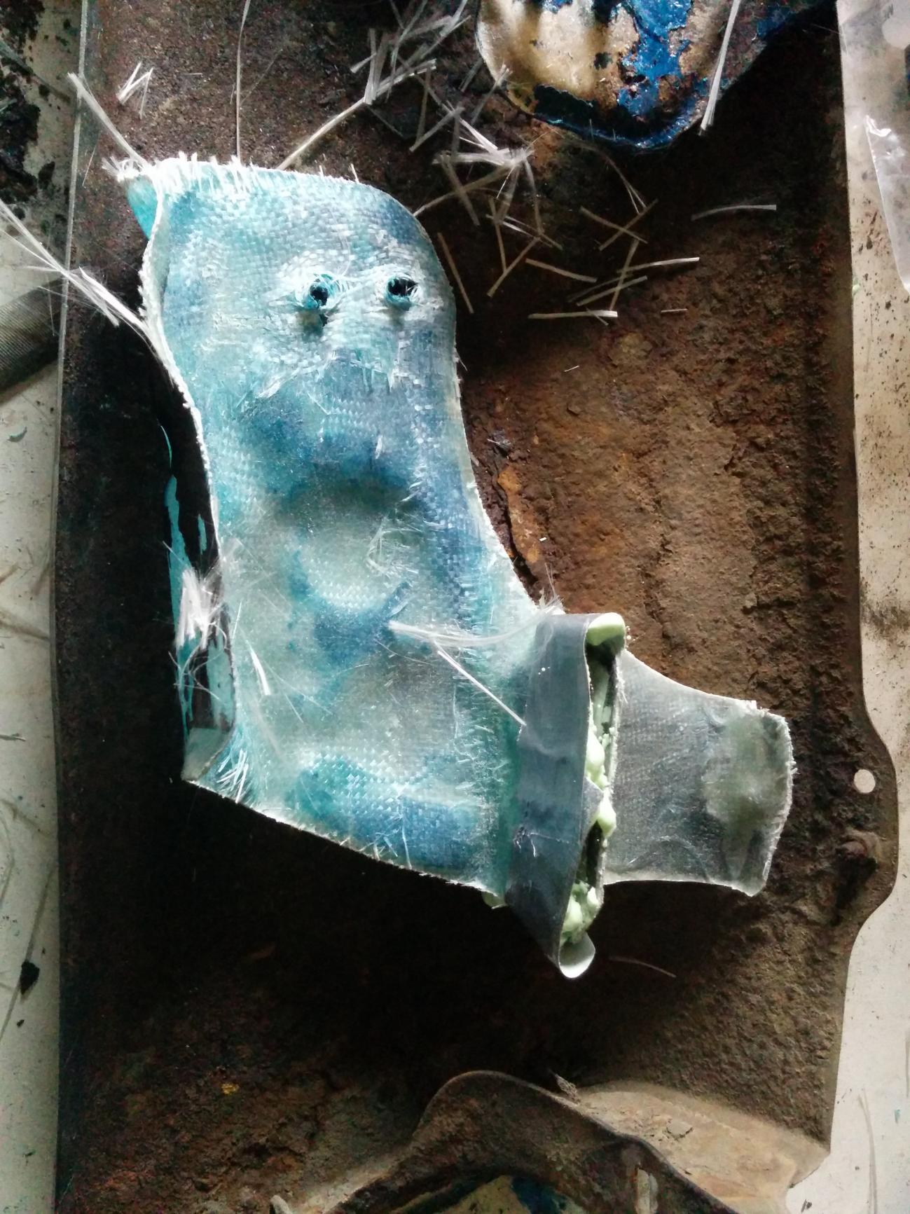

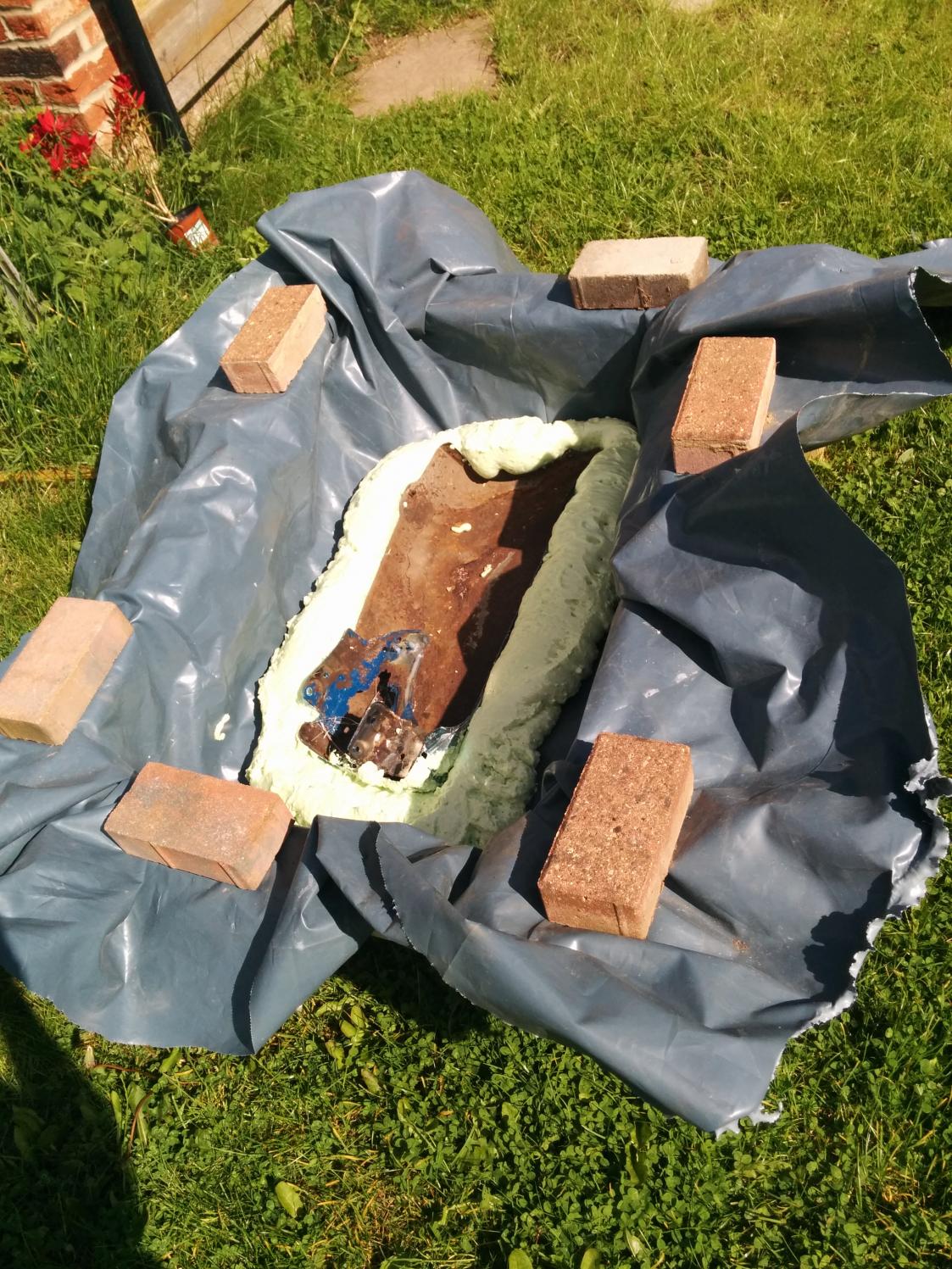

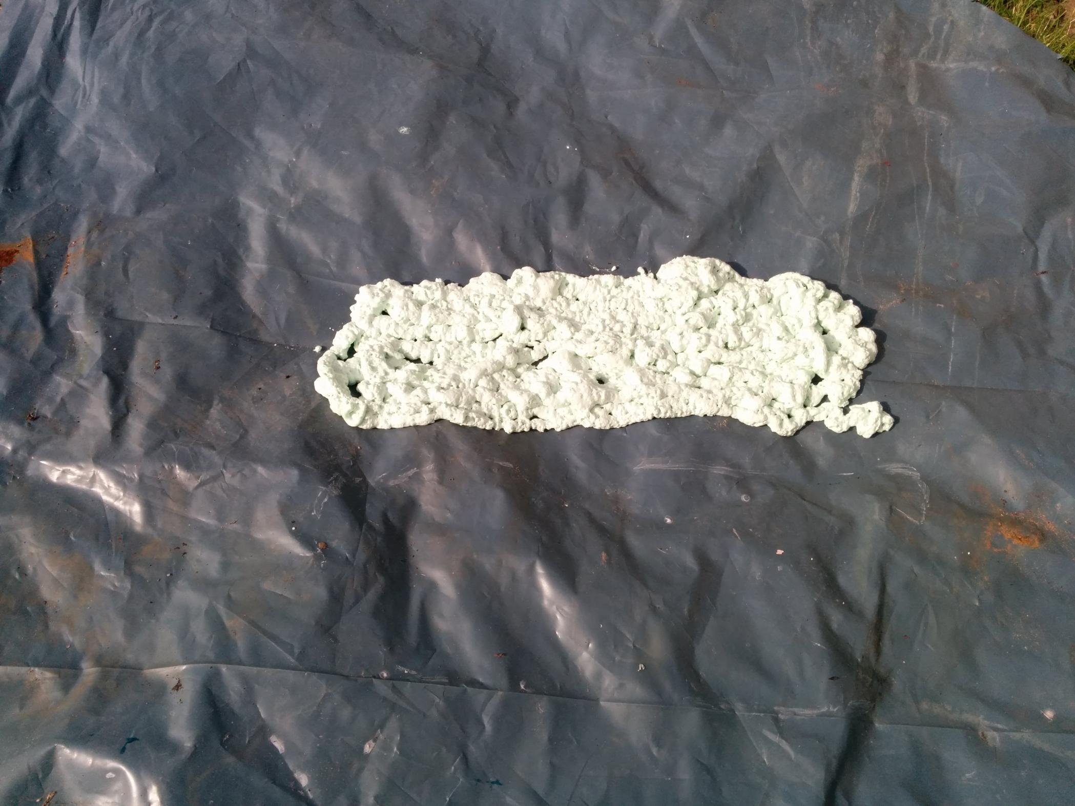

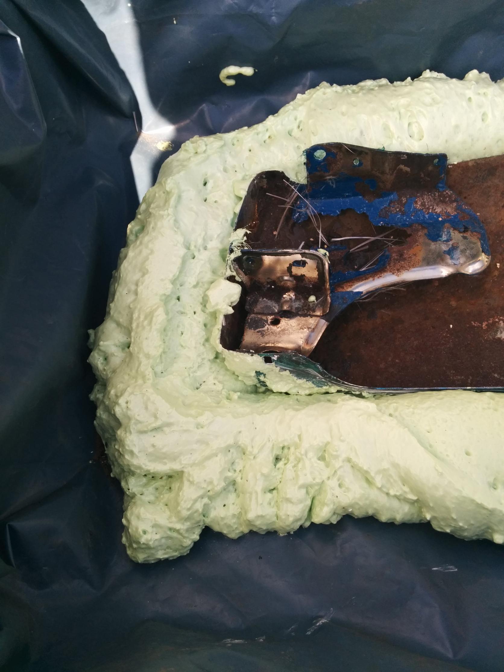

Had another go today, what with a day off....
Definately going to have to make a frame to contain the foam and part...as it expands it falls away from the bumper since it can't stick due to the mould release wax..so good, in that the wax might work! but bad as it won't hold a shape "free form". The low expansion foam in a can is no good either, just not enough of it and it doesn't expand enough to really get good coverage.
Take 3 next week once the 2 pack foam arrives..
