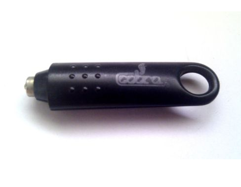

      on another note dont suppose any one has one of these laying about (i know i'm pushing it sorry)
