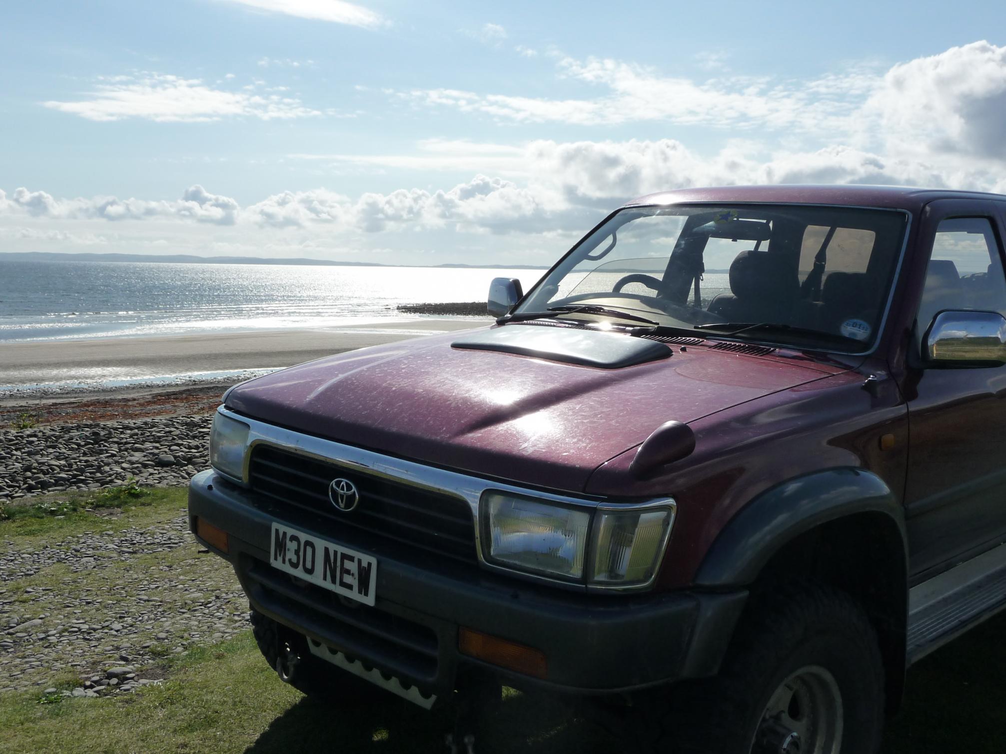

Glad to see that you're back safe, kev. I vented mine with a
Trooper scoop turned backwards. Hopefully, to help release trapped hot air and marginally increase airflow through the radiator.........Cheers....Mic k.

Got mine for twenty quid and sprayed it to match the bumpers and arches as a contrast. Didn't do it with a jigsaw, because there's some structural stuff under the bonnet skin (For those who haven't removed their sound insulation). I just used a hand held nibbler, about a tenner from MM. I'll take some detailed pics tomorrow, if you like, to show you where the holes were drilled.......
