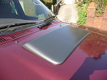

You don't mean something like this do you?
Funnily enough, I reckon that could make for an interesting look on a Lexurf...!

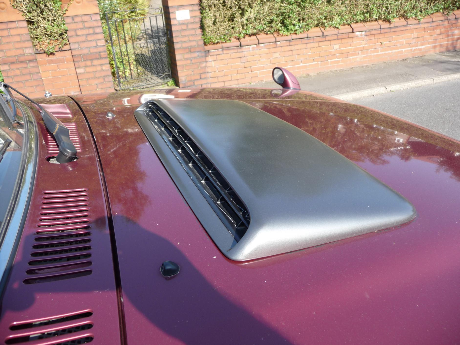

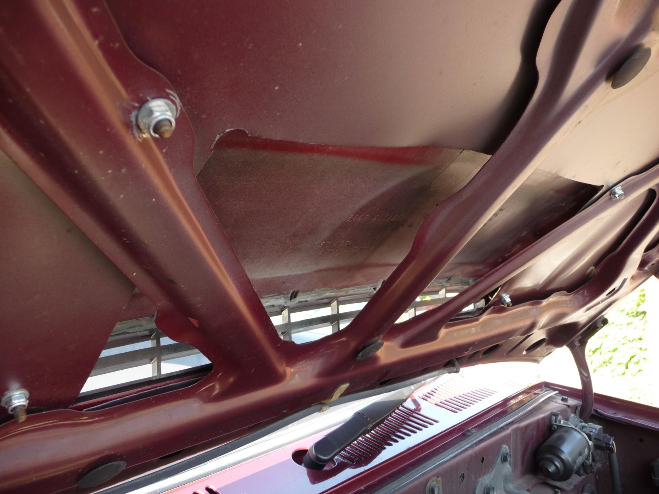

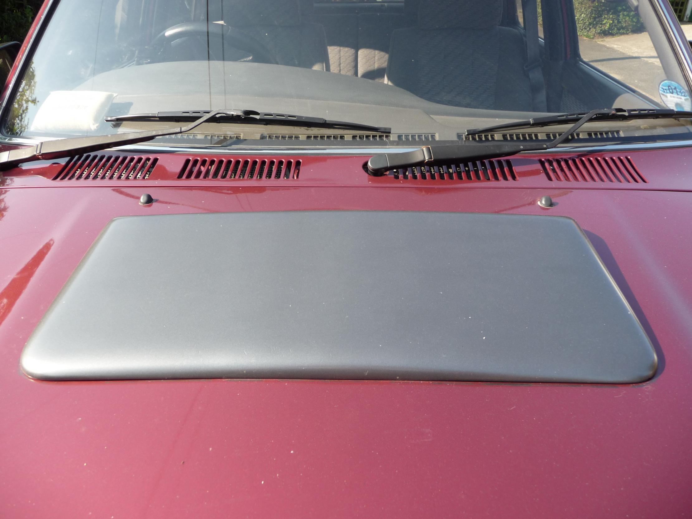

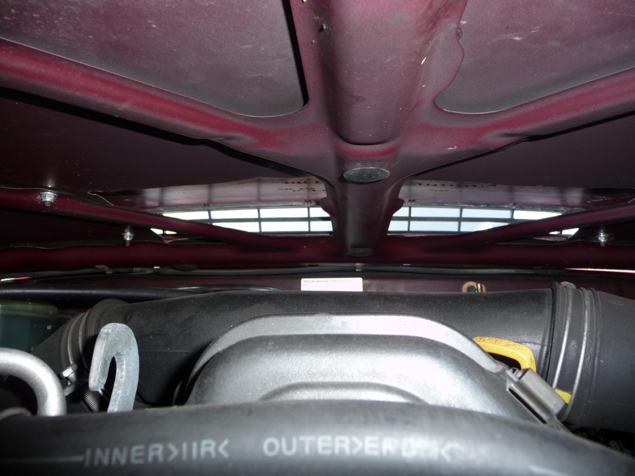

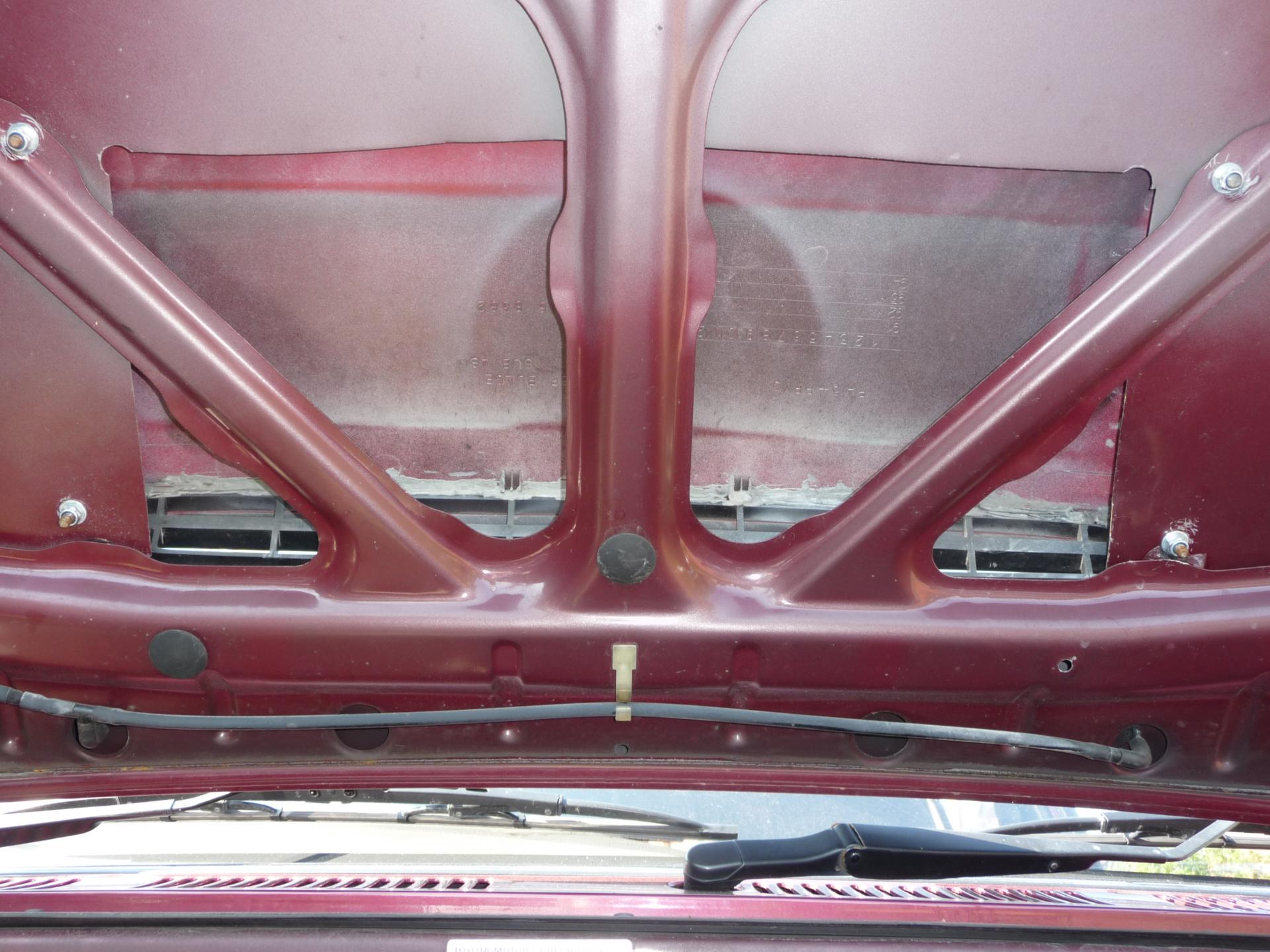

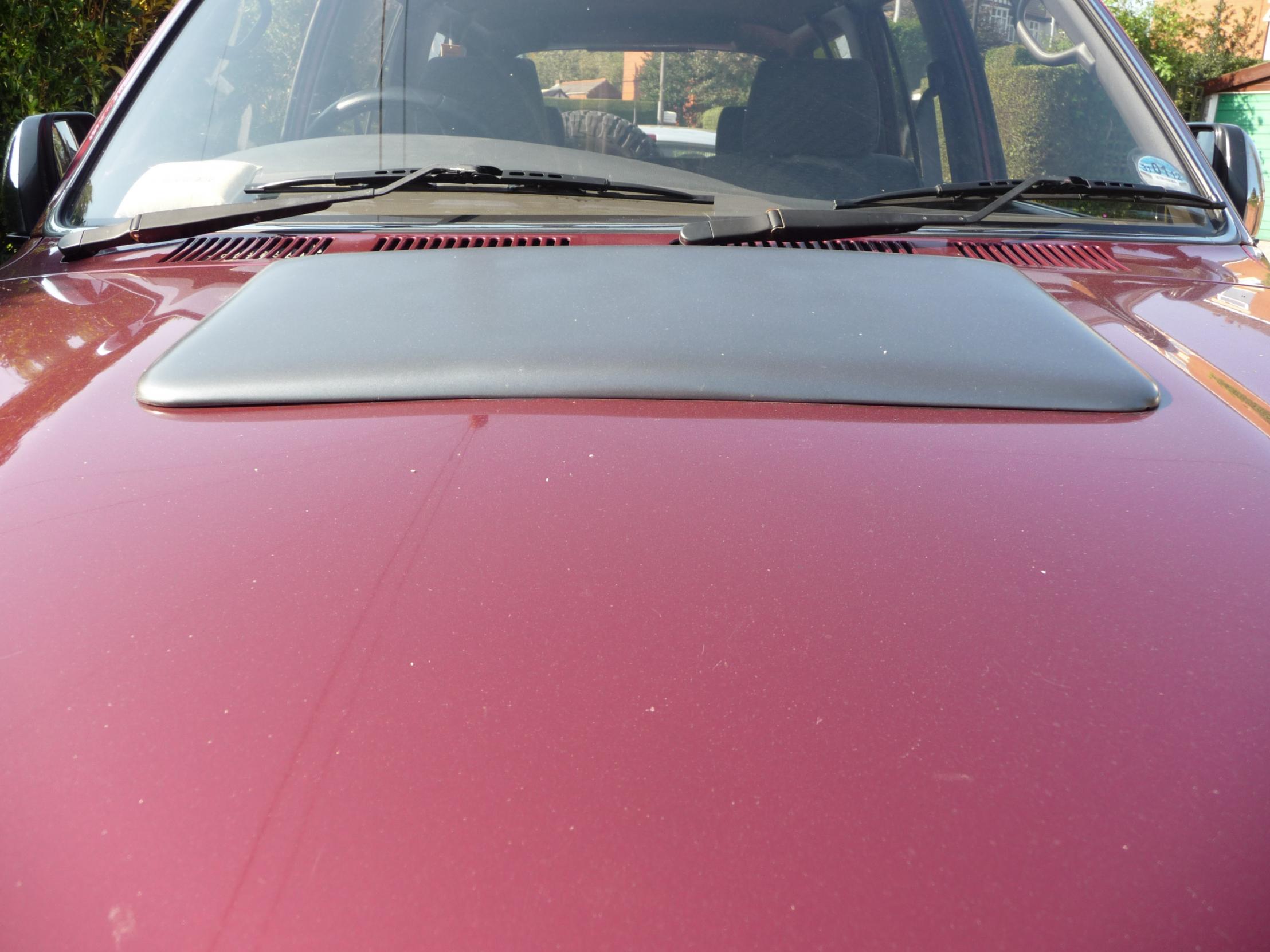

Got mine for twenty quid and sprayed it to match the bumpers and arches as a contrast. Didn't do it with a jigsaw, because there's some structural stuff under the bonnet skin (For those who haven't removed their sound insulation). I just used a hand held nibbler, about a tenner from MM. I'll take some detailed pics tomorrow, if you like, to show you where the holes were drilled.......
Here we go, Kev. Theres a link to the Aussie site, where someone has used one as a scoop for an intercooler. http://www.toyotasurf.asn.au/techsit...lingpajero.htm (Holden
Jackaroo.............what were they thinking?.... As promised, here are some pics of mine. It looks a little bit "Redneck", because I need to remove it again, and put rubber beading on the bare metal edge. When im satisfied, I'll also put a bead of sealant between scoop body and bonnet, to seal it permenantly......Hope these help....Cheers....Mick.
