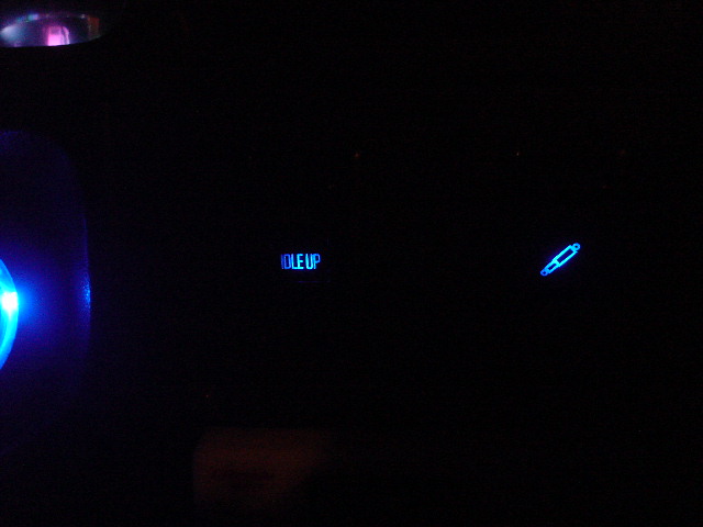

These are some of the switches i did, some have replaceable bulbs like the heater one's, some have built in leds, and some nowt at all, the door master switch has leds soldered onto three small pcb's, cant remember which switches have what as it was over 3 years ago i did em, as i remember the hazzard switch has an led and a bulb, all the original lights are pi$$ poor tho,

Cheer's Darren, aye! it took a while, definatly wouldn't do the instruments again, there must be 200 leds in there, i'd fit the indiglo white dials next time, much easier and look good

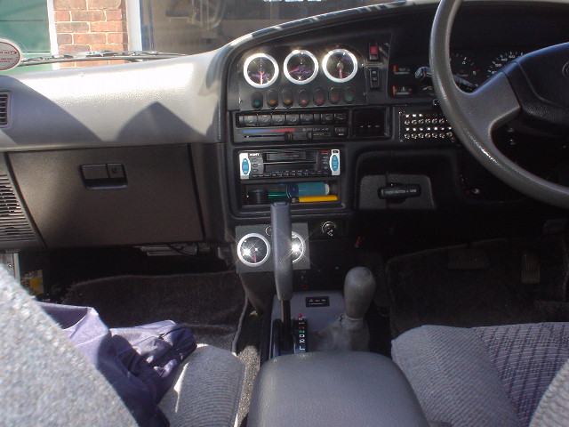

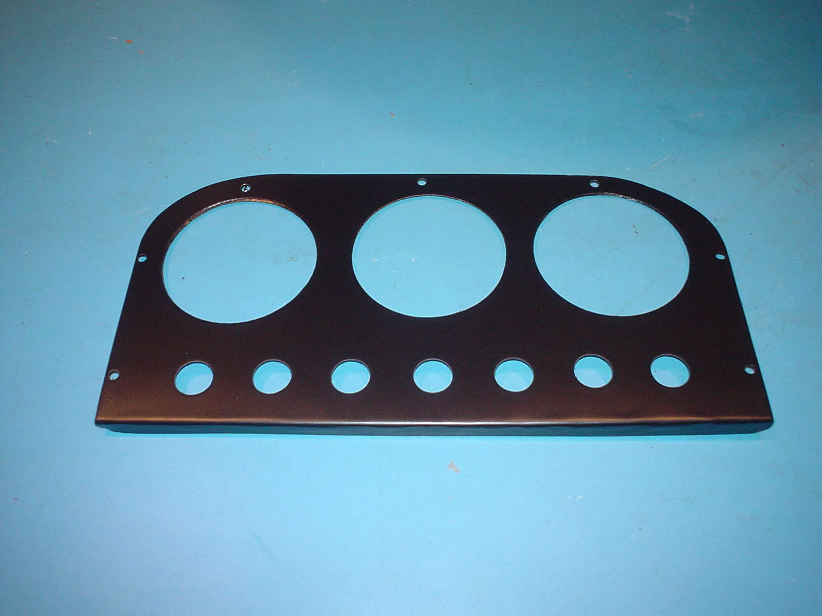

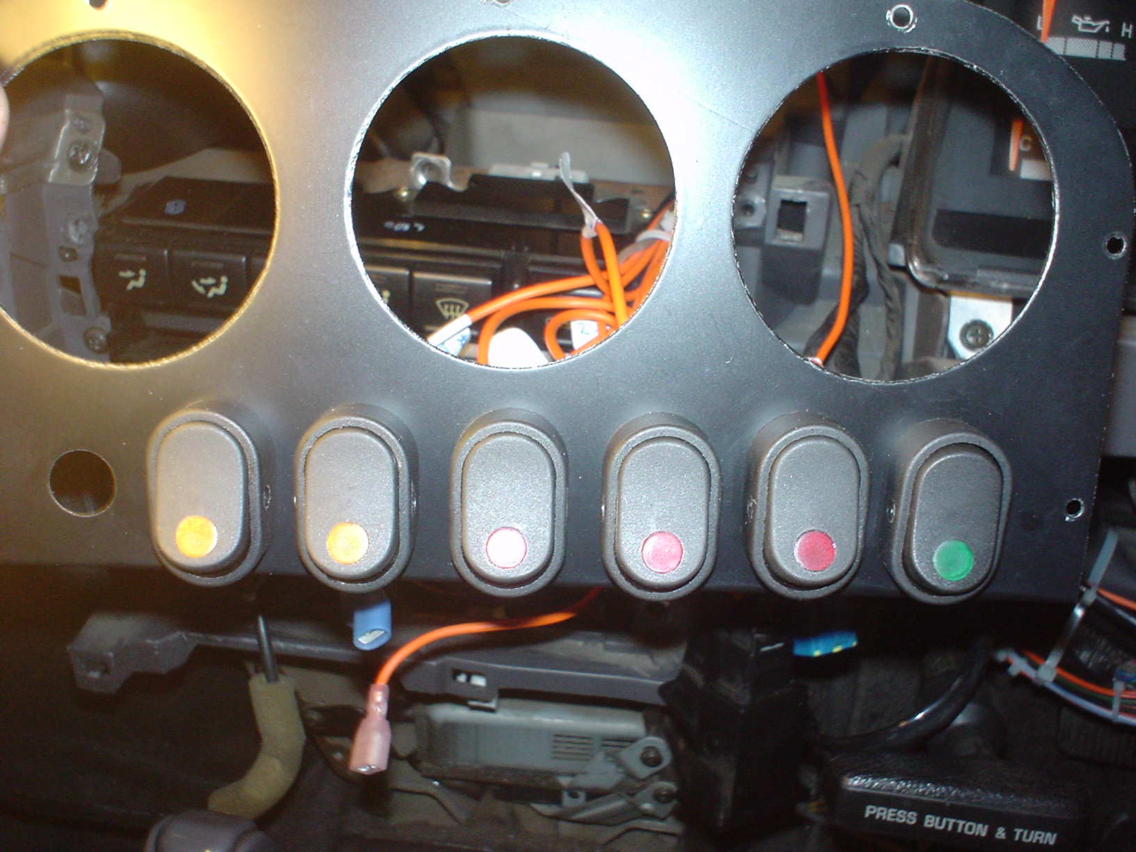

Tony, i just cut away the plastic around the center vents and cup holder (never used em) and made this panel to take all the soptlight switches and 3 gauges, if ya do this you'll need to block off the air trunking to the vents, i used a bit of plastic and tape,
the switches, the ones that already have an leds in wont need an extra resistor, they have one on the small pcb's, off hant it think it's only the ECT and rear demist switch that have led's (may be wrong, it's been over 3 years), grab some spares and see!!
