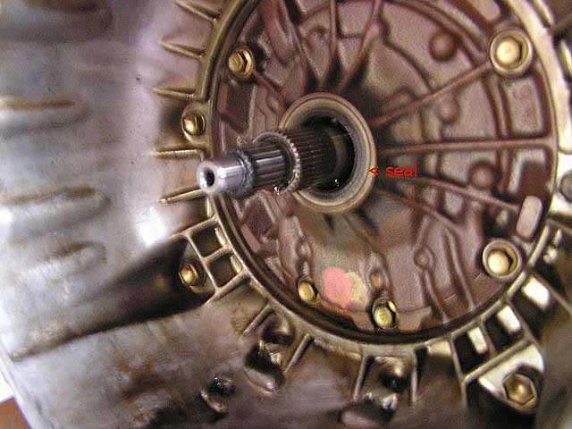

    Torque converters don't leak, they're a sealed unit.
    It's most likely the transmission oil seal thats worn. either way, the transmission needs to come off.

        Torque converters? A couple of hundred pounds I would have thought, never had cause to look for new ones to be honest.
        Oil seal? About £8 if it's a dealer part.
          Vince is right, it 99.99999999999% will be the seal.
          Parts cheap as chips, but lots labour if you're paying someone to fix it.
