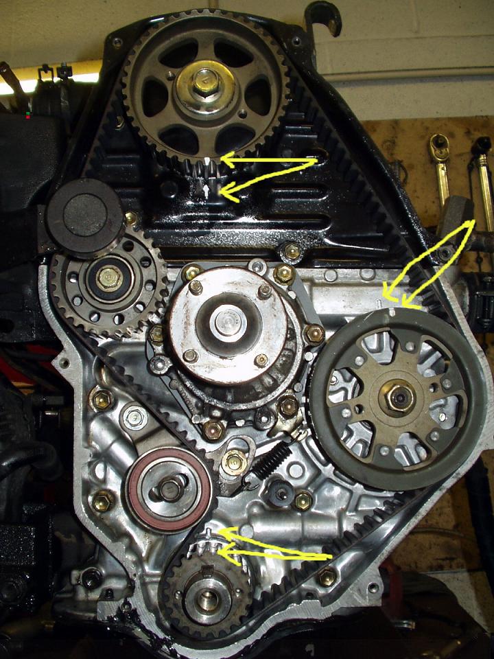

      Has anyone got a picture of the 2.4 engine showing the cam belt and timing marks, hopefully before tomorrow when i have anothe go at setting it up, should the marks be spot on middle and are they all at the 12 o'clock position.

      • #33
        http://toyotasurf.asn.au/techsite/timingbelt.htm
          I suspect that's where your problem lies? Who the fuk told you they were all at 12 o'clock?

            • #36
              Cam is 6 0'clock.
              Nev

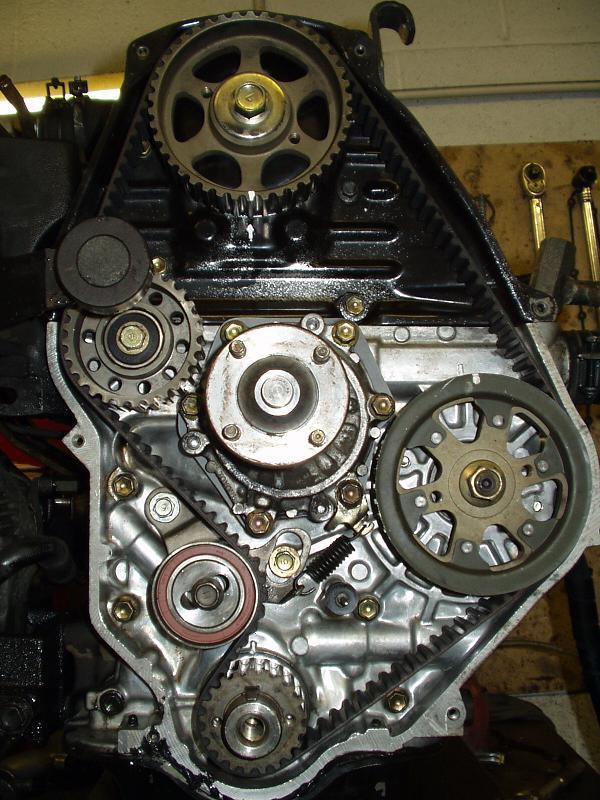

              • #37
                Pics care of STEVOS Workshop
                  That was a question "are they all at 12 o'clock"
                  The lack of a question mark made me think you'd made a statement rather than asked a question.
                  You should be asking how to time it before you do the work, not after. Your "question" makes it look like you've set the timing marks at 12 o'clock the first time you set it up.

                    • #40
                      So hear is the mistake i made, i took it that the white mark at the top was the timing mark but no harm done to the engine, good job a ran it round a few times by hand to make sure nothing was catching. all is fine now, just need to bleed the bleedin air out the water.
