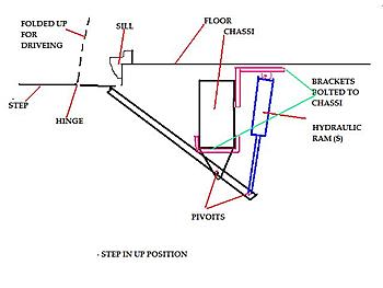

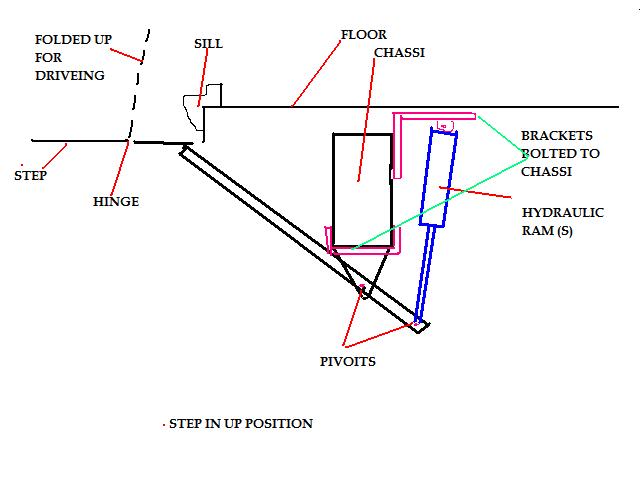

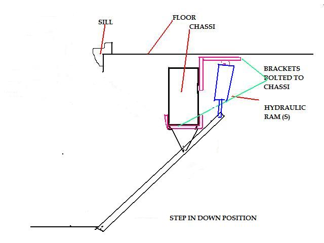

i'm looking for advice on how to do the following, i need to make a side step for the passenger side so my mrs can get in and out easier, she's finding it increaseingly difficult and i know the next thing will be "you'll have to get rid of the surf and get something i can get in" so to avoid this i was thinking about an extended hinged step thats possibly opperated by a simple up and down buttons on a hand held unit, first thing that came to mind was an hydraulic method but if anyone has another idea i'd be glad to hear, obvisiouly as cheap as poss, forgive the "drawings" but it should give ya some idea of what i had in mind, it's a cross section looking forward from astern of the pass door, would it be powerfull enough to lift a person (but not fire her over the top of the truck) what would i need and where's the best place to look for prices/parts etc, i thought possibly two rams spaced evenly along the step which has to be slightly shorter than the door, any help/advice apprecieated, ta, ian

I have a cut down surf step trev, but she still has probs, (parkinsons, arthritis, etc) what i need is summat that lower's to the ground, she steps on and can raise it till she's able to sit, i can then fold it up and lock it in position for driveing, i could go to a mobility place and have it don but those bleeder will want a couple of grand,

Edit: I know you'd prefer something chassis mounted, but there's no easy or cheap way to achieve that. As soon as you start with pneumatics or hydraulics, you're in for a world of pain and expense.Last edited by MattF; 9 March 2008, 17:28.
Know what you mean Matt, thought i'd ask tho, as it is i have to help lift her in by her arse, bl00dy comicle at times, if this idea falls flat i might try a second flip over step sort of thing, (or a trolly jack)Too young to die and too old to give a toss

Could you get somthing like this made up that pulled out from under or instead of the side step then you unfold the hindge to create a ramp to walk up ?

No matt, had'nt thought of that, sounds like a good idea mate, something i could slide out, then unfold, or drop down with some treads on it, come to think of it when i was working at the coach builders they did a similar pull out ramp for wheel chair users,before they made the "easy access" busses,
thanks for the drawing madcampbell, summat like that with treads fitted otherwise she'll go skidding down there,

Concertina would seem to be a better term for what I was meaning. Here's a loft ladder with the type of design I was thinking of:
