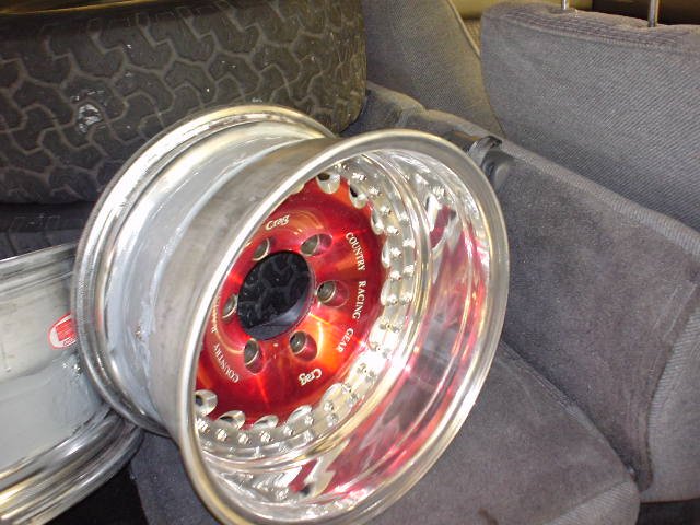

No reason you cant do both, tho you'll need some arch extensions, i reversed the rims on my three peice splits and the tyres are sticking out about an inch, thats after removeing the spacers, (thought about em with the spacers as well, but a bit too much stick out i think)
