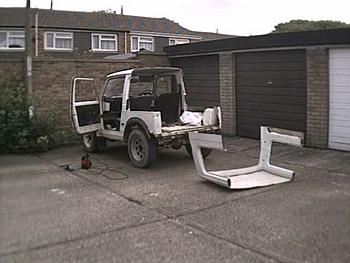

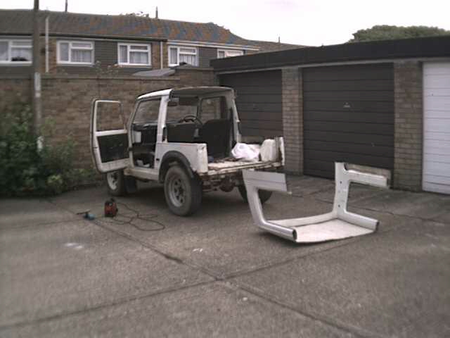

    There was no rain this lunchtime and no chance of being elctrocuted, while wielding the angle grinder. So...................
    It's only a hobby!
    Try the doors now . They will not fit properly . Me and Jotto found that one out after the same was done to ours. You need to brace across the roof with the doors shut and test the closing .
    If you had a pick up SJ or soft top they have a stronger frame over the roof .
        Rick
        if you strap them to a trailer too tight the windows won't close properly either!... oops, sorry dave!

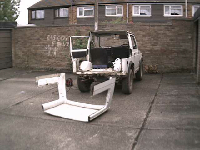

          nice, but why did you spray disco fever on the wall? Looks nothing like a discover.....
          ....I'll go back upstairs then shall I?
            My ex-neighbours son, now in his 30's, admits to daubing Disco Fever on that wall. He thought it was so cool in 197?
