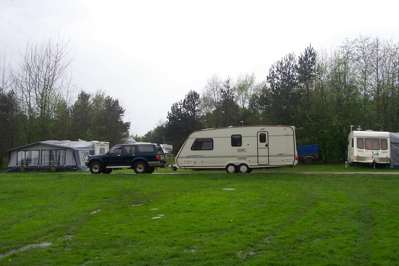

          • Best tow car i have ever had a bit bouncy at first but with uprated rear springs and pro-comp gas shocks its brill. The 3.0d engine just loves it she will keep up with any line of traffic and mine is a big van!http://www.yotasurf.co.uk/forums/att...id=11923&stc=1

                                My 2.4 has pulled a similar weight a twin axle ABBEY SPECTRUM you can tow upto 100% only recomended for the well experienced caravan owner but as said a landcruiser probalby would be a better match. The 3.0 SURF will tow it but its upto you.
