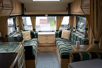

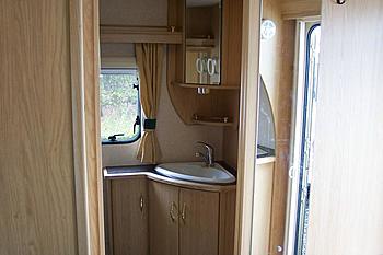

Looks like you have the same occasional table. Our cooker is on the opposite side. Bathroom cabinets and mirror look about the same. The only problem we have with ours is that the veneer is staring to bubble on some of the top lockers and one of the curtain pelmets has come un-stuck. I have tried double sided tape. The guy at the caravan centre reckons that the last resort is, "Silicon sealer, REPEAT, silicon sealer."Originally posted by markyWe found ABBEY to be very high spec & full of goodies so i got my ABBEY SPECTRUM Twin axle beast, A 5* hotel on wheels.
He rockons he told someone that and they used No More Nails
It's only a hobby!
this is a common problem with Abbey's (the pelmet) what we did was clean the plastic track and araldit glued (scuse spelling) some velcro strips along the track then my wifey stitched the other velcro onto the fabric to fit the one on the track and hey presto comes of and can be cleaned if neededif a politition is talking its lying
