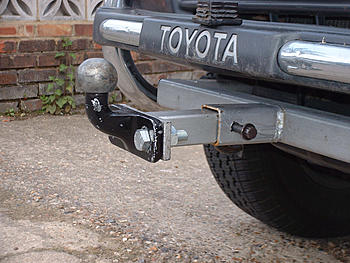

              I've been told it is easier to manovre a trailer with a front ball. Although I've been towing as long as I have been driving I've never tried it.
              I was wondering
              a) Is it true
              b) Where would I fit one (2nd gen 2.4 with factory A'bar)

              • RUBBLEBAGS geoff has done this mod & it looks ok

                  It makes positioning the caravan easy. You see where the caravan is and how your are doing with positioning it. You dont need anyone to help you.

                    This months Caravan Club Magazine has a reference to front tow bars. Apparantly they dont recommend them as there are no manufacturers figures for "Front loading" of vehicles.

                      • Its only for manouvering the caravan so weights would not be a problem, as long as the steel you are using + the bolts are up to it
