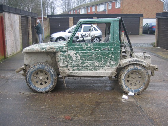

As you can see Arfur got well and truly muddied. The beast went well until I powered her out of the swamp, after waiting for two Rangys and a foreward control Landy to be recovered. I got to the top of the hill to a big round of applause only for the engine to die. The cheapy K&N copy filter I bought off eBay had allowed loads of muddy water into the air intake pipe and blocked the carb up!!!!! I set the tripometer when we got to the pit and we had done nearly 8 miles before the blocked carb.

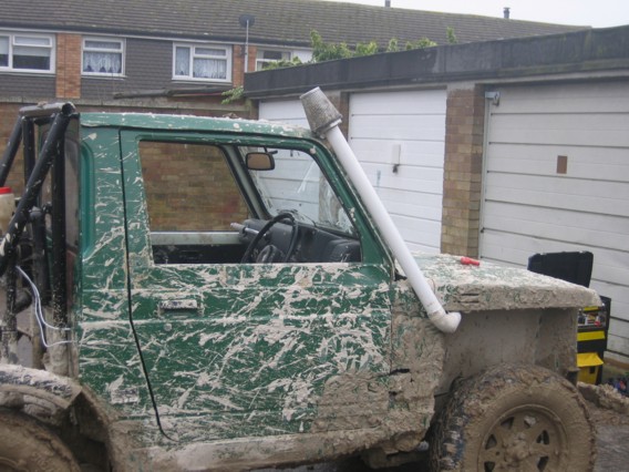

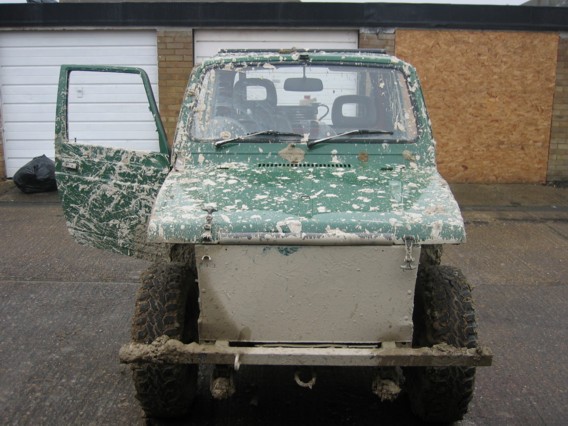

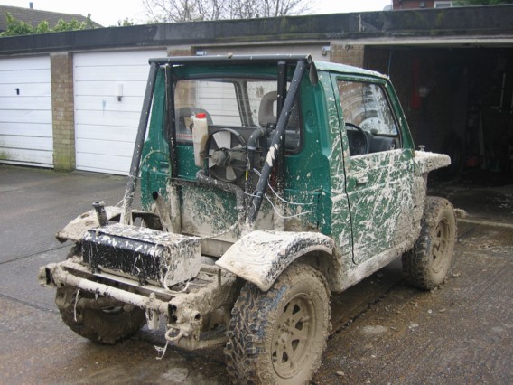

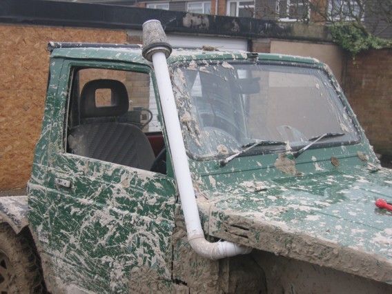

The snorkel was made and fitted this afternoon. Tomorrow we hope to shorten the front bumper, as it digs into the side of the ruts and weld up the A-Frame.
