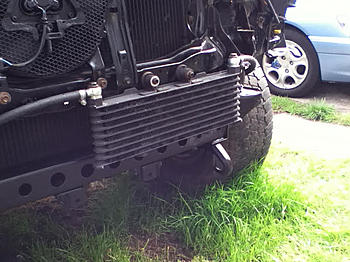

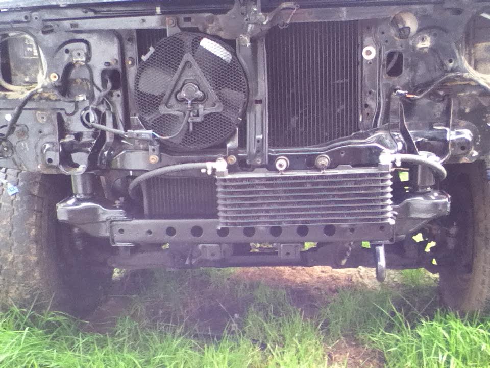

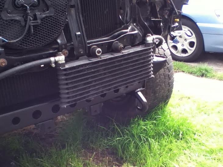

Not wanting to follow the crowd and fit the usual ebay flat panel up against the radiator I searched for something different.
Cue Suzuki GSX600 F cooler. £5.
It has M16 fittings for banjo hose adaptors , plenty big enough for the OEM 10mm hose.
Rubber mounted on the front beam and hose routed through the gap left by the 2" body lift, the hose is clamped to the steering pump solid lines and joins onto the original connections.
The hose was from Pirtek it is rated for continuous service at 100'C and intermittent 135'C , plenty of margin of safety.
