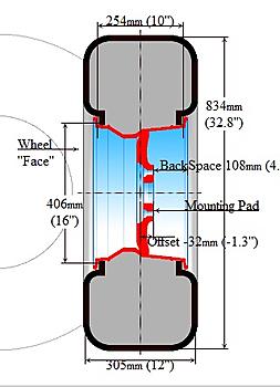

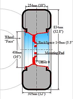

    Am about to order wheels and tires for the 3rd Gen.
    It will be 305/70/16s either MT Baja MTs or Cooper STTs
    The wheels will be steel mods in black 10" x 16"
    What I need to make sure though is which offset to go with.
    They come in -32 or 0
    I'm pretty sure the standard wheels are 0 offset on 8" yes?
    So if I get the -32 that would give 7mm MORE room on the inside of the wheel to the strut housing and extend an extra 57mm out of the arches.
    WIth the 0 offset I'll get 25mm LESS room on the inside of the wheel and extend an extra 25mm more out of the arches.
    I'm presuming the 0 offset will be better for me, but what will likely rub more? The inside or the arches?
    This will be on a 2" sus + 2" body lift

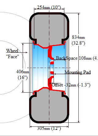

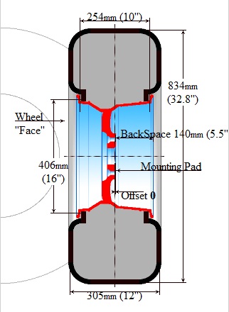

        But if the standard is -8 offset, then with the move from 8 to 10" width wheels, the -32 offset will equal 1mm less from tyre to truck and 49mm away from the truck under the arch.
        With the 0 offset it will equal 32mm less room from tyre to truck and 17mm away from the truck under the arch.
        According to : http://www.1010tires.com/WheelOffsetCalculator.asp
        But you're saying it's easier to sort out tyres too close to the truck rather than sticking out too wide yes? Hmmm
        The spacers (from roughtraxx) are 30mm anyway. So would cost £110 for the spacers to go back to -30 offset if I get the 0s. Grrr - all very confuzzing

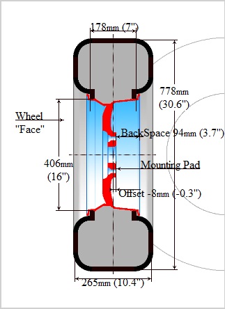

          Wow - you managed to completely ignore that standard 3rd gen wheels are 7" wide...
            Sorry - Just re-read that. I hadn't noticed - thanks for pointing out my stoopidiittty!

                These are the differences in dimensions in pics (helps me !)

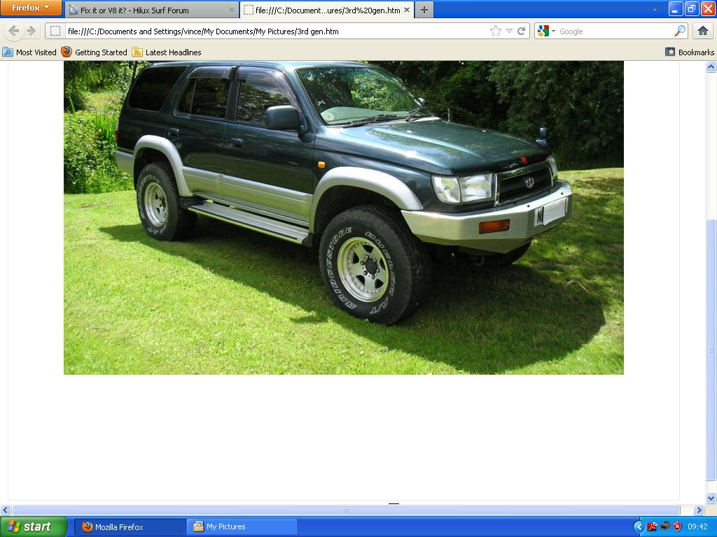

                            my bumper had to be cut and had to loose arch trim on them
                            thats with 2 inch suspension lifts and 1 1/2 inch body lift and 30mil spacers
                            will confirm tyre and offset of wheel later
                              Thanks - please do - also what width wheel!
