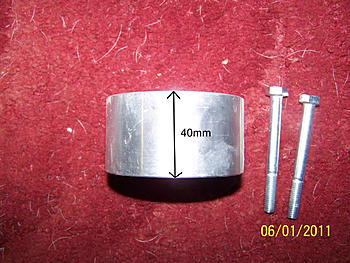

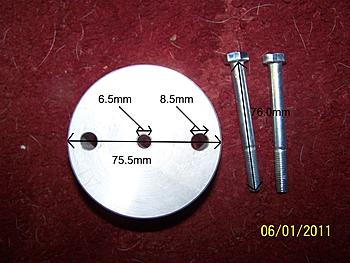

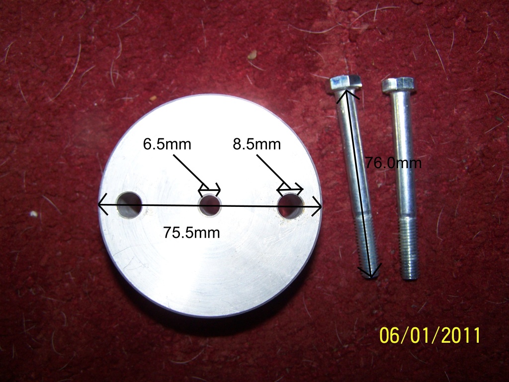

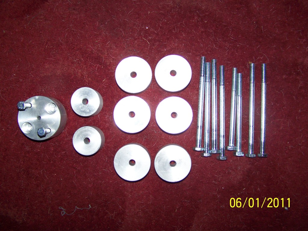

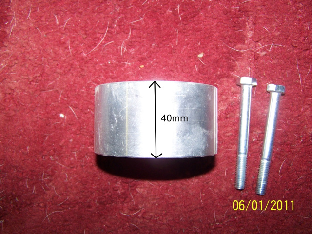

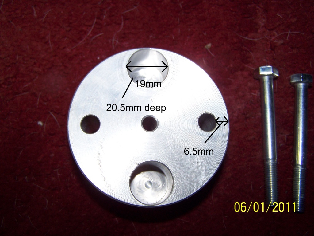

                Don't know if this is of any use to you Andy but thought I'd post it anyway.
                It's the milners kit and obviously not fitted yet so if you need any other measurements give me a shout.
                Neal
                • #23
                  Nice one!

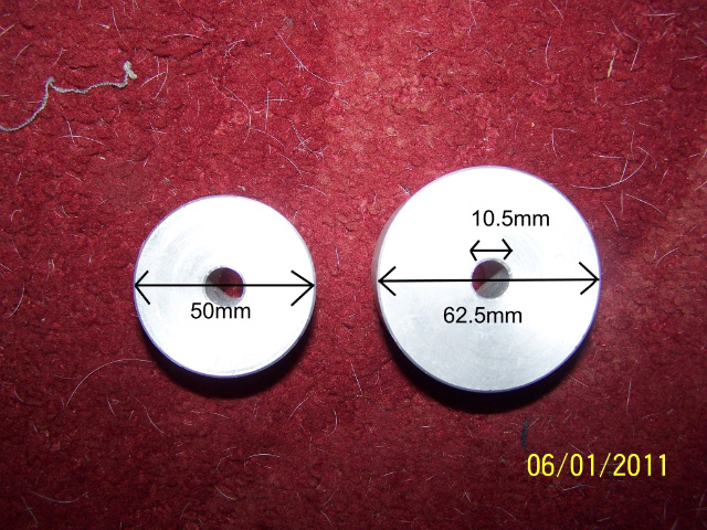

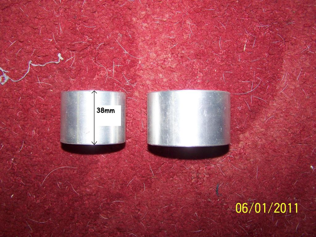

                  The two smaller bodylift blocks - a) why are they smaller and b) where do they go? Why are they different thickness to the others. I would have thought if you are lifting the body, all spacers need to be the same thickness.
                  • #24
                    Nice one!
                    Sorry mate, my fault, didn't say on the pics, the thicker one (with all the holes) is the steering spacer (I'm guessing it's thicker because of the spline adjustment on the steering it's self), all the body blocks are the same thickness, I haven't offered them up yet but i think the two smaller diameter ones are for the front just behind the bumper.
                    Neal
                    • #25
                      Nice one!
                      I havn't checked, but I guess they go at the front because of the different shaped (raised) chassis legs to allow the McPherson struts?
                      • #26
                        Yes, I was thinking that.
                        I'm using 50mm diameter for all body blocks too, but looks like I might have to find some larger diameter ally for the steering spacer...
                        • #27
                          My spacers were all the same size and I don't remember having any issues ???
