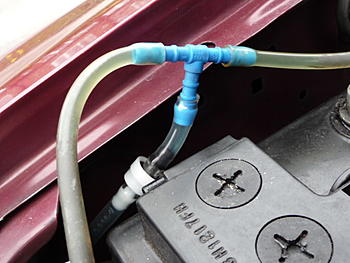

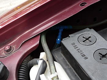

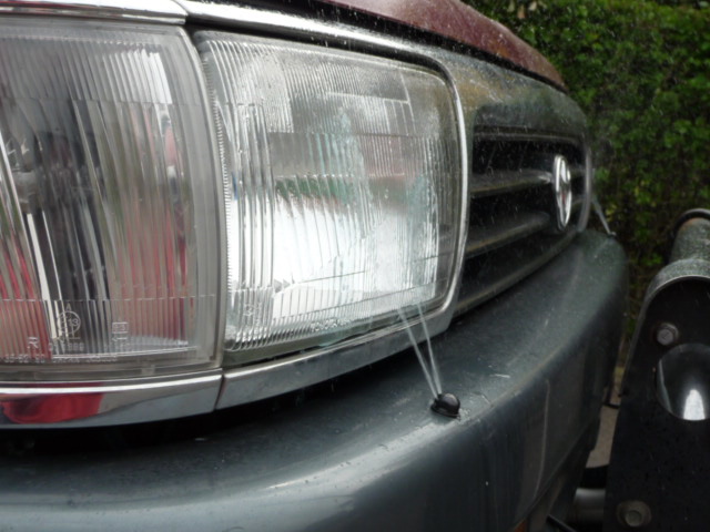

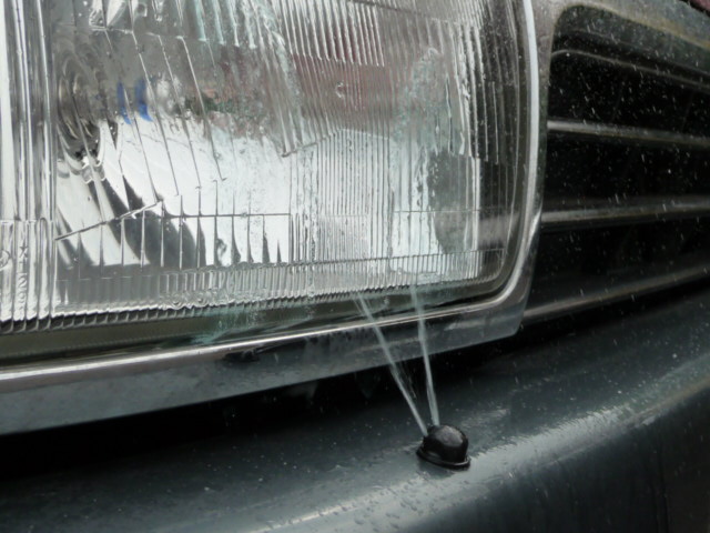

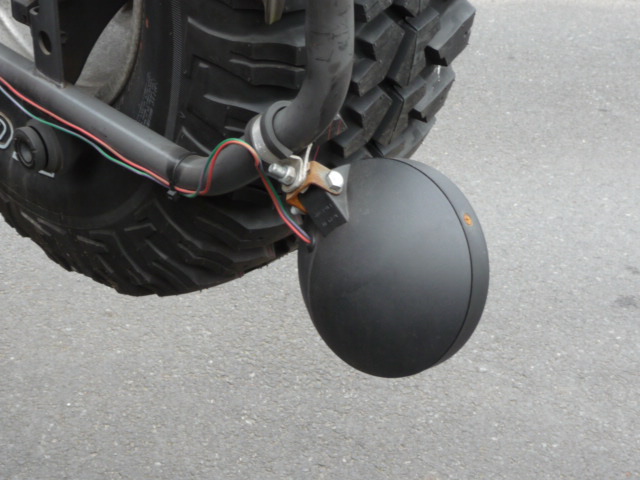

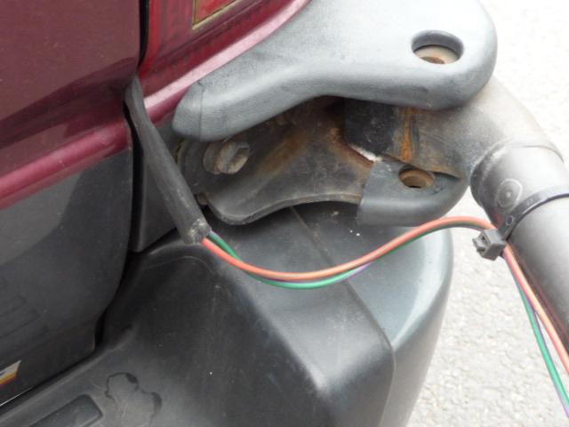

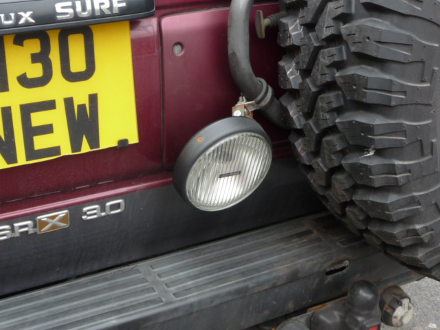

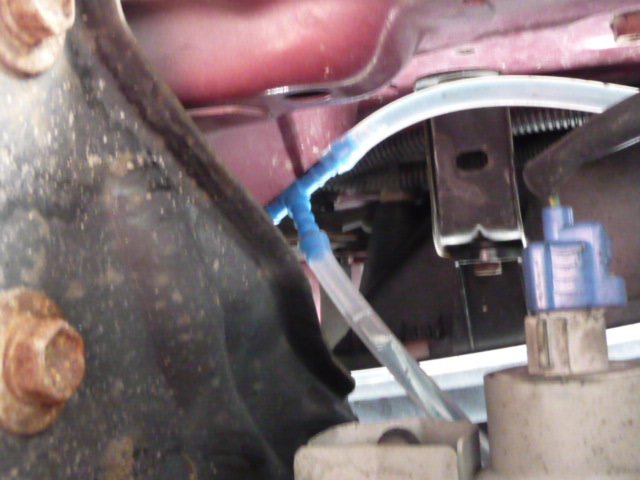

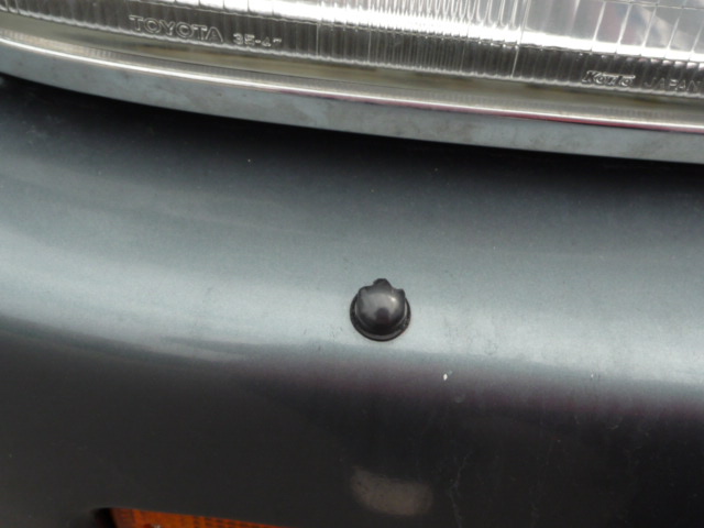

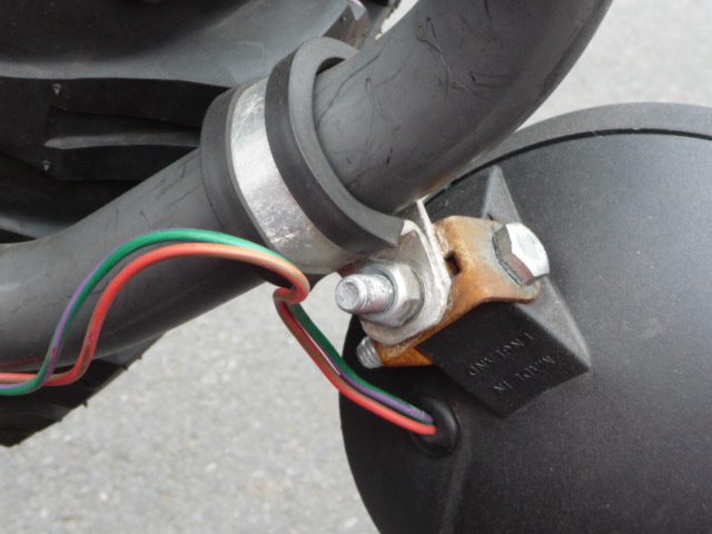

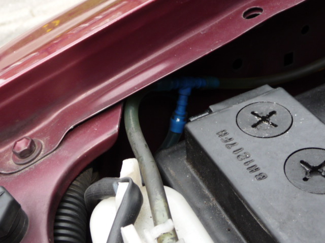

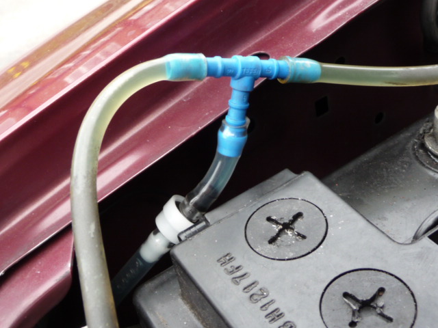

I know this is small stuff compared to what some guys do(S A S conversions, bobtailing, Lexus V8's etc ) , but Im quite pleased with these, and since I havent seen anyone else with the exact same mods, I thought Id share................The first is a H/D reversing light. Its mounted on the spare wheel frame with a 32mm "P" clip.Its fed from the reverse light wiring in the O/S cluster.(wiring should be sheathed, Ill do it when I get some). With the upgraded 130w H3 bulb, it illuminates really well...........The second is a headlight wash conversion. I know I could have set it up with a seperate switch and pump, but Ive been a bit lazy and tee'd it into the screenwash. Both wash at the same time. It only took two "T" pieces, a one way valve, some 6mm tubing and two washer jets drilled through the bumper Seems to work OK.....Hope the pics explain.....Cheers.....Mick.

Cheers, guys Since pics were taken, ive re done the wiring to the rev light , and run it through some heavy duty sheathing and held it with even more ty wraps. Its OK now...... The washer jets were just from halfrauds,(£ 3.75 each), but ive seen better (taller) ones since in a cataloge called Car Builder Solutions from N F Auto Developments. You can download it in PDF form.....Cheers....Mick.Last edited by MWS; 6 May 2010, 08:51." Time wounds all heels ".
