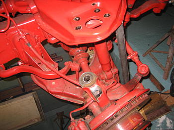

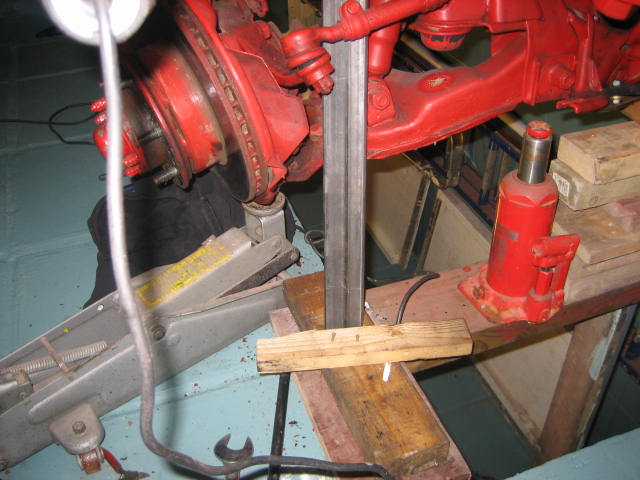

Remove the wheels and get a jack (found a trolly jack the best) and place it under the lower ball joint, jack it up till it just takes the weight of the truck from that side of the chassi jack, this means the top wishbone is now in the “under load” position (up at it’s normal height,

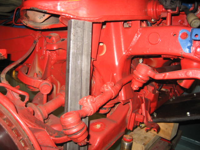

Get a nice flat block of wood and place on the deck in line with the front edges of the wishbones (or as near as poss) measure from the top of the block of wood to the underside of the top wishbone, I had a length of steel box section and cut it to this measurement, I then cut the head off a bolt and welded it to the box section,
This bit is now fitted under the top wishbone (the bolt goes in a hole already there, (drain hole I guess) and on the block of wood, I then nailed smaller blocks around the steel box to stop it slipping, the welded bolt at the top stops the top of it slipping, so you can work without the danger of it shooting off and doing your hands damage, this box section now keeps the top wishbone in the under load position, I found this way better than the “bit of wood jammed through the wishbone” method, all this makes it much easier to remove/refit the joint etc,
Hook out the split pin from the joint castle nut (having both wheels clear of the deck makes it easy to swing the steering to either lock so you can get at this nut and the others easier) remove the nut and lower the jack under the bottom joint and knock the control arm free, a couple of sharp smacks got mine off,

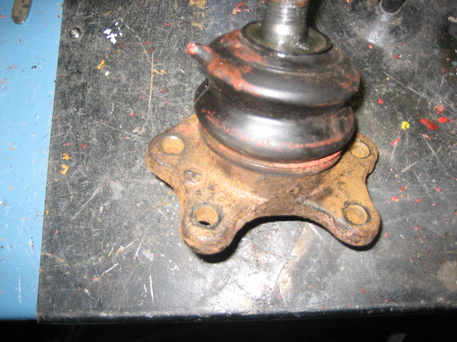

Undo the ball joint fixings from the top of the wishbone and tap the joint out, hold it accross the slightly open jaws of a vise and bang the old bolts out,

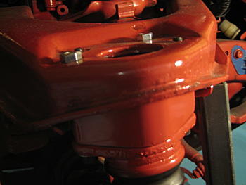

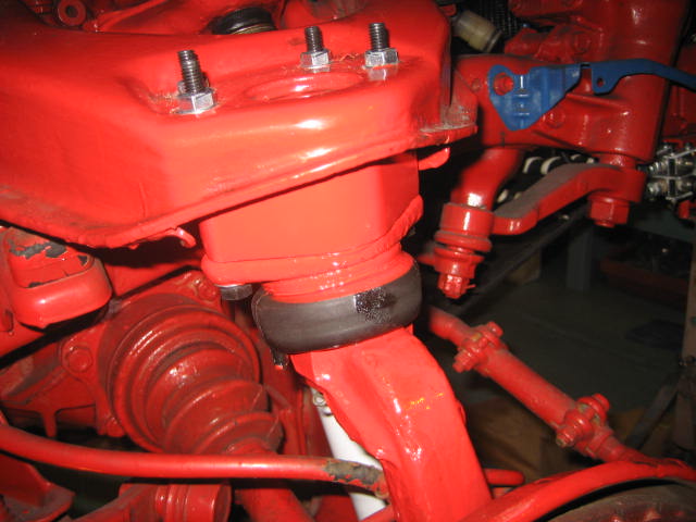

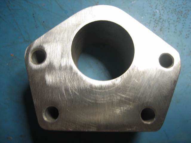

Place two of the new longer bolts through the spacer and offer it up under the wishbone and determine how much metal you’ll have to remove till it sits comfortabley in place, Trial and error here as you only want to grind off as much as you req,

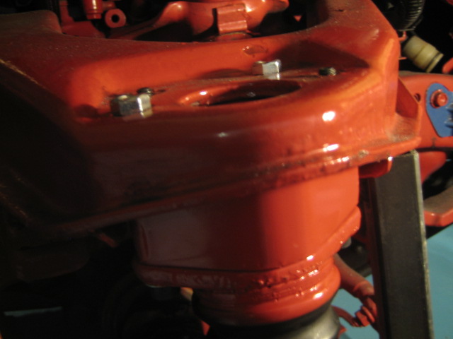

Once the spacer fits snugly remove it and fit the four new bolts through the ball joint and then fit the spacer on this and fit this assembly up through the wishbone and bolt in place,
Wriggle the control arm back into the taper as you jack up under the bottom joint and refit the castle nut, as tight as allows the hole and castle to line up for a new split pin,

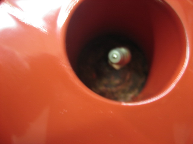

I should add that I replaced the angled grease nipple with a more upright one due to this now being down in the center hole of the spacer, just makes greaseing a bit easier,

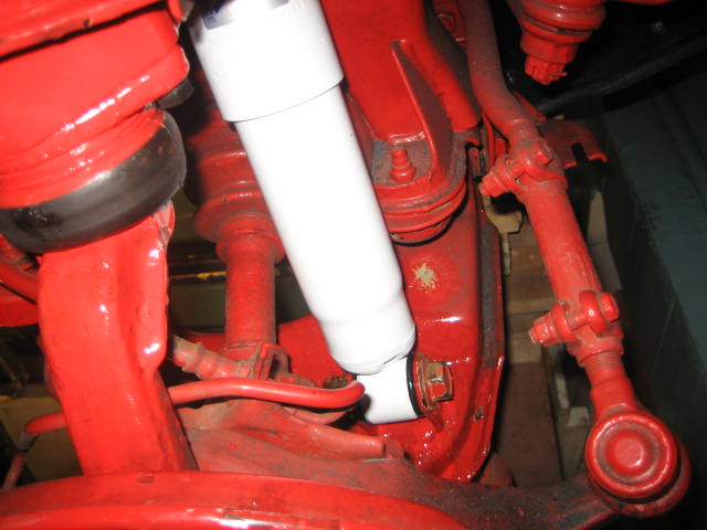

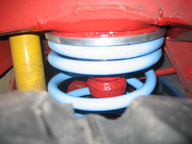

Fit your new shock absorber (+2”) and do it all over again on the other side,
Refit the wheels and jacks down, all done, get the camber/tracking re done soon as poss

Jack up the truck on the chassi till the front wheels are off the deck, (having loosened the nuts)
