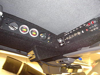

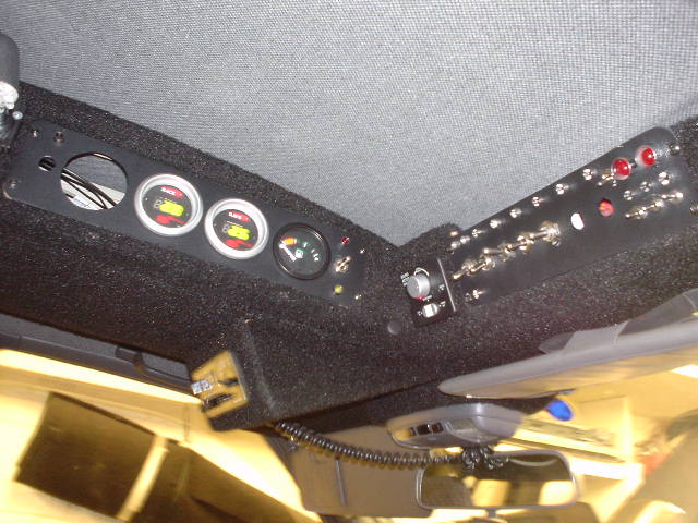

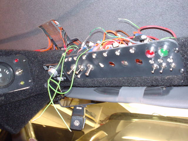

 Cheers Andy /Si, only posted these extra pic as "Joecuba" emailed me wanting info/pics on it, i dont have any measurements but if you want i'll rough measure it and let you know, but basicly you can do it yourselves very easily, all depends on how big you want yours to be, i just took a mearurement from door to door at the point i wanted the front to be, then from the center of that to the windscreen and also from the center to the roof lineing, accounting for the angle i wanted, then measurements at set points say every 2" from the center working out to each side to the screen and roof, mark all these as you go onto card and this will give you the rough curvature of the screen and the headliner, cut out the card and tape together and offer it up, you can trim the card till your happy with the fit/look and then similar measurements for the center bit, again as big/shape as you like, trans fer the card to ply and screw, glue it all together reinforse the edges with pine to stop the whole thing flapping and sand /plane smoothe edges etc, spray glue cloth, carpet, whatever covering you want on and fit as i did , big hinge at the front so you can drop it down easy, threaded rod or "big head" at the back (i fixed it to the long flat bar in the pics,) with a dome nut and two brackets at either ends and black screws to help support the ends, easy to drop down and fit stuff and run wireing to,
 only prob i have is banging my head on it but you soon learn to get in a certain way to avoid the pain Too young to die and too old to give a toss Too young to die and too old to give a toss
