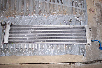

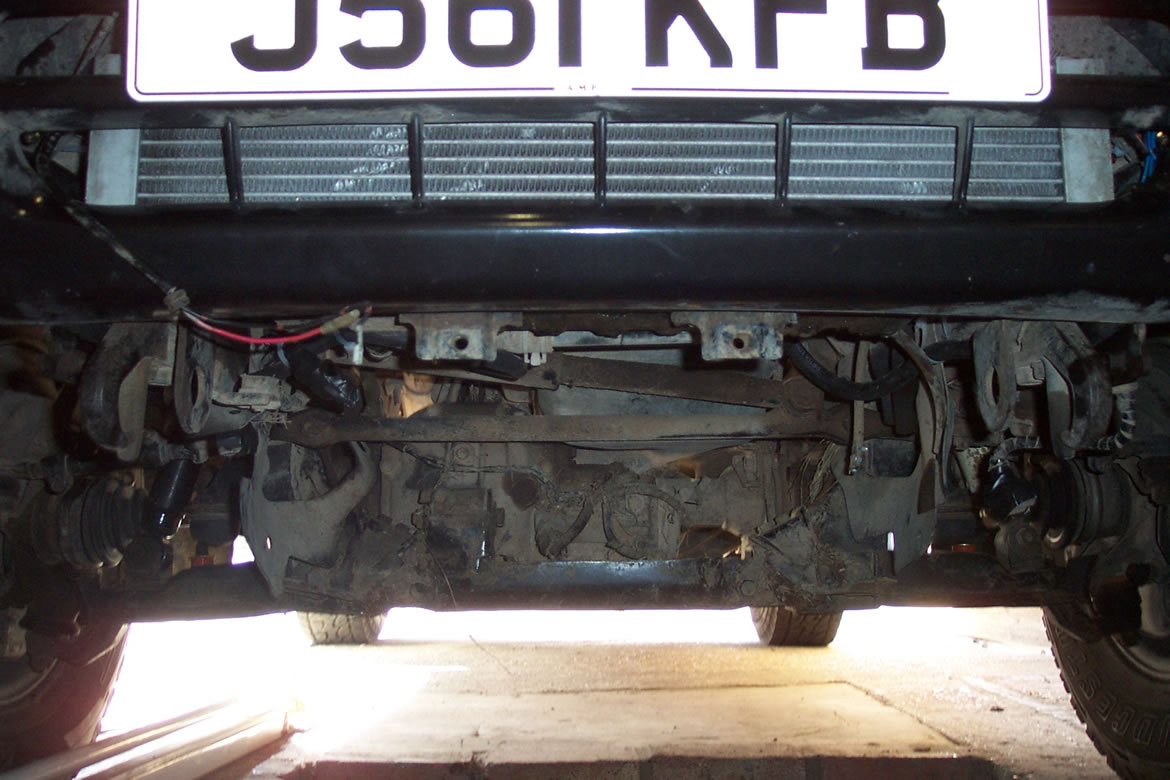

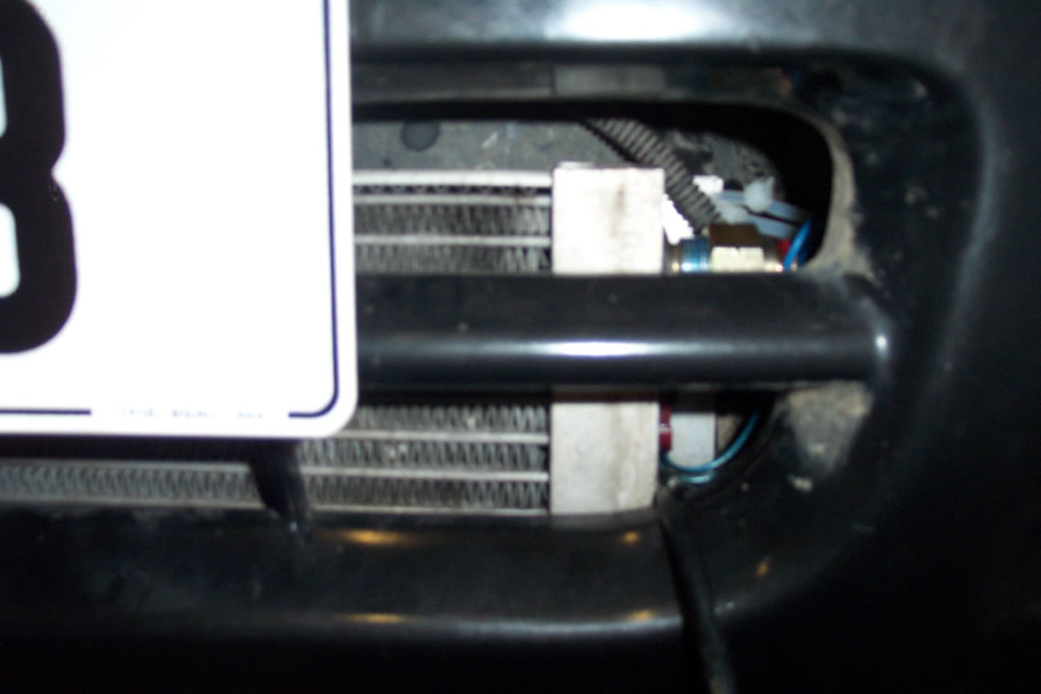

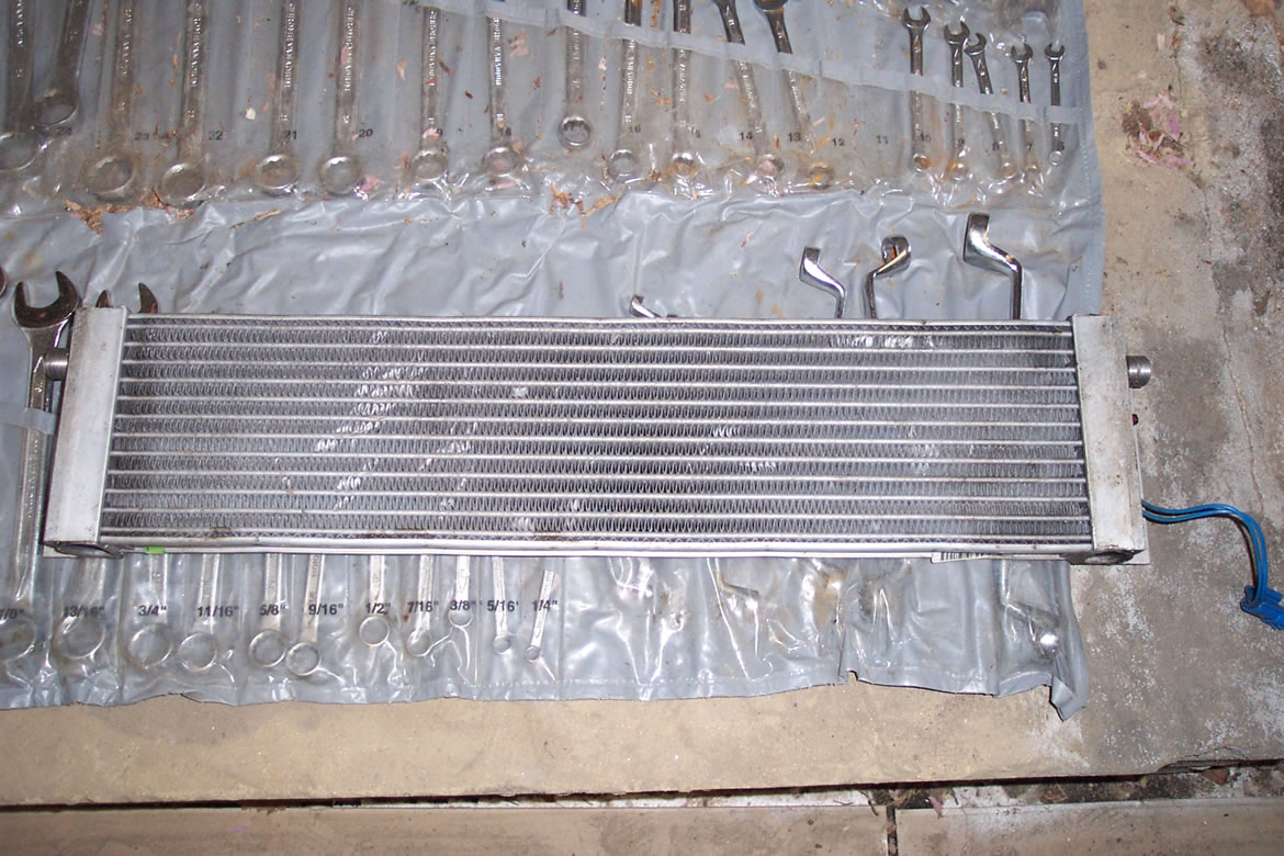

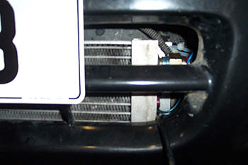

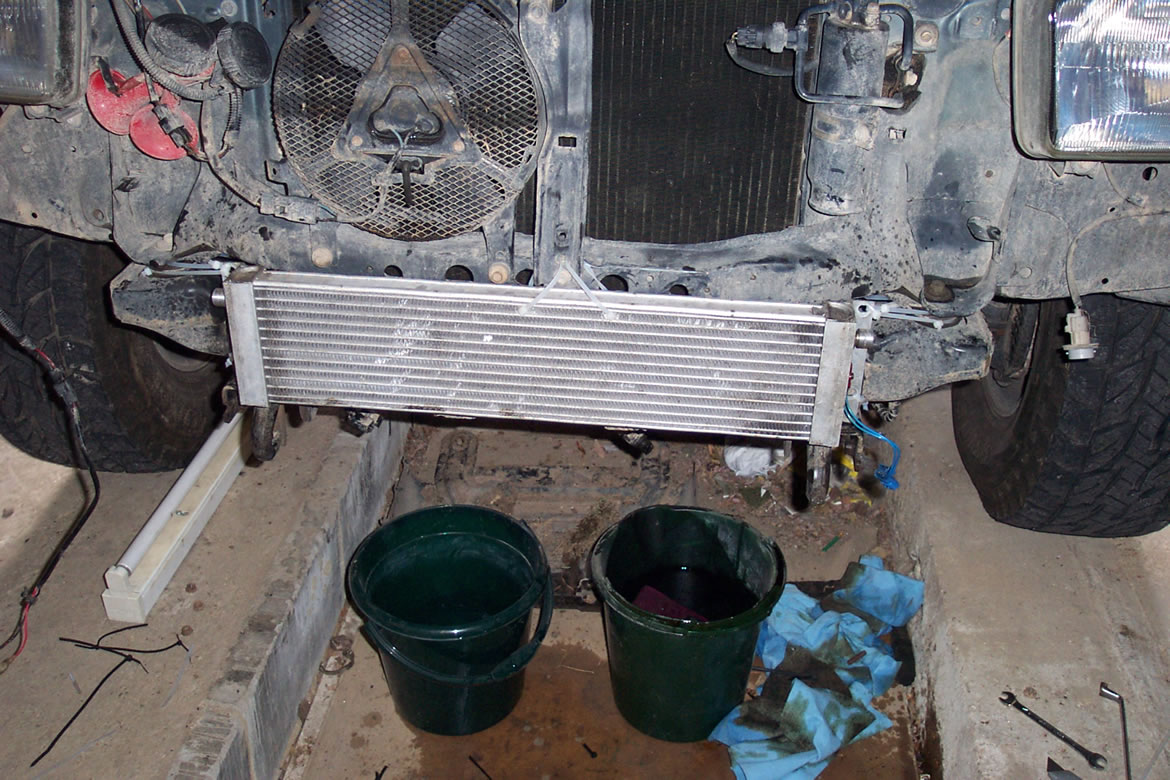

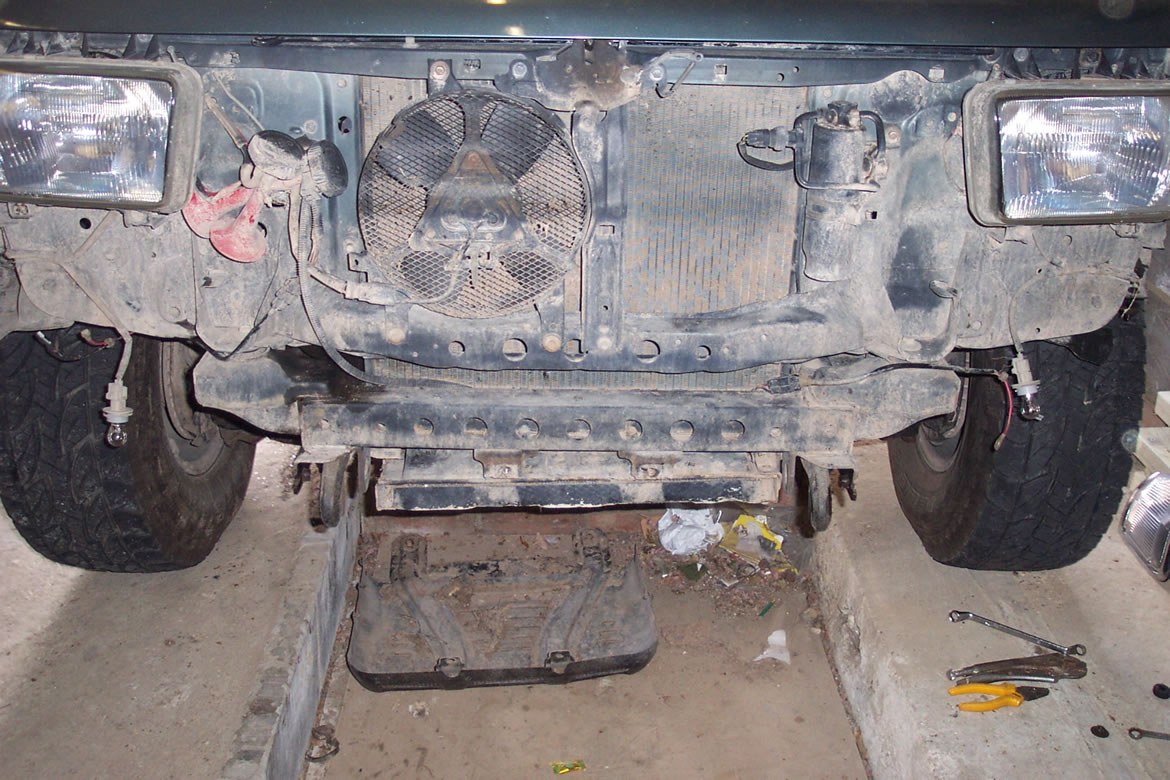

    Got round to fitting my oil cooler today - well chuffed with the results. Took a while including cleaning out all the salisbury mud from the rad and ditching the air con rad for the time being but all seems well
    Its a good fit
    @TonyN - its the pipe on the right mate and it missed the bucket by a mile!

        what oil cooler did you use? i will have do this very soon...
        it's in me shed, mate.
          Its a good fit
          that looks complicated????????
          CHEERS JOHN................
            its from a 1999 Range Rover V8 (i guess the 4.2). Fits a treat! Give a shout if you need a hand
            Tim
              cheers,i;ll probably need all the help i can get!

                Hi Tim hope you dont mind me asking what problems did you have to put a cooler on, as we have a Surf that comes in for servicing and he says when towing a trailer with 12 canoes on after about 20mins driving all the fluid get pumped out of the front seal on the gearbox. But on driving normal or even at 70mph with no trailer no problems.

                  Only just seen the post - no problems really to speak of but on a long hill at high revs the temp still can go up, i think the rad is still blocked but no probs recently.

                    tim did you fit that in line ? and are you running a standard stat
                    im off with caravan tomorrow and im going to try it with out a stat if it fails then its a cooler on order..

                      yes inline before the rad and i Havent touched the stat...

                        Do not run without a stat unless its an emergency, the stat regulates water flow through the rad, if you take it out, coolant flows to quick through the rad and doen't get get cooled properly, and the truck will overheat, especially at high revs when the pump is running fast.
                        A tranny cooler is usually the answer to high engine temps when towing, as when the tranny is working hard, the hot oil can reheat the coolant as it leaves the rad, so it re-enters the engine already hot, and just get hotter in the motor.
                        We did away with Jez's in-rad tranny cooler recently, fitted a manual rad and a B&M tranny cooler, and the engine runs about 10 deg cooler now when giving it stick or towing according to the temp I fitted for him after changing the head.
                        I'd either run a smaller aux cooler before the in-rad one, like I fitted for Predictable Bob'ss 3rd gen to lower temps a little before it enters the rad for peice of mind, or bypass the the rad completely and fit a dedicated stand alone cooler like the B&M Supercooler if your having serious trouble.
