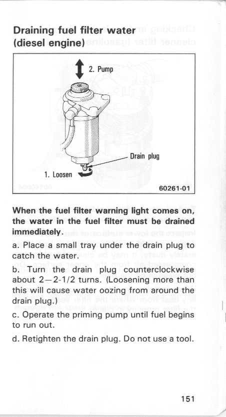

      Also ensure the drain tap at the bottom of the unit is tight.
        Here is a pic of the pump & its parts

          Its leaking anyway, try and strip the top of the fuel filter housing and pump to see if you have any split seals/o-rings etc.
