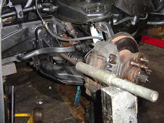

            Folks talk of using two 17mm spanners on the inner flange nuts but these were so tight they needed a socket and ratchet. See the image where it shows two extn bars together reaching through to the bolts.

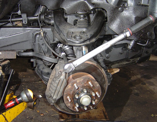

            I could see the inner boot would pass the shocker OK once the roll bar drop link was unbolted from the lower arm, rotated upwards...and that the roll bar was supported levered up an extra inch or two from its static position. See image for the bar and wood block arrangement.
            Did manage to get the shaft off but a right pig getting exactly the right angle of wishbone and steering hub.... then compressing the shaft to minimum length. The inner flange only just cleared the axle drive flange studs. In struggling to lever it all out the large end cap popped off the inner joint and it ended up a greasy struggle.
            So.... To replace the driveshaft I thought it better to split the lower hub balljoint to enable the hub to be pulled out for more clearance. This made the replacement loads easier and next time I would do that at the start of the job.
            See attached images.

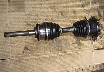

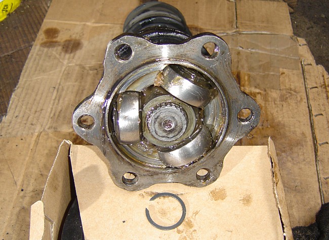

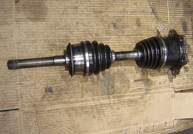

                Its held on with one snap ring. Hold the shaft in your hand and hit the CV with a dead blow hammer on the face of the largest diameter and it will fall off, probably landing on your foot.
                Ebay search item 230357761354 !
                  You can stuff a rag into one end of a suitable pipe (to prevent damage to splined end of shaft) remove the tri-bearing (a circlip) from stub axle end of driveshaft and then put shaft into pipe and bang on a hard surface. the circlip for CV joint may break, just make sure you still have it on shaft or retrieve it from inside CV joint.
                  Most of the time it's cheaper to buy a complete driveshaft from a scrapper than buy a new CV joint.
