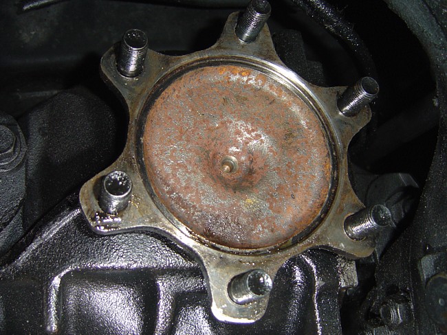

                  Just to round this off I've changed the driveshaft gaiters (going to post on Jims thread about that) this weekend so had the shaft off and a chance to wobble the offside axle flange.
                  I've proved it is no different with the axle solenoid engaged or not.
                  The play is excessive, in and out plus rocking...wobbly is the best word.
                  However it drives smothly in 2WD or 4WD with no noise or vibration. Given the cost/hassle of taking the diff out I think it is one to monitor.
                  Plenty more priority jobs before that!
                  Image shows the flange with the driveshaft off.
                  David
