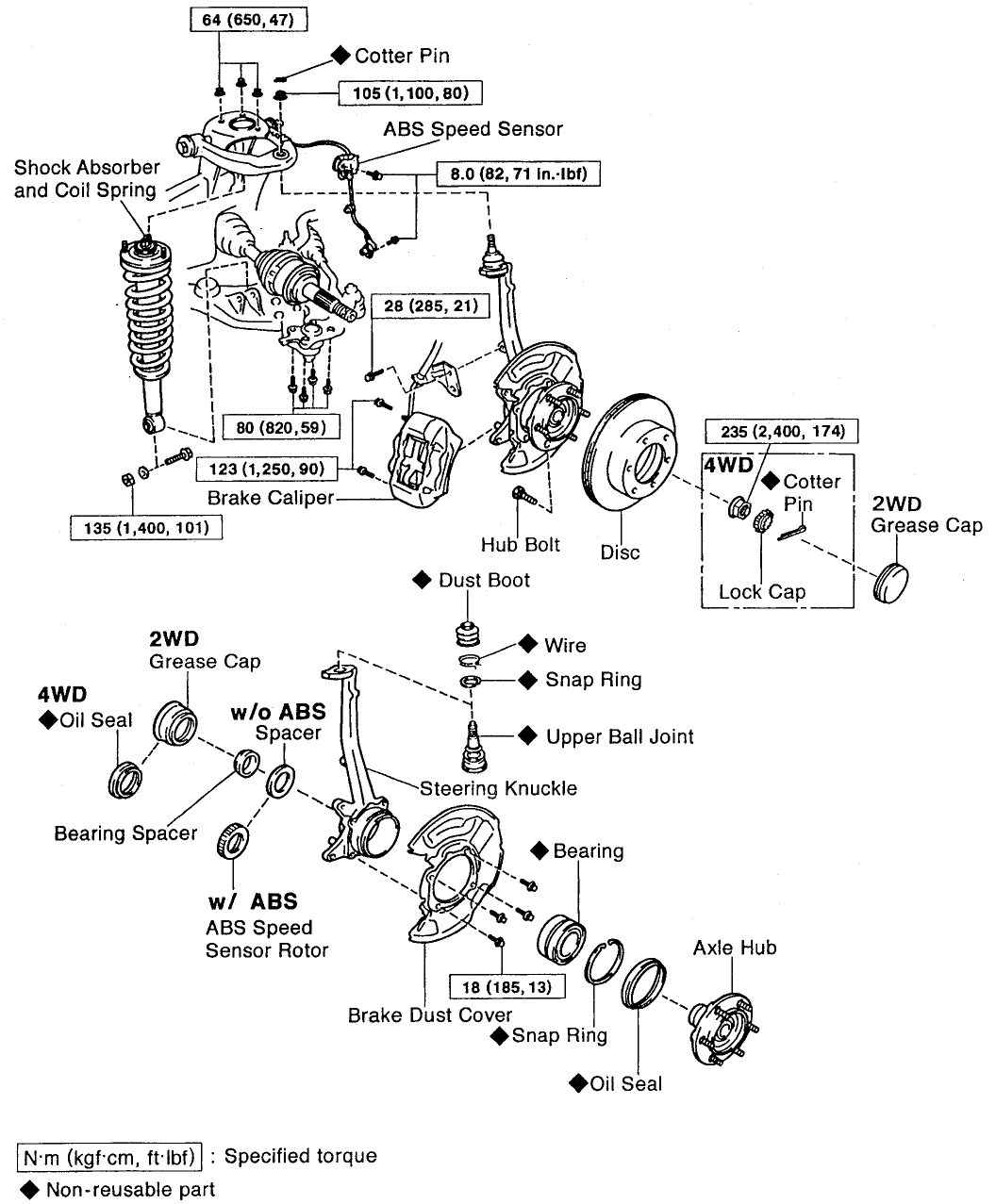

    Diagram below should help as well.........

            Looking at the exploded diagram the whole assembly is pushed out from the rear of the steering knuckle. Or does the grease cap and seal need to come out first?
            Is the ABS ring also a tight fit over the axle hub.
              Not sure about the grease cap, seal and ABS ring but when removing the bearing and hub the usual process is to press out hub first from the back then remove the snap ring and do the bearing. New bearing is then installed, snap ring refitted and then hub pressed in. That's the way I have done this type of bearing before.
              Warning: If hub is really seized in the bearing then it's always possible for the steering knuckle to break at the groove for the snap ring.
              Nev.

                  Steering knucle replaced with new ball joints. Can anyone confirm the torque settings for top bottom joknts and the hub nut please. I found 80 for top 90 for bottom and 120 for hub. lb/ft.
                  Thanks.
                    Thanks.
                    They're on the diagram Vince posted ^
                      No one listens to me.
                        Some of us do Vince.
                          So they are. Missed them!! Noticed the bottom joint torque not on there so did it a little tighter than the top joint.
                          Thankyou.
