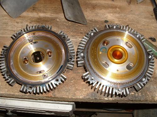

There are a couple of piccies on the site somewhere that show the inside of the viscous coupling if you search and re-post the piccies i will explain how to adjust.

Once all the screws are out the two halves of the unit will rotate and should lift apart. Mine needed a little help from a Stanley Knife to break the seal between the two halves. Apart, it looks like the photo Marky supplied. Mine had very little oil left and what there was was very thick. You'll need to clean out all the old oil first. I used liberal doses of WD40 and then cleaned as much as possible with a dry cloth. The new oil was then added to the bottom half and the top half refitted.

Originally posted by markyGot one pic
First you need to assess the state of the silicone fluid, if it is golden in colour and runny it should be ok to be left in but i always add half a tube of 3000 grade silicone fluid. If it is dark and thick and sticky you should clean it all out of both sides with brake cleaner ( make sure you get it all out ). Then you can adjust the temperature strip so the fan comes in a little earlier. The half of the coupling shown on the left of the picture has 2 slots with 2 pozidrive screws, usually the screws are at one side of the slot as per the piccie, undo the screws ( carefully with a good fitting screw driver or impact driver because the screws are delicate ) then lever the screws round in the slots so they end up approx in the middle of the slots and tighten the screws. If you have cleaned out the old fluid then refill with 2.5 tubes of silicone fluid 1 tube for each side and re-assemble the coupling.
Cheers Steve
