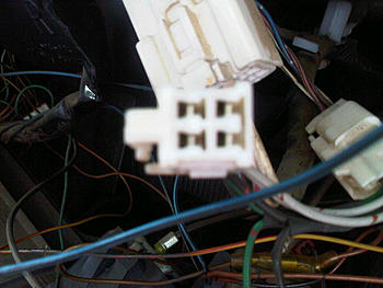

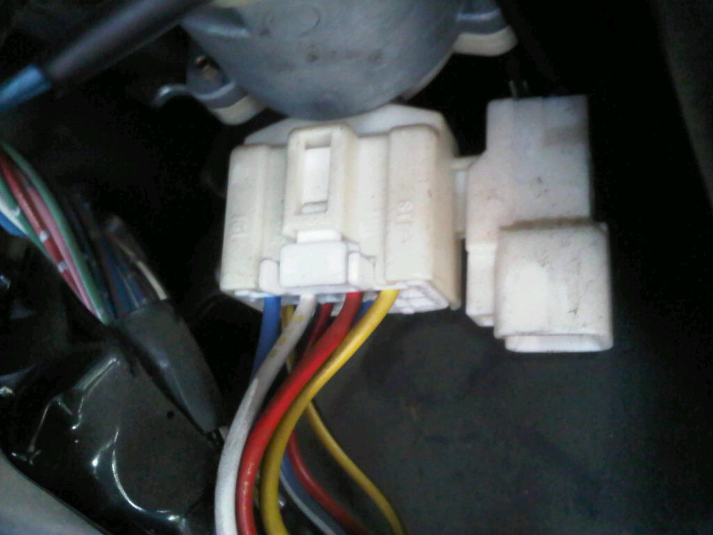

                        Thought i would post a couple of pics in case anyone gets caught in the same predicament.
                        The socket has been disconnected from the smaller plug, on the right, at the back of the ignition barrel
