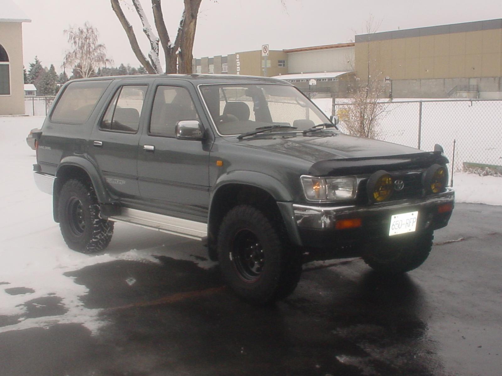

Glad you're all sorted and that you didn't follow my advice! Thought you'd eliminated the TPS though! Fingers crossed for a winter of trouble free Surfing for you. Don't forget to post us some pictures!

update: surf runs great, still have an issue with the cold starts, -20* starts very smooth no caughing or spitting, +25* no problem, anything in between runs rough,i have been reading for months and playing with the surf in order to locate the issue, i have 2 conclusions
1) while 10.5 vots at plugs runs smooth, when 6.5 volts runs rough,thought i could do a superglow system, is there a way to reverse the solenoids so the 10.5 volts would be secondary while the engine runs?
2) injection pump timing need to be advanced slightly, keep in mind my idle is at 500 rpm kinda low, figure this might work due to what i have read?
anyways i could use some help here, there must be some info on this somewhere?
