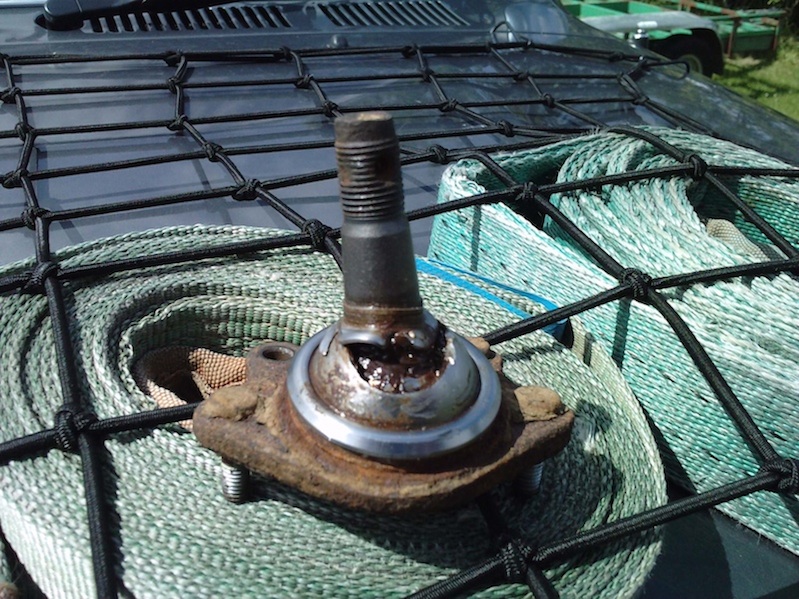

New top ball joint fitted.
Rebuild is the opposite of above. IMPORTANT! remember to fit the snap ring to the new top joints and the rubber sealing ring to the boot.
I removed the brake pads prior to rebuild and cleaned and copper slipped pad backs and pins. I then re-mounted the callipers prior to refitting pads
Various pics of strip down.
