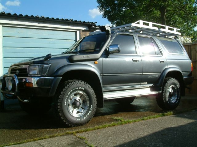

                    Got an after photo.Currently measures 13 1/2" rim to bottom edge of wheel arch front and rear....
                    It didn't look too bad before. It was just almost riding on the bumpstops front and rear. There is now a moderate crease in the handbrake tube on the drivers side (torsion bar adjuster bracket).
                    AndyL
                      It looks the MUTZ now mate. nice snorkel

                              Ha! Now you have it. Thats one mean MF of a roof rack you have on there dude. Must weigh quite a bit! If you gor for spacers front and rear, you're gonna have to get bigger shoes, cause those 31's will look very silly in there! Looks great, love the snorkle. Do you have a part no for it? pls
