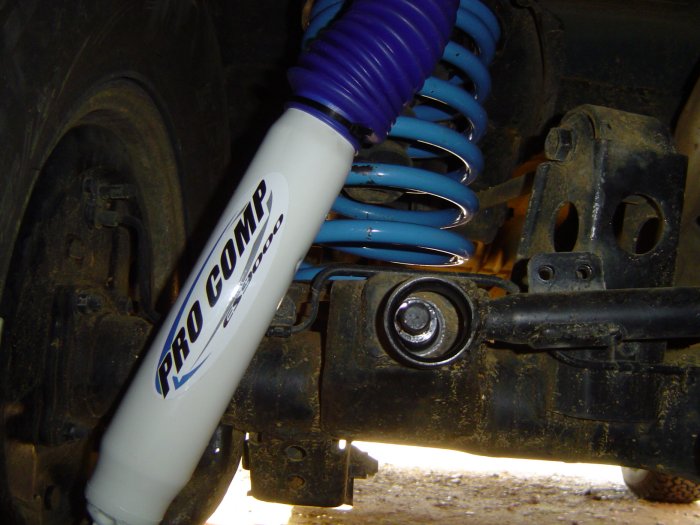

                      Took this pic doing Monkeys truck, with +2" rear coils, the bracket is this far out.
                      Easily pops in with someone leaning on the car, the axle 4 link brakets probably vary by more than at manufacture.
                      Easy to cut and sleeve the rod if it bothers you, But I'd still rather lower the chassis end bracket to get the panhard rod back to the correct angle than alter the rod itself, may try it with Lindas truck one day. Interesting to note that Linda's lifted truck was slightly lower than Monkey's with its fresh springs, so they settle a little, reducing the misalignment even more.

                        yeah my OME springs have settled 1/2 inch now, but that has still given me 2 1/2 inch lift!
                        I'll post some pics of the drop bracket when It's been fitted!

                          Mine hasn't moved laterally from what i can see..... although my rear springs were not apparently sided and my truck sits slightly higher on one side now!
                          Time to lift the rear again and swap them i think! Ah well - at least it wasn't those damn coil-overs, what a nightmare getting those back under the arches!!
                          My panhard has barely moved if at all and i drew the geometry out in Autocad which indicated naff all geometry change - a matter of mill!
                          I guess if you actually undo the panhard then you will get a shift / settlement in all links, perhaps making the shift shown on the photo...?
