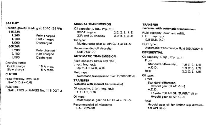

    Was about to change my transfer case oil (2.4 auto 1993) and looking it up seems most people are using GL4 or 5 SAE 75W-90 gear oil...
    However, in the surf owners manual I downloaded it says to use auto box fluid dexron II.
    So what are people using ?

      I looked that sticky up before I posted my question. It says to use gear oil. The Toyota manual says that autobox transfer cases use ATF fluid, and the manual box transfer case uses gear oil. Hence my question.
      Maybe it's a misprint in the owners manual ?
      Rob.

          Ok so from what I can gather through searches it is only the A340H gearbox that has a transfer case that takes dexron II auto fluids. The manual I have must be for a surf with an A340H gearbox.
          My gearbox is an A343 so I'm assuming it will be the usual gear oil.
