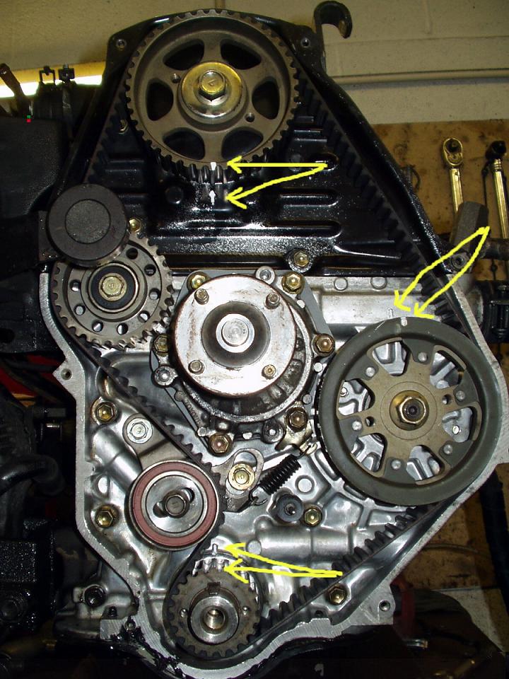

                    Are you sure the cam is timed correctly, not 180 out?
                    the cam lobes on No1 should be pointing up and the
                    lobes on No4 pointng down all these are at TDC. on No1.
                    timing mark positions below.
                    Crank @12.00 O'clock
                    Cam @06.00 O'clock
                    Pump @ 12.00 O'clock

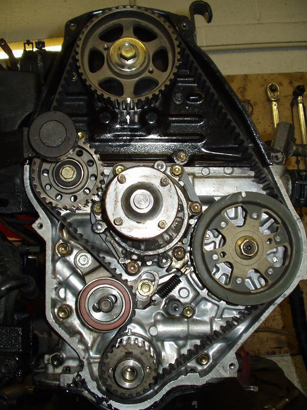

                        2nd GEN TIMING

                          Originally posted by chubbs View Post
                          I will check before I go any further. Which is number 1? Is it the lobe nearest the front?
                          Cylinder No1 is at the front of engine.
                          the lobes are the sort of pointy things
                          on the cam shaft above that cylinder,
                          and BOTH should be either side of upright
                          sort of like a letter "Y" with the timing
                          marks aligned on the sprocket and plate.
                          hope this makes sense.
                          Gman
