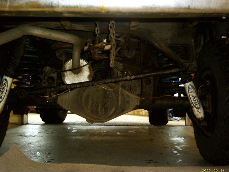

              ok , i need help.
              gave the truck to local trusted spanner to fit drop bracket. says that he
              would have to burn it off bacause it was solid, which would damage the bush.
              had a go myself and yip, got nut off bolt, tryed to hit bolt through with
              sledge hammer with no joy, it was starting to bend the part of the chassis that it is attached to.

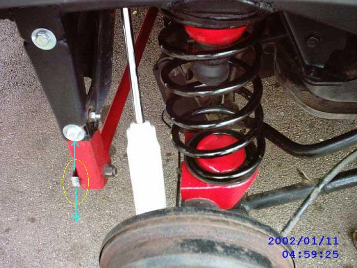

                Do you mean the bush that's ringed in the pic?
                  yip thats the one bushwhacker.
                  as you can see it is badly needing droped
                    Right then, have you tried bending the locking tab on the end of the bolt, flat and knocking it up and down to try and rotate it to loosen it. Thats what I did on mine using plenty of WD40. Once it can turn, it should be able to be knocked through the bush.
                      This the tab, bend it flat and knock it with a hammer in the direction of the arrows to loosen.
                        tanks mate,will give that a try.
