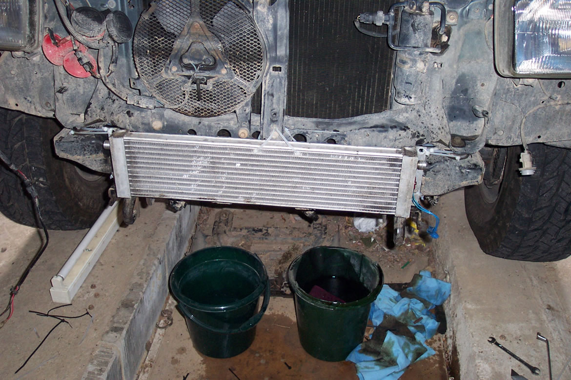

We fitted a tranny cooler to Predictable Bobs truck yesterday. Snapped a few pics if anyone's interested.
Where it lives, to line up with the lower grill in the bumper...
other side, showing mount...
the end sections on the standard bumpers lower grill are filled in, so I broke out the Dremel.....
and cut them out, it looks nice and original still...
finally, fitted and bumper installed...
As you can see, it hardly blocks the other rads at all, and its the right size so the whole cooler is in air flow through the bumper cut out.
