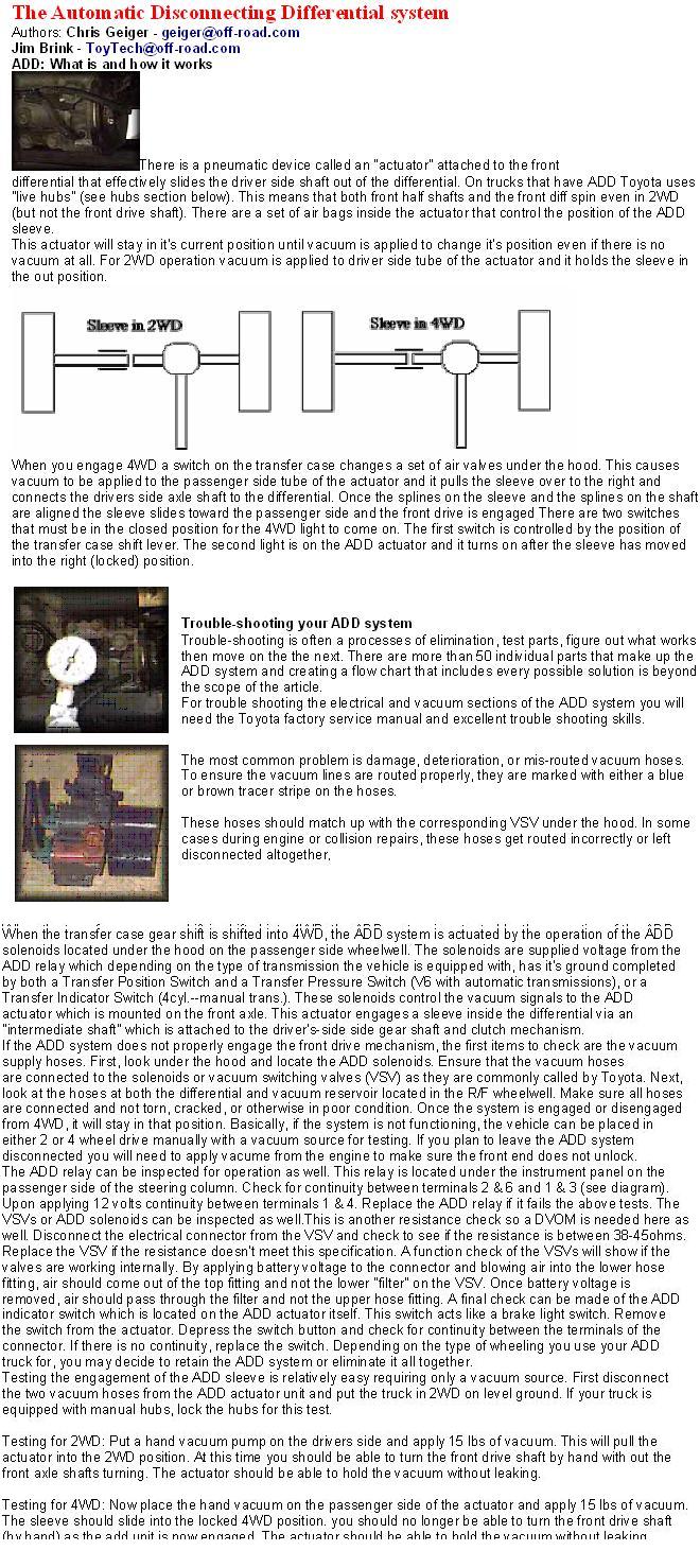

i'm pretty sure everyone is tired of hearing this problem, but i cannot engage my 4wd on my hilux. it doesn't work on 4hi or 4lo. when i shift the lever i hear no clicking and i see no light on the dash. i've looked underneath and noticed that the shaft leading into the front diff does turn, but it just refuses to engage. i've checked some of the vaccuum lines but saw no defects, as far as the solenoids go i can't determine whether they are good or bad. the only thing i can think of is a fuse, but where are they located?

Have a look at the attachment below - it should help you.Originally posted by chavoi'm pretty sure everyone is tired of hearing this problem, but i cannot engage my 4wd on my hilux. it doesn't work on 4hi or 4lo. when i shift the lever i hear no clicking and i see no light on the dash. i've looked underneath and noticed that the shaft leading into the front diff does turn, but it just refuses to engage. i've checked some of the vaccuum lines but saw no defects, as far as the solenoids go i can't determine whether they are good or bad. the only thing i can think of is a fuse, but where are they located?
(Sorry about the poor quality - had to reduce it in order to post it to Forum)
