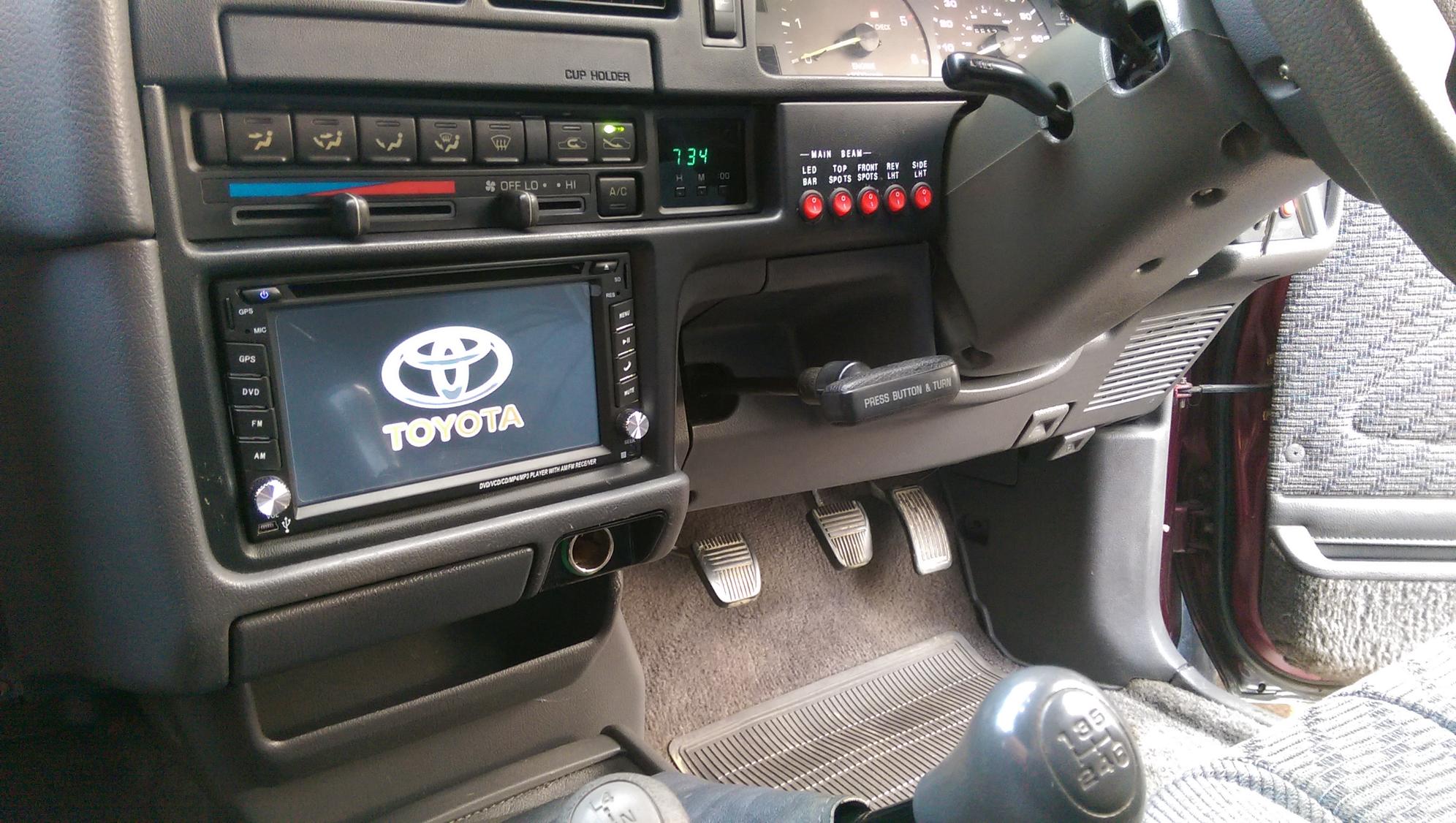

                        Bit of a thread revival I know, but I bought a cheapo double din satnav stereo from ebay (£107) at the time, and it fits perfectly.
                        Lines up using the original bracket, and the wiring colours also match the original Toyota loom (for the most part). Has the necessary outputs for the rear speaker amps as well. Bluetooth, SatNav (GPS) and reversing camera. I am still debating with myself where I will fit the reversing camera.......
                        (the link below does not have the software - think it is a bit extra, but I already had the software)
                        Looks good and fits in the original hole.... it didn't look like the hole in the dash lower trim was quite big enough, but it will squeeze over the bezel of the stereo with a little gentle persuasion.
                        Very pleased, although I now have no cubby!
                        Here is the sellers link: http://www.ebay.co.uk/itm/2617439673...%3AMEBIDX%3AIT
                        After sales service is a bit rubbish if you need help fitting it (which I did as there is no wiring diagram in the manual - until I realised it is printed on top of the unit - Doh!), but the product is good.

                          Thank you . I've actually been thinking of getting a double din seem as my single din is slowly packing up so I may actually have to grab that one .
                            Yeah, that was my thinking as well, my single din was busy refusing to either play or give back any CD it was offered, and the front panel was a bit iffy so would go off over bumps. £50-£70 for a single din or a bit more for this....... So decided to go for it.
