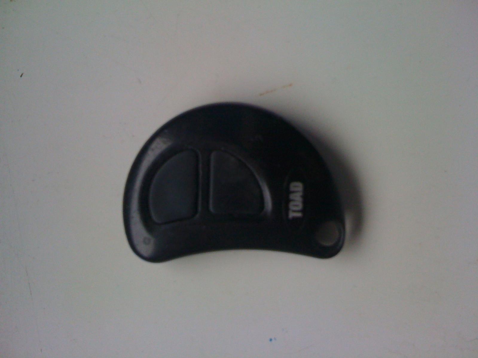

    Ok I've tried the search tab but not found what I really need, My truck has a Toad alarm which I suspect is the Sterling model going by the fob, if you have the same perhaps you could give me some info on the thing, e.g. what the second button does and any info re programming TIA.
    on most toads, the second button silences the beep when you lock and unlock. does yours normally beep?

      It's never beeped, just one flash for lock, two for unlock and the doors lock round about the same time as the glow plug chimes and unlock when you stop the engine. It does what it should I guess, just this second button thats a mystery, no joy from Toad. So now I'm off to hit the Vodka

            What an absolute star you are sir, as its dark at the moment I'll leave it before I start playing and will let you know what happens, all the basics seem to work as you describe. Thanks very much.
            And thanke to all who posted.
              Right, all it does is lock/unlock doors with indicators (no chirp), auto lock on engine start, unlock on engine stop, passive lock if unlocked and key not in ignition and immobolises if key removed but doors not locked. Second button does nowt. So I guess it does everything I need but should maybe do more, doubt it's worth spending money on, at the end of the day its an "old banger" by modern standards and at under £400 FC insurance doubt I'll save much.
