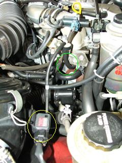

            Hello again guys. Jeep is back on the road, drives great with no over-heating and smooth gear-change...BUT....on hills no power whatsoever, turbo whistling quite happy but no power. I've noticed a filter above the throttle body with a pipe running from it but not connected anywhere and can't find where it could be connected. Could this be a problem with the turbo?...Any help would be appreciated.
              It goes to the boost sensor thats bolted to the side of the air filter housing.
              • #22
                Thanks again Vince, has it got 3 prongs, if so there are already 3 pipes on there. Must have put the pipes wrong. Would this cause no turbo power?. If so will have to work out where the other pipes go. Thanks again Vince.
                • #23
                  The pipes should be connected like this....
                  http://www.hiluxsurf.co.uk/attachmen...4&d=1294528946
                  Hope that helps.
