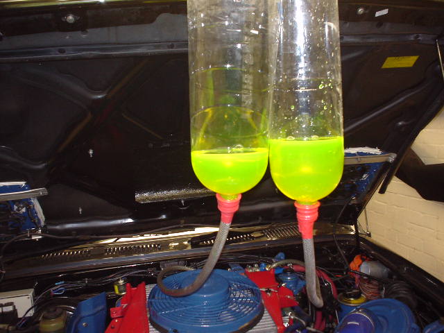

it's actually working a bit better now tho, i fitted a drain cock to the heater flow for burping the system and it took ages to warm through, i've since fitted another to the return and useing two bottles it's burping better and warming quicker, you can see the coolant dropping in the flow bottle and riseing in the return one (along with air bubbles), must have been air it it before,Too young to die and too old to give a toss
