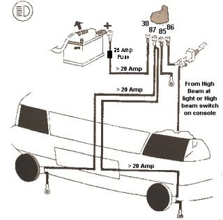

ok surf's own spotlight wiring.my surf has a bull bar and i just fitted spotlights to it using exsiting brakets conected the exsiting wiring up (surf's own wiring) nothing!!! is there a switch or where is the fuse/relay any help please...

Simple spotlight wiring diagram.........Last edited by BUSHWHACKER; 19 January 2012, 01:37.

got a new set of spots so will be fitting them tomoz hopefully and this time i will wire them via a relay and use the hi beam as a trigger wire and go via the dash switch so can isolateSurf.gone but not forgottendisco now gone aswell

The fuse/relay for the front foglights will be where ever the previous owner fitted it. As I said on the first page, spot/foglights were not fitted as standard to any 2nd gen Surf!
