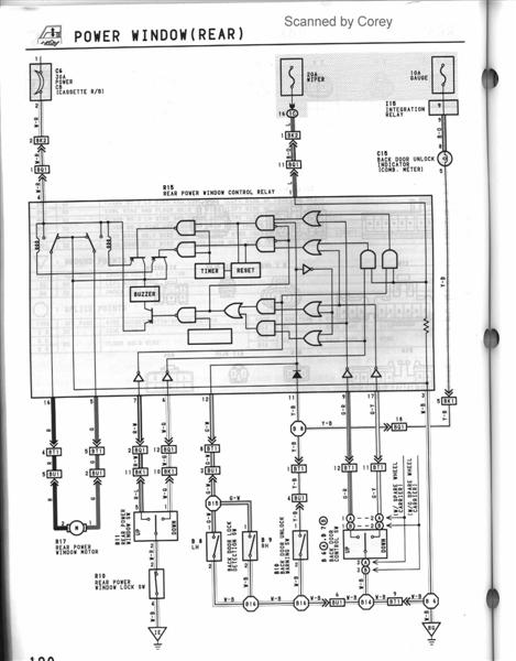

                      Well, something's wrong that's for sure.
                      Does anybody have a circuit diagram for the relay box ?
                      I do have some high level diagram, but I could really do with a detailed one.
                        Is this any good to you.
                          Hum... that's very interesting.
                          I need to study that and pull the relay box again.
                          However, a brief look at the diagram, only two relays control the window motor - I'd assumed three.
                          So, if I can hear clicking whenever I turn the rear door key, then the window should be moving.
                          So, it can only be the wires from the relay box to the motor, and I've tested them and they 'seem', famous last words, ok.

                          Which book did you get the scan from? - I wouldn't mind getting a copy of that myself.
                          Thanks for the info.
                          Joe
