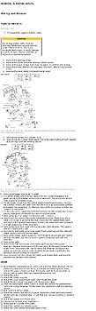

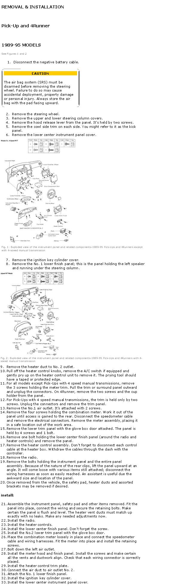

      Have a look at the attachment - it's for an 85 4runner but the info might be of help.
      Second attachment is for dashboard removal - not sure how much of the dash you will need to strip but the info might help

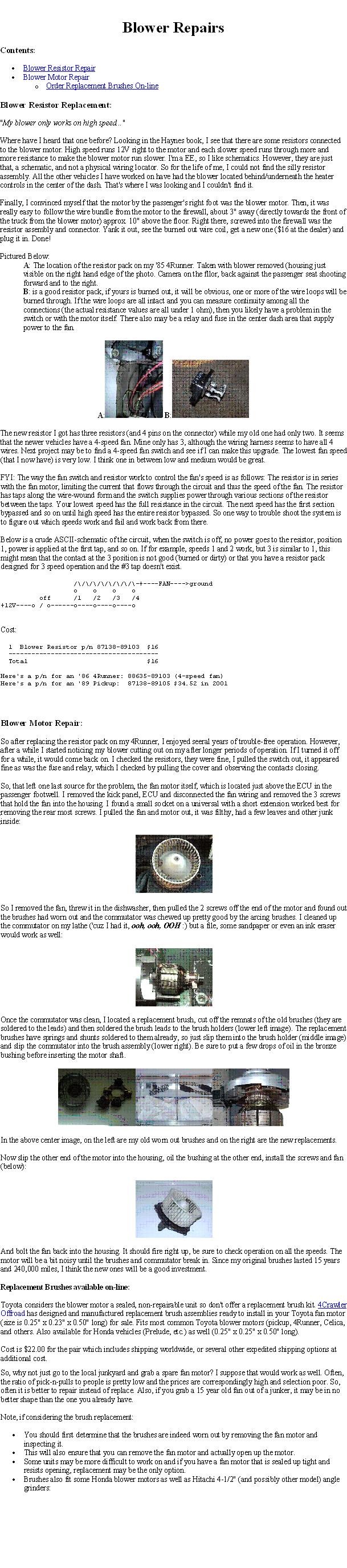

        The heater resistor is a peice of cake to fina and remove, but takes a few goes to get it back in. It is located on the cacbin side of the firewall in the passangers footwell. Kinda jammed in behind heater. This is the thread i used to help find mine. http://www.yotasurf.co.uk/forums/sho...eater+resistor
        Have fun hope you find it
          Lol
          just had another look at the site listed in the above link. I new i had seen the info somewhere before, and here it was all along. Right in front of me.Just a case of now pulling the motor out and in with the new brushes.Thanks for the help guys. Thanks silver surfer for the diagrams
