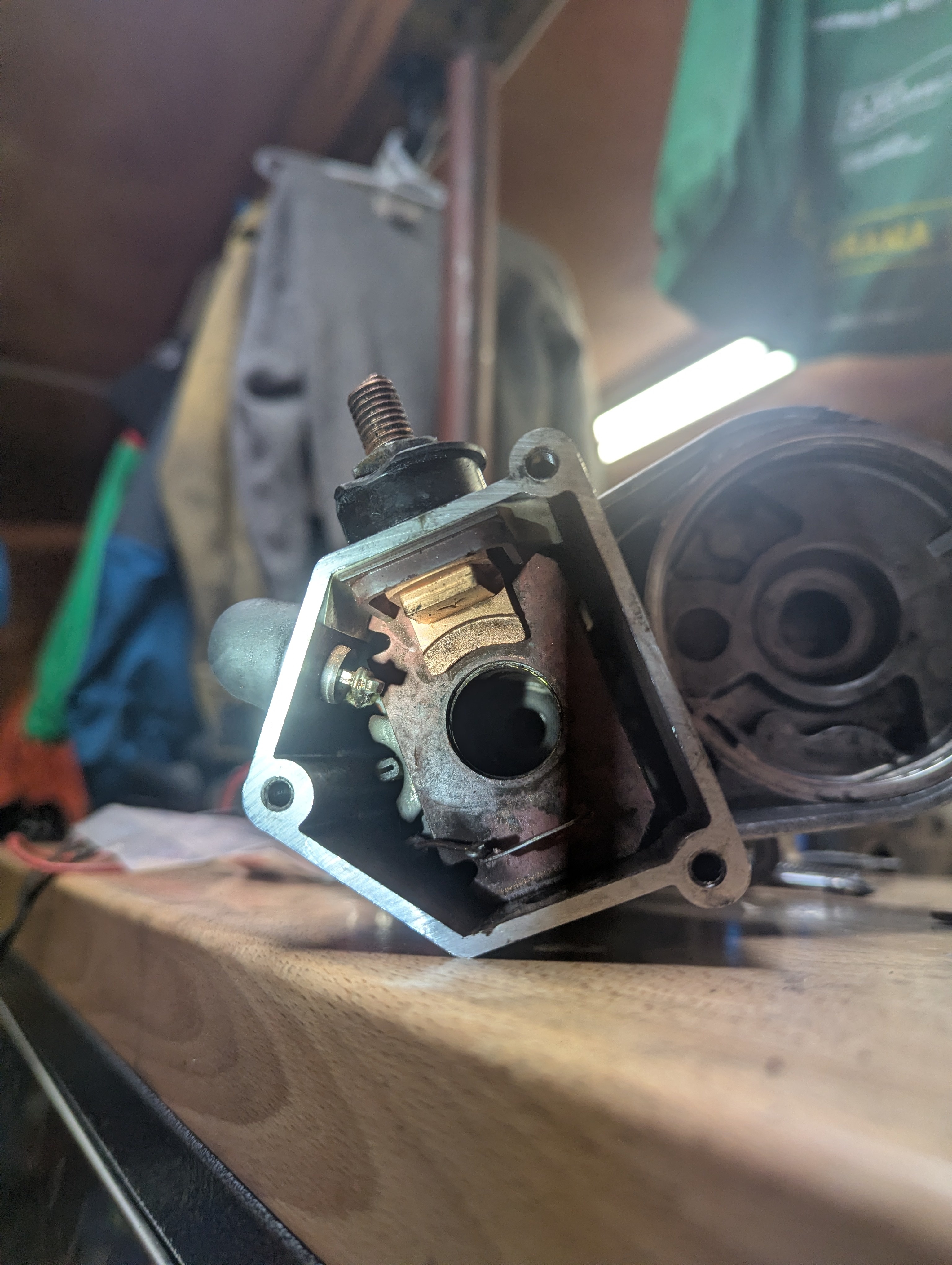

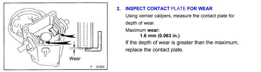

    Starter solenoid was giving me a singular "click" but no turning over. I removed the starter to check the terminals. Power side terminal was worn down a bit but still within spec at 1.90mm thickness. So I filed the other side down and put it back together.

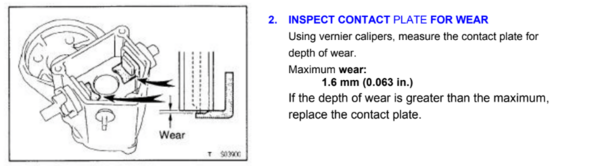

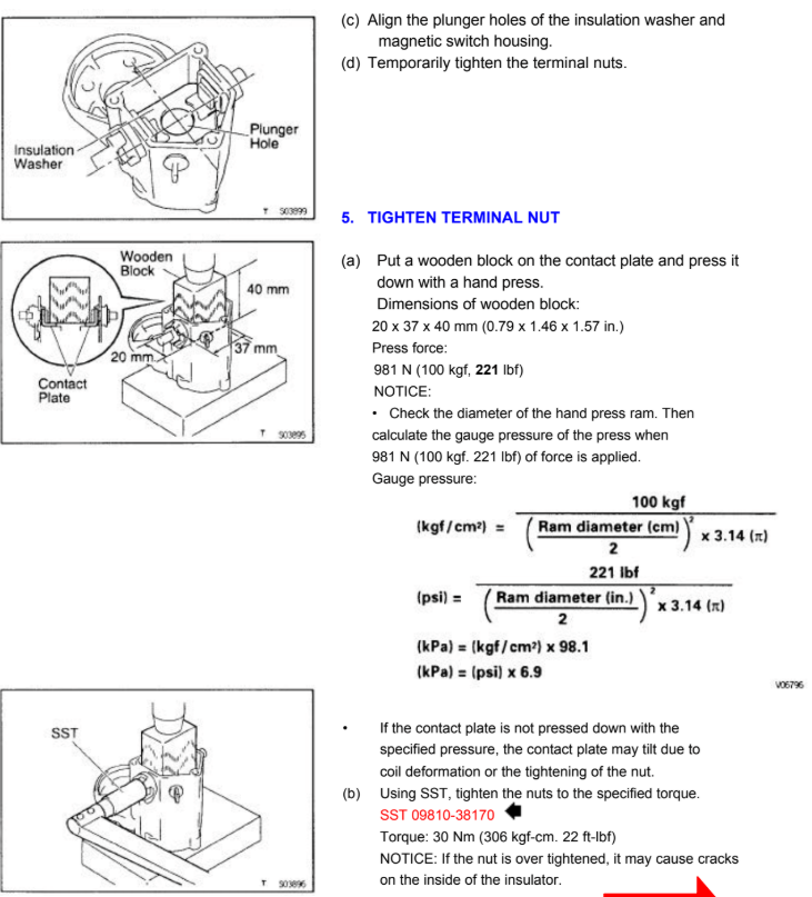

    What do you guys think? Could it be the plunger? From the repair manual I have, I just saw that it says to use a press to push the terminals down before you tighten them, see below. Has anyone changed/filed these terminals before and did you use a press!?? What's that all about?

    I ordered the plunger, new terminals both sides, and the spring. Saw online that the contact of the plunger to the terminals needs to be near simultaneous and that any pitting from arc can cause it to be intermittent. I recall the copper washer on the plunger being a little pitted.

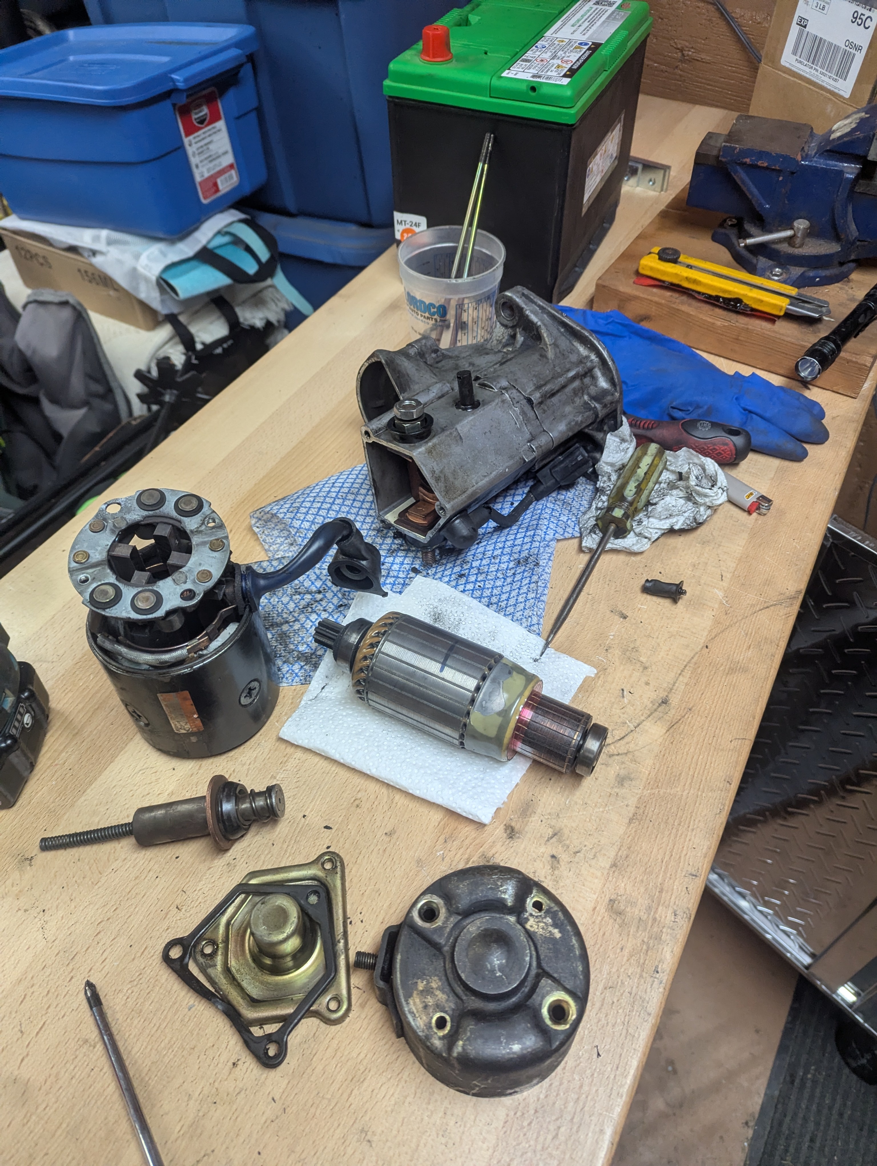

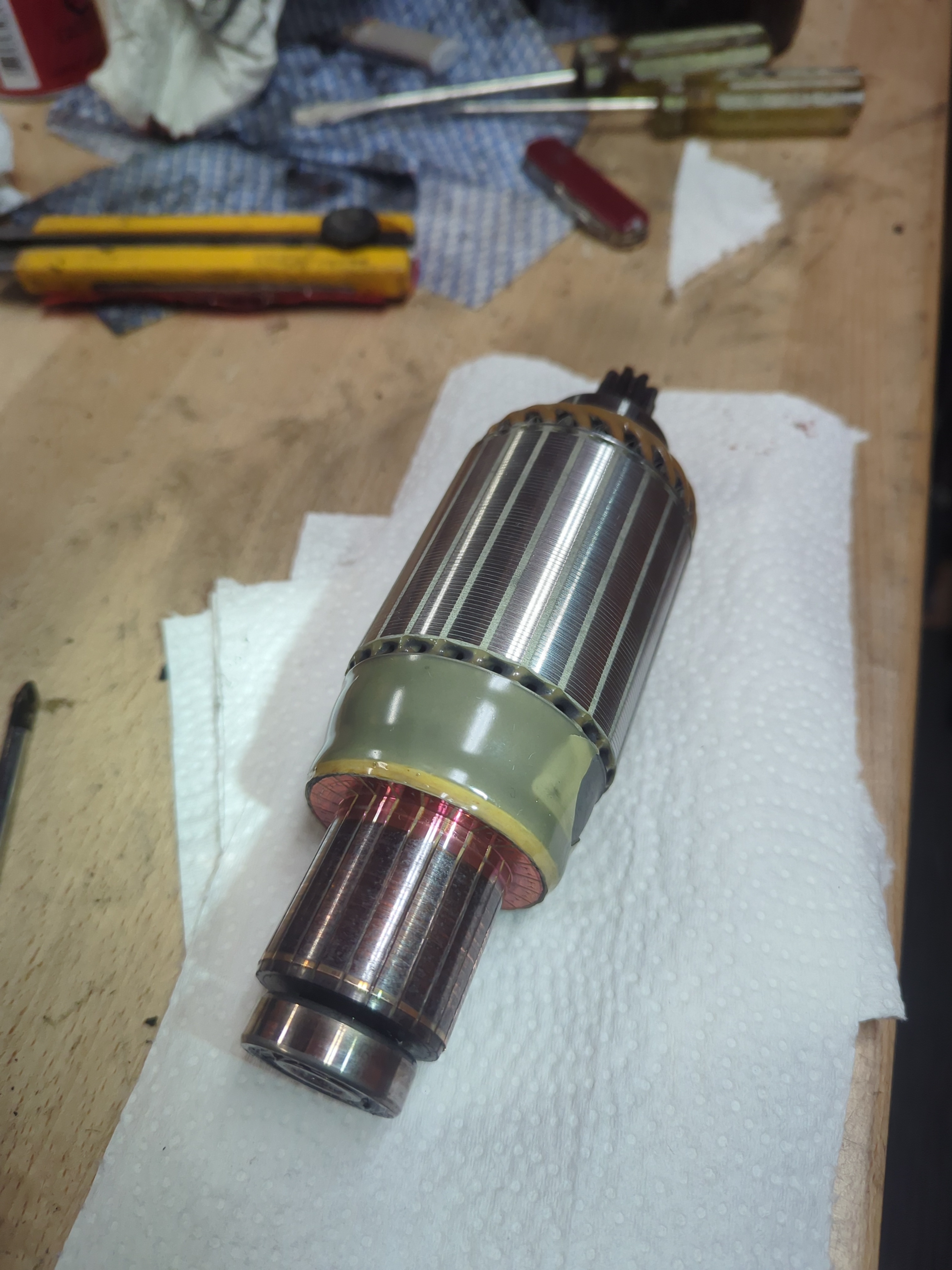

      Well I'll reply to myself in case anyone can use it down the road. The repair manual I am using is the best I've ever come across. Runs you through how to trouble shoot each component of the starter. My armature and brushes are good. I installed new plunger and terminals, ball bearing and spring ta boot. Shout out the John at RADD CRUISERS in Kamloops. I had to CLEAN the crap out of the internals (and external). That pesky oil leak up around the throttle body somewhere has been leaking down onto the starter for years I'm assuming.
      I greases the bearings of the armature as per the manual and cleaned up the commutator with a sharp little pen knife. Break cleaned a ton, next to heater to dry out and REASSEMBLE.
      So far I've only tested it on the bench but it worked every time. Here's to hoping this will be the last time I have to remove/reinstall it. A bit about that if anyone wants to know:

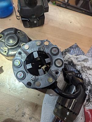

      You can see in the one pic, the power side terminal is worn down considerably. Still within spec as per the repair manual, but not ideal and not level with the other one.
      Other pic is armature.

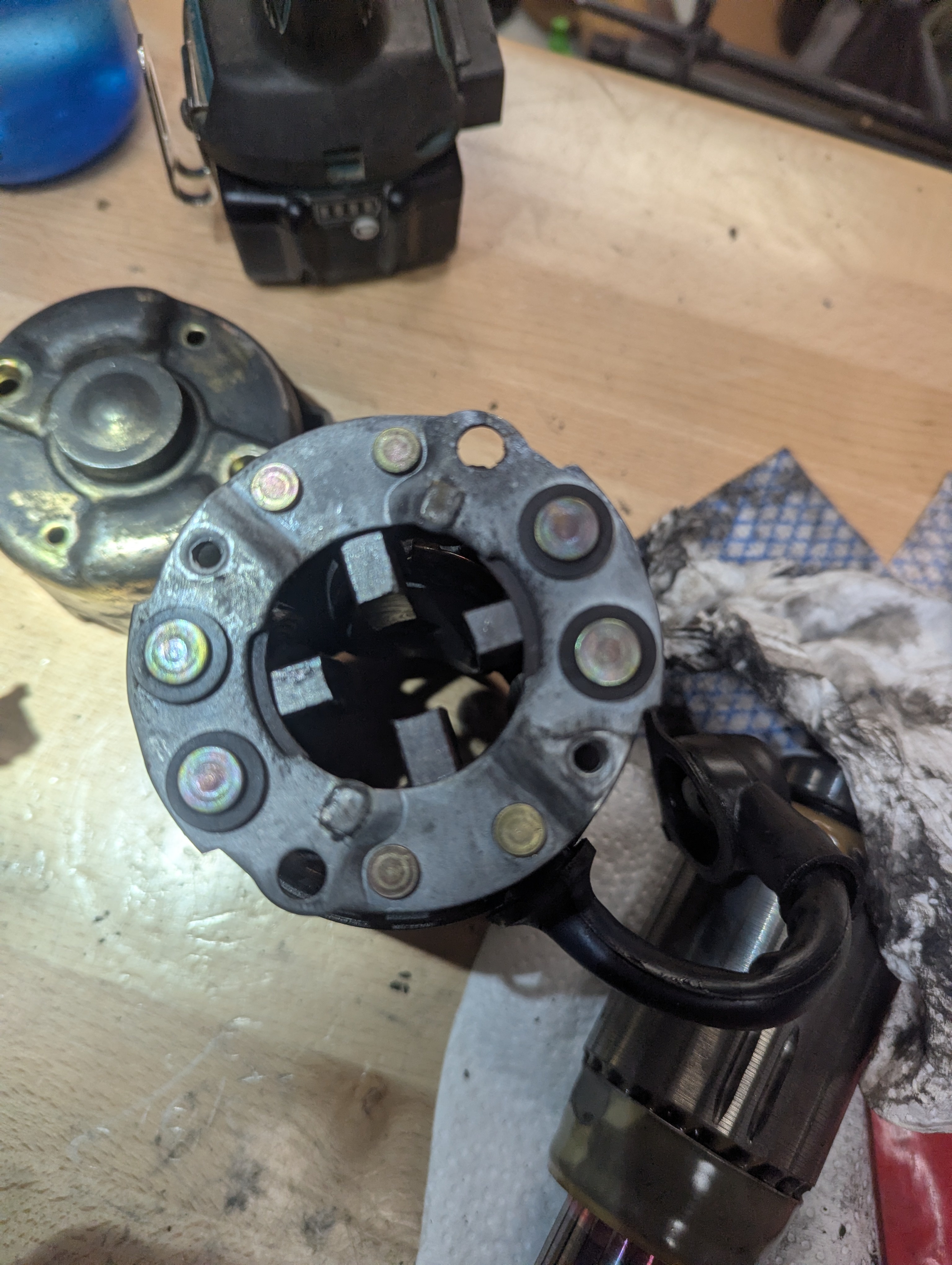

      Then brushes, lots of life left
      and then all the bits together
