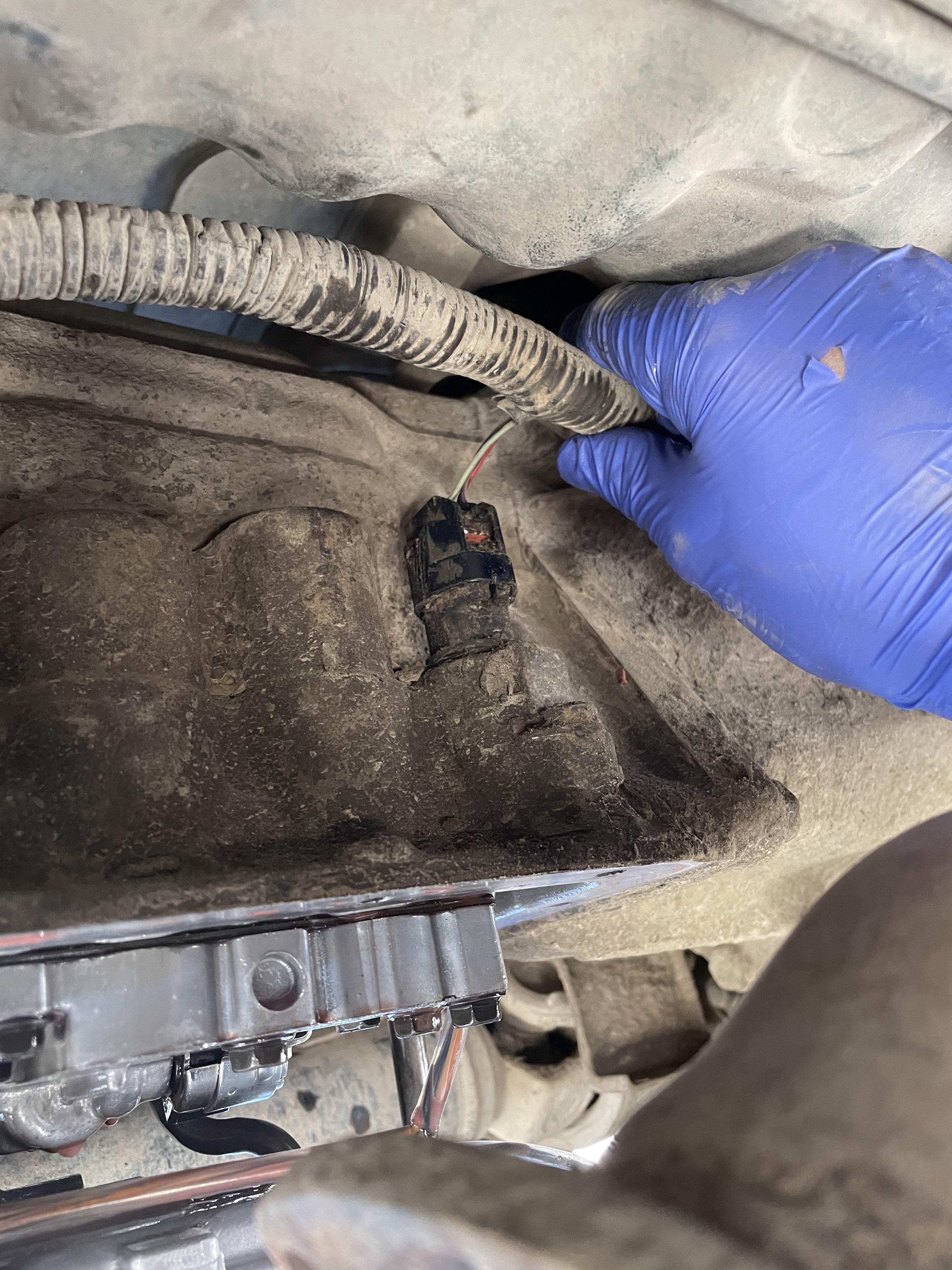

      I did manage to fix it, however. Turns out all images of the shift solenoid wires I had found online were incorrect and were leading me astray. The photo attached is of the wires outside the transmission and plug for the shift solenoids inside the transmission (I ended up cutting the exhaust out to get access to the transmission pan).
      My issue was that a pin in the male side of the plug had broken off into the female side. After I replaced both sides of the plug from a wrecked truck, my truck is now shifting gears smoothly and properly. Very happy
