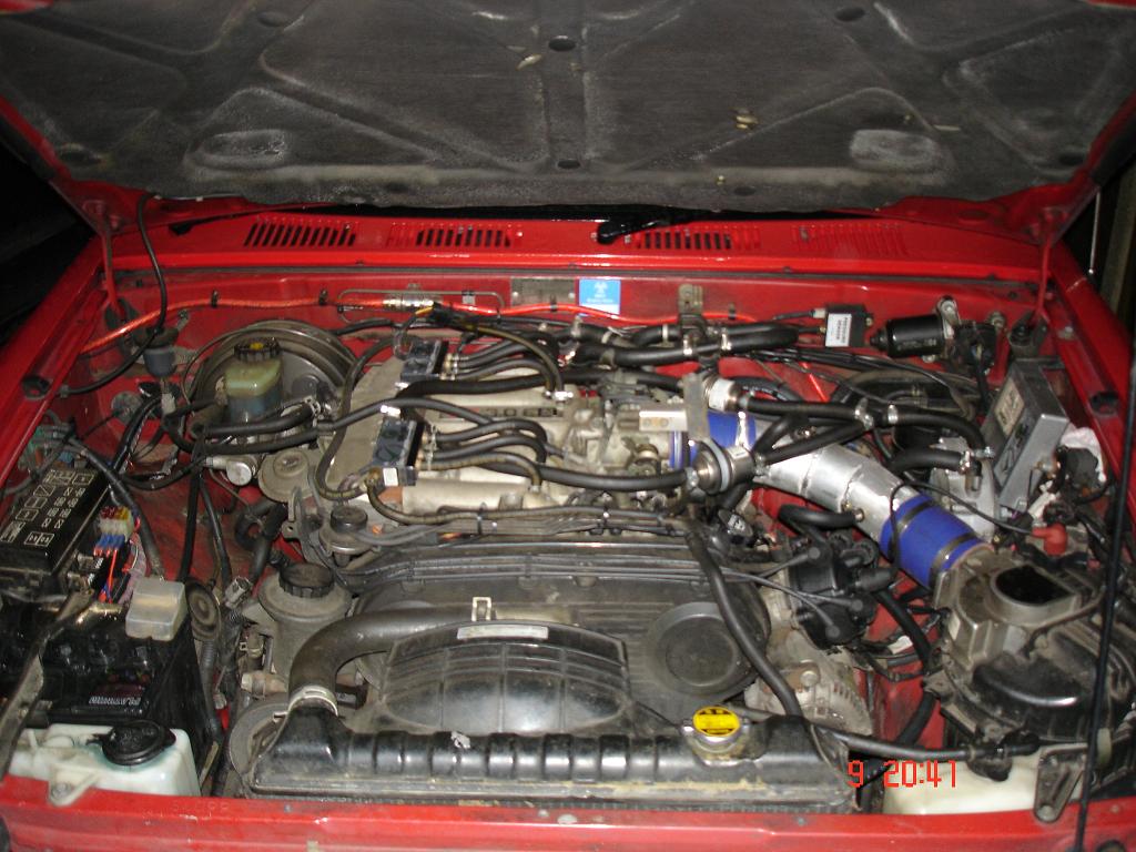

            The downer is that there is less room on the V6 as the air intake is right where he has put the battery
            I have attached a pic of the current bonnet/engine look/cram
