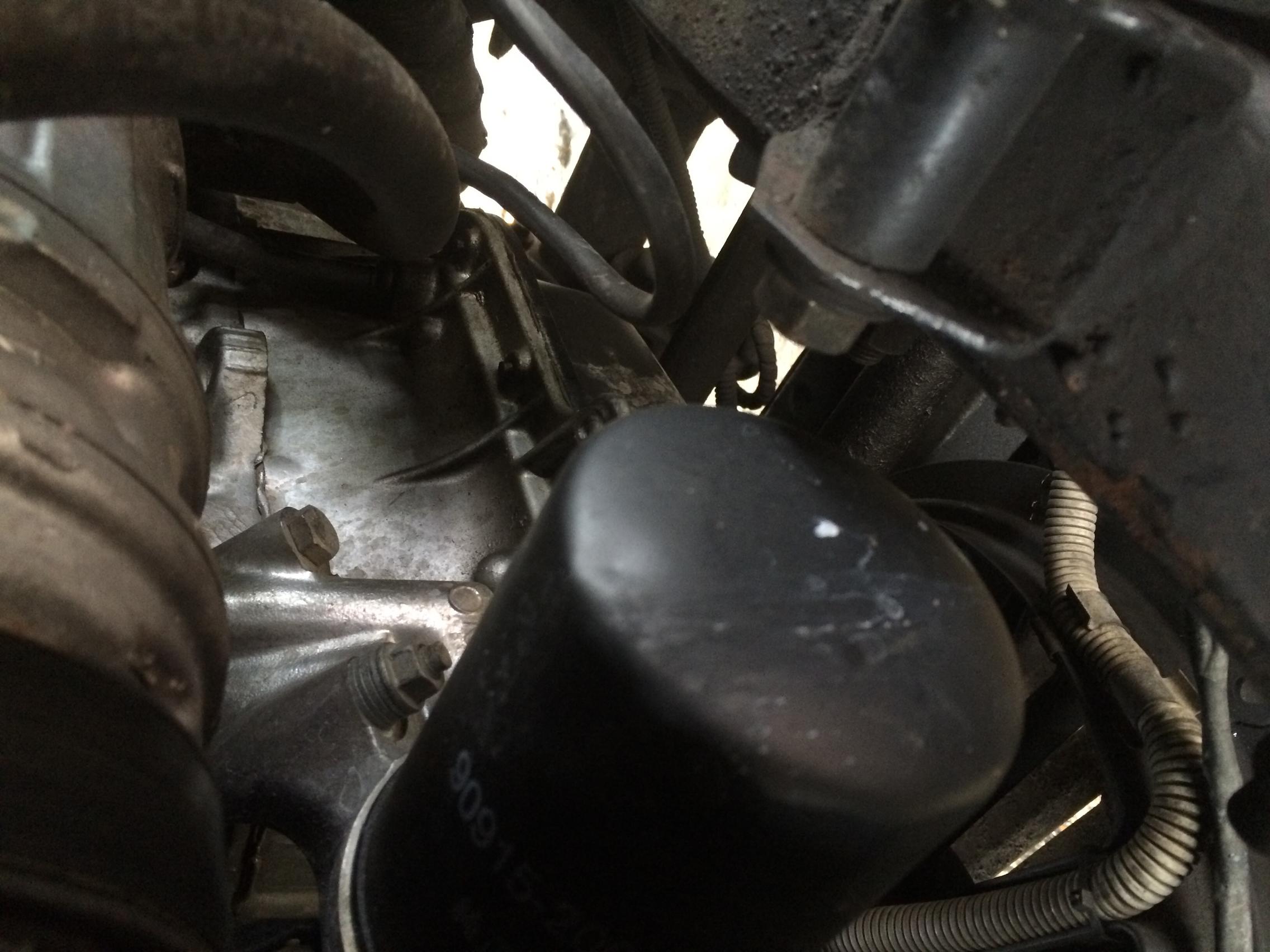

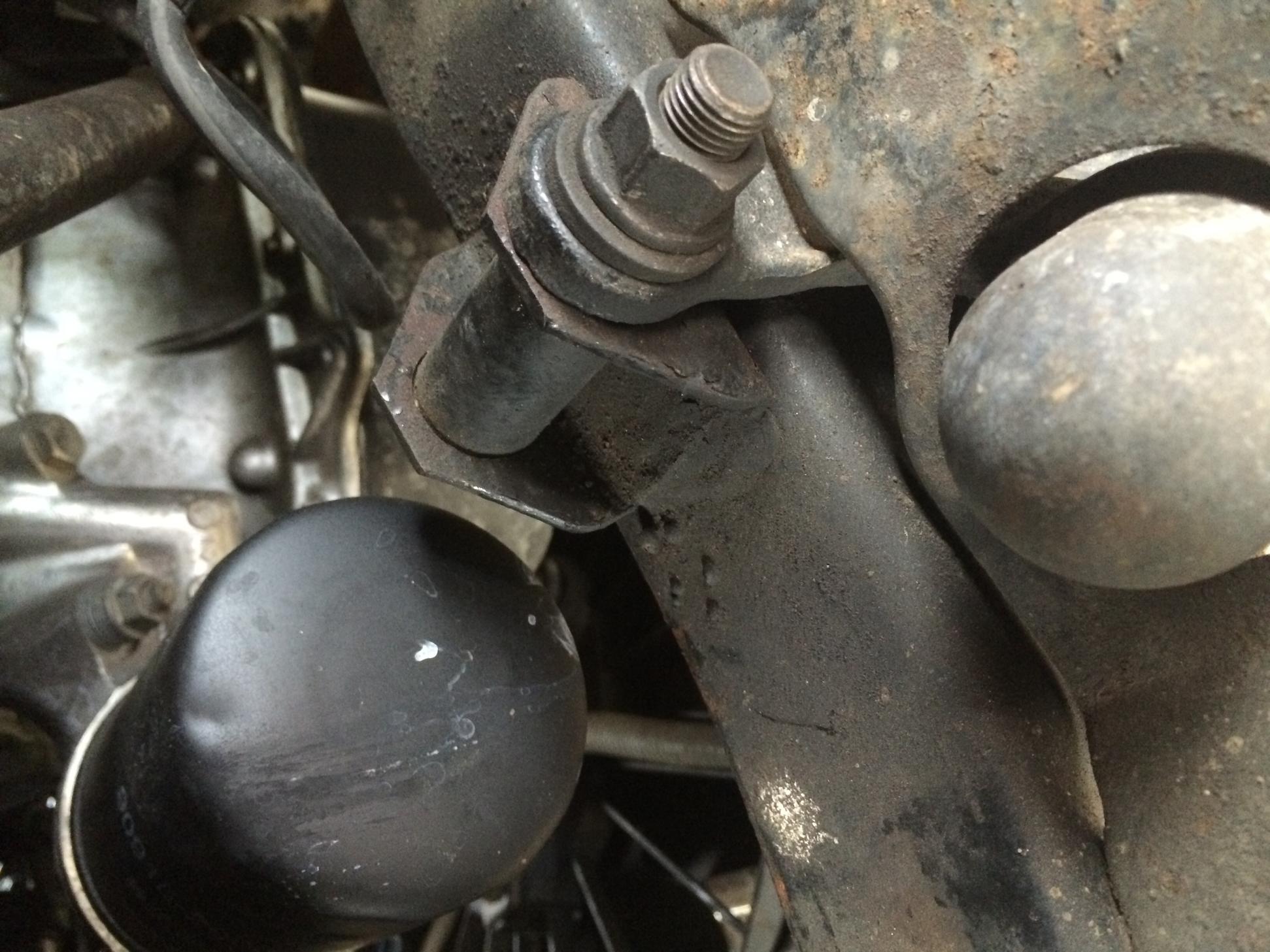

Also while your at it, u might want to turn the bolt around that holds the top of the steering idler. You will see in the photos that it is very close and the end of the bolt makes contact with the oil filter which happened to me, luckily it only dented the filter and not pierce it! Could of been a lot worse.
Yep soarer mount
Yours maybe a little different when you do the mounts but not by a lot.
Easy enough to do with the engine in too but u gotta take off filter first.
